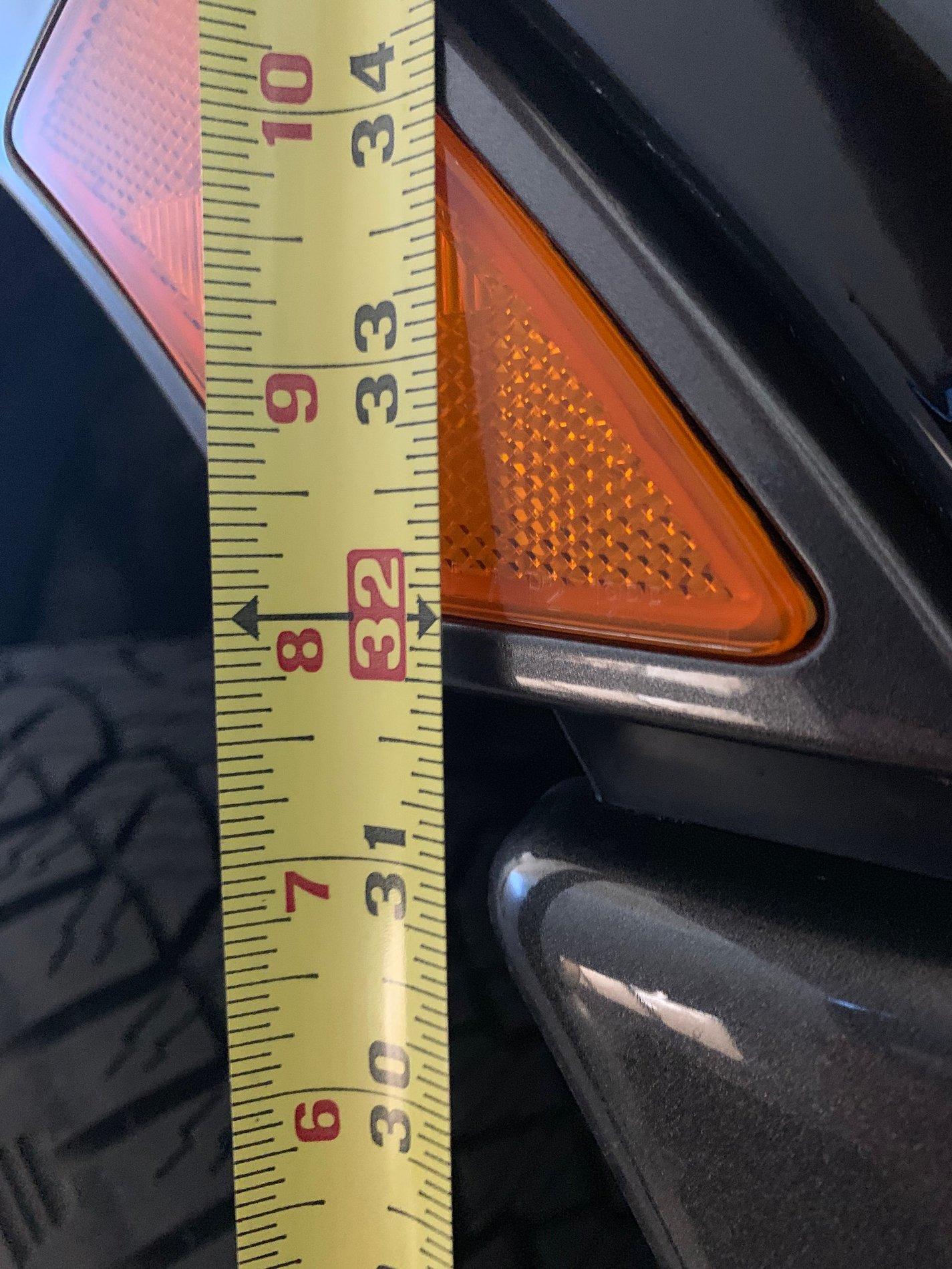

Some updates on this case... Ford denied my buyback request..
So, I'm taking the truck to another ford dealership. Already took it to this dealer and they said the "won't fix it" its "within spec". A little pressure from Ford Customer Care and this time they are going to take it to their body shop and measure the frame...

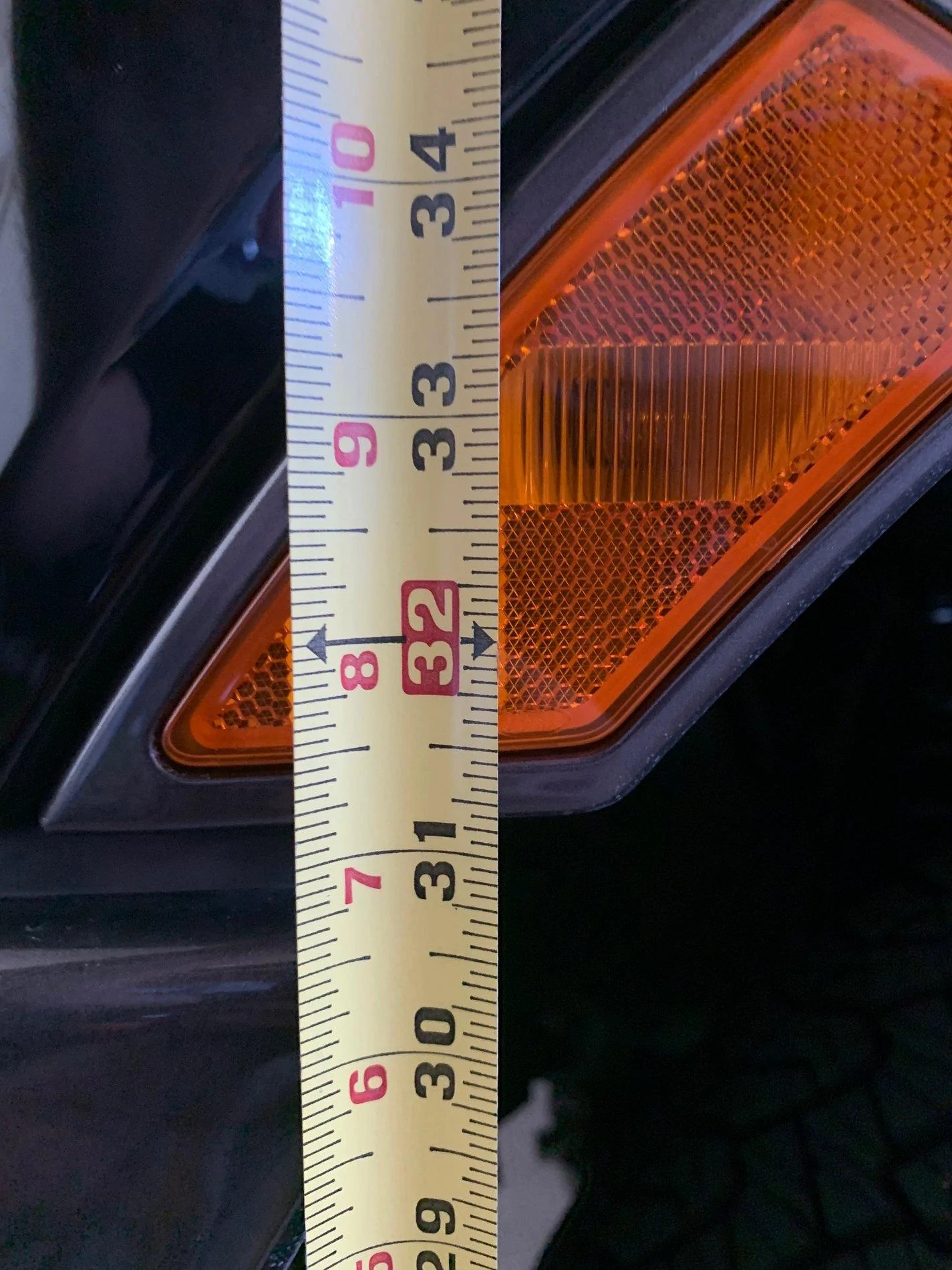

pretty easy to measure from the ground to the reflectors...
You can clearly see its 1/2 inch different.. Dealership consistently states its "within spec" -
REALLY??? where is the spec that says it's OK to sit 1/2 crooked on one side?

12 mm is .47 inches according to google. So just about a half inch. If that is true, then it does appear to basically be within spec.

Well, I'm clearly not happy with the "Spec" - I measured a few other Rangers, they were 1/8 different. I'd be happy with that..
Mine is just so visually noticeable, it pisses me off... maybe its me, ADD, ADHD, whatever, but it's not cool..

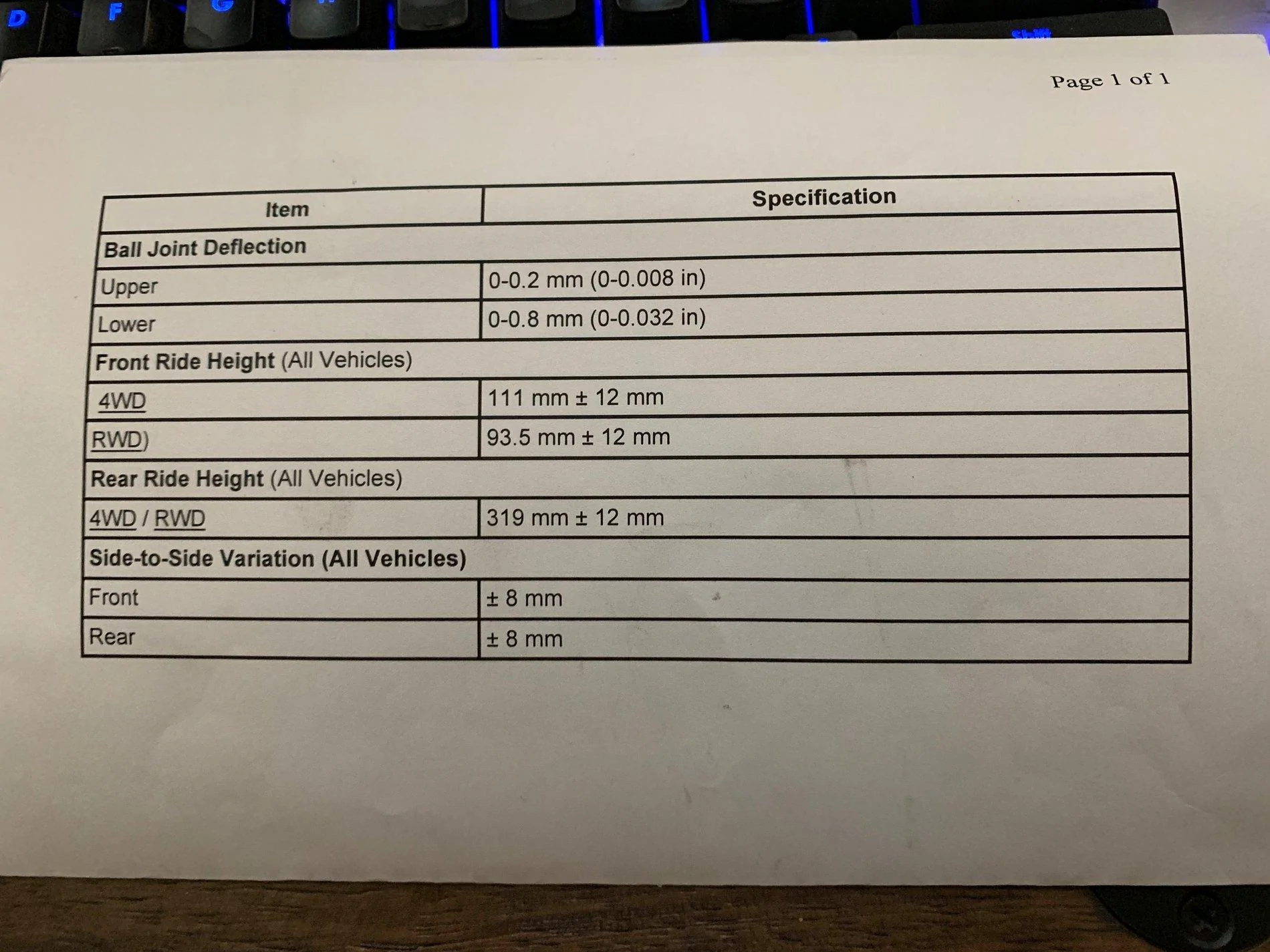

Right? But the dealership doesn’t measure to the ground. They measure something to something and said it’s ok
..... Sounds like measuring the air space between their ears.
Time for a new and more honest dealer.
They wouldn't get another nickle from me.

clearly out of the 8mm spec.

The dealer is not measuring "something to something" and should make it clear to you where they are measuring.
Doesn't the specification you posted a picture of make it clear? The reflector likely has a build up of tolerances so that is a poor choice, measure from level ground to the frame.
