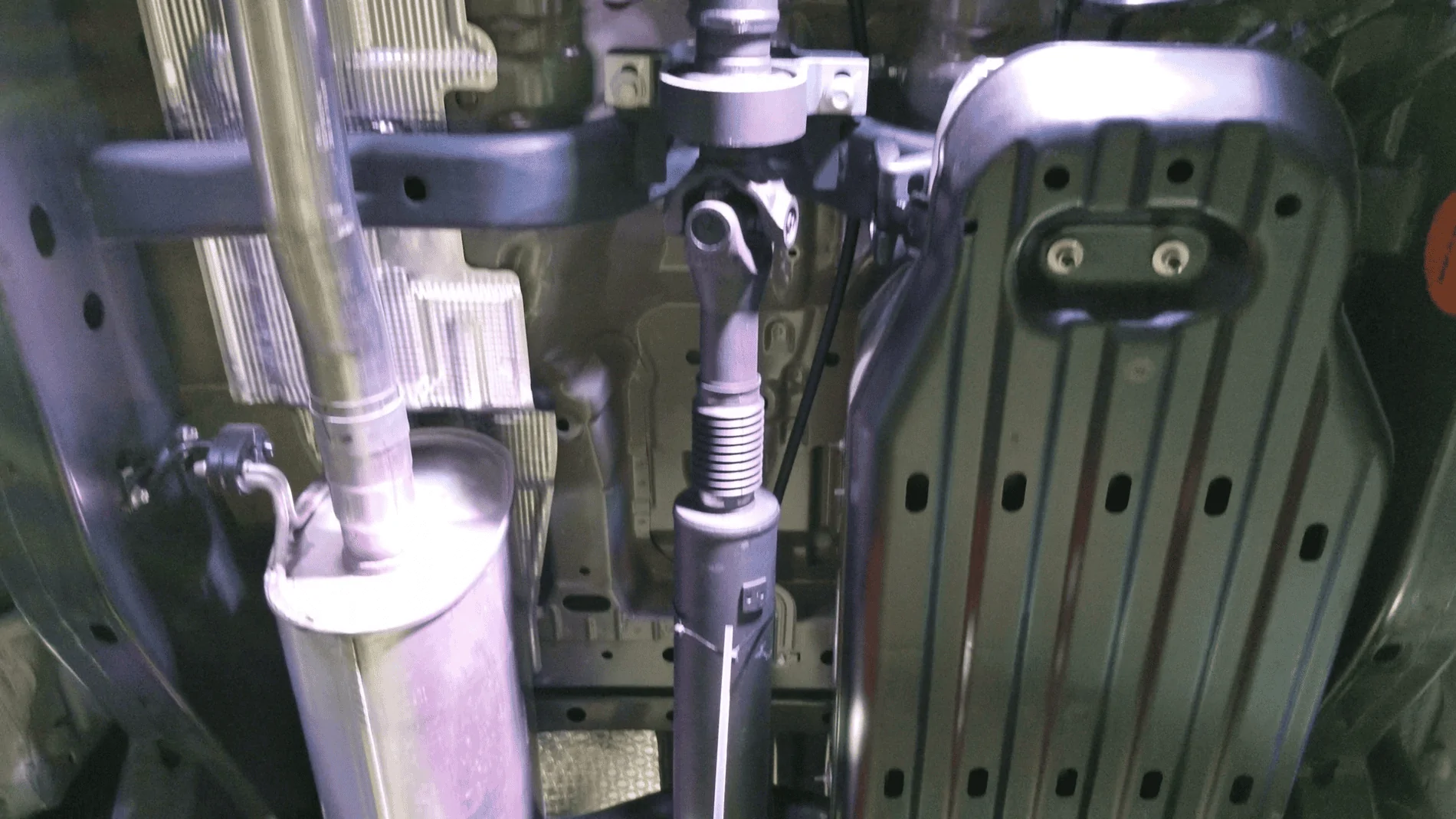

This looks pretty much on the driver side to me.

Its not really, the fill nozzle is, but the tank goes across the back..
I thought so..anyway , it will be interesting to find out what the problem really is.

Josh just showed a photo., I assume that’s the tank.
Yep the black skid plate on the right (driver side) is the fuel tank.

So my question would be is ~113.4 pound (~18 gallons x ~6.3 pounds(~weight of 1 gallon of gas)) near the center, but on the left side enough to drop the front left side of the truck 1/2". Doesn't seem likely. That's even a worst case measurement.
My JK had the "JK lean" and was told it was the gas, but it leaned regardless.
The easy way to find out if it is fuel is to run the tank down to near empty and take a measurement.
