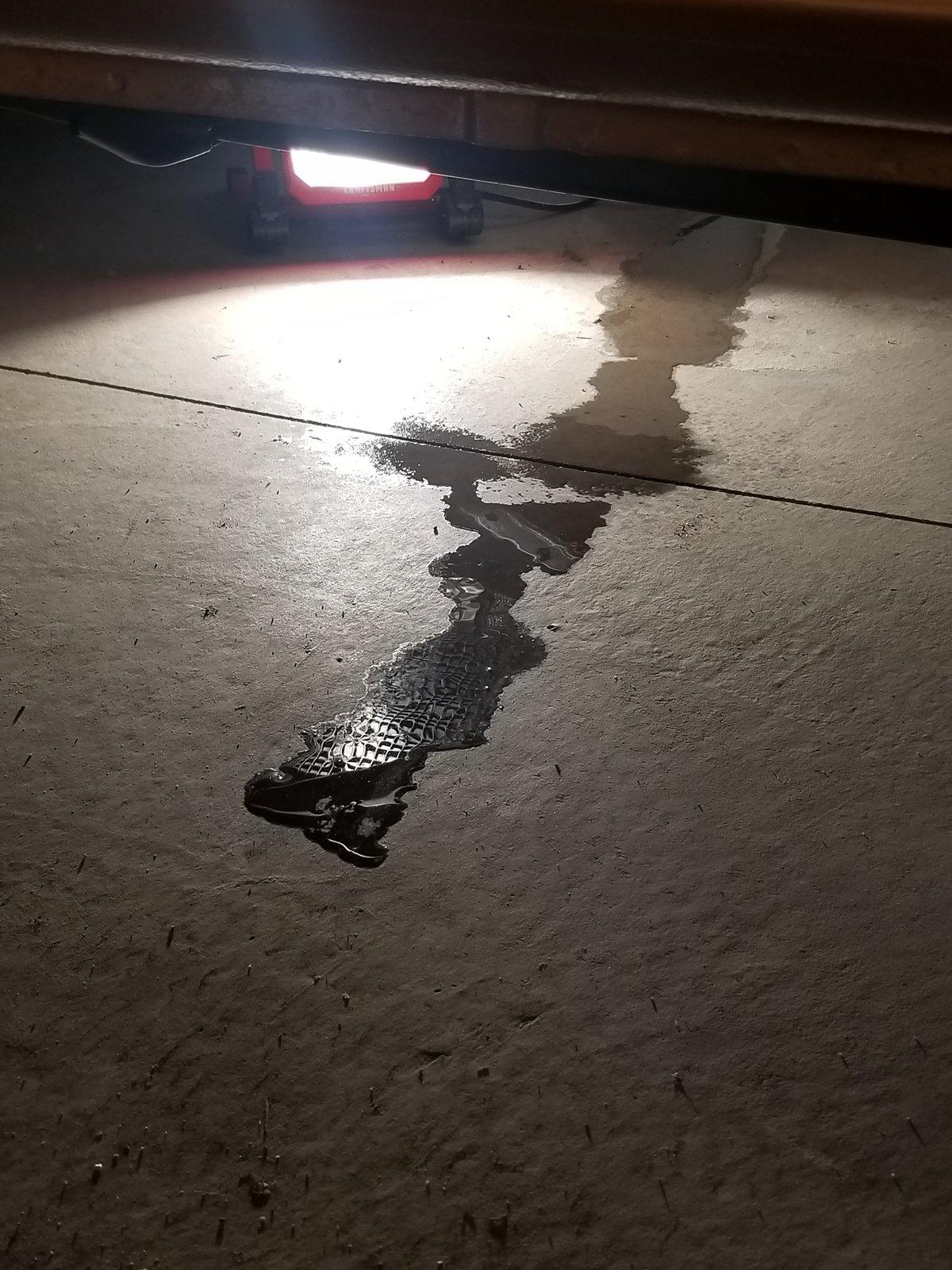

It's definitely coolant. The mechanic didn't hear back today from FMC, but hopes to hear first thing in the morning (we're two hours behind). He didn't tear into it without FMC approval so there's a lot we don't know.
One thing he did tell me is there actually is a small dipstick on the top of the tranny next to the exhaust. He was saying how hard it is for them to check; especially when the motor is hot, which is when they're supposed to check it.
I can't find schematics anywhere on that tranny. Does anybody have any idea what that hole is for? Is it a weeping hole for coolant that is supposed to run in the tranny casing possibly? If so, maybe there isn't coolant in the tranny itself. :please:

Did I win the distinguished award for the first Ranger to have mechanical problems? I walked out into the garage this afternoon and she's leaking transmission fluid. 53 miles.
Oh man that sucks, but congrats on being the first ‍♂♂

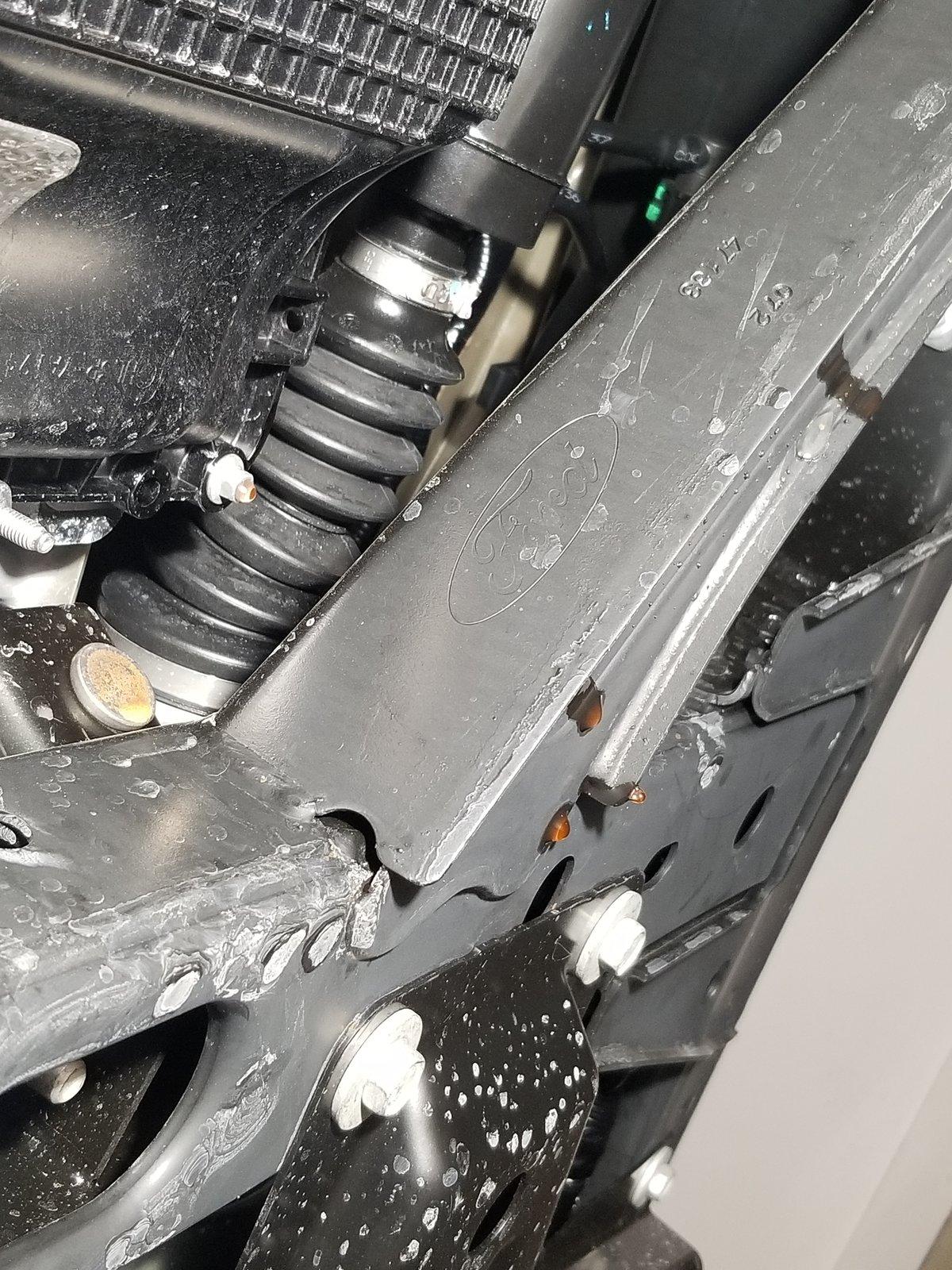

It looks like coolant to me. My bet is its leaking from the turbo and running down the top of the bell housing.

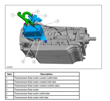

My bet is transmission cooler coolant leak. There is a heat exchanger mounted on the drivers side of the tranny that circulates coolant to cool the transmission fluid. If it has an internal failure this would be the result.
That's my bet too

Just curious, for the last 60+ years transmission coolers have been inside the radiator and trans fluid was circulated through them to cool the fluid at the radiator. Do they now actually circulate antifreeze back to the radiator? Seems a LOT less efficient.
I thought it had to be a bad coolant line in the radiator, basically the same as your conclusion, but the approach you describe is new to me.
I'm with you, but here is the part for reference.
