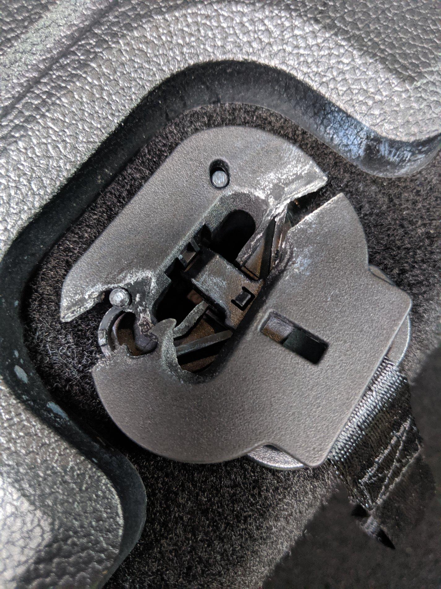

the discoloration could be the result of some kind of impurity in the plastic, maybe a few bad pieces in a batch
This white discoloration on the latch cover and the adjacent trim is consistent with exposure to cyanoacrylate, the active compound in Super Glue. You will see this happen when attempting to glue ABS plastics. You need a special glue to bond ABS and Superglue isn't one of them.

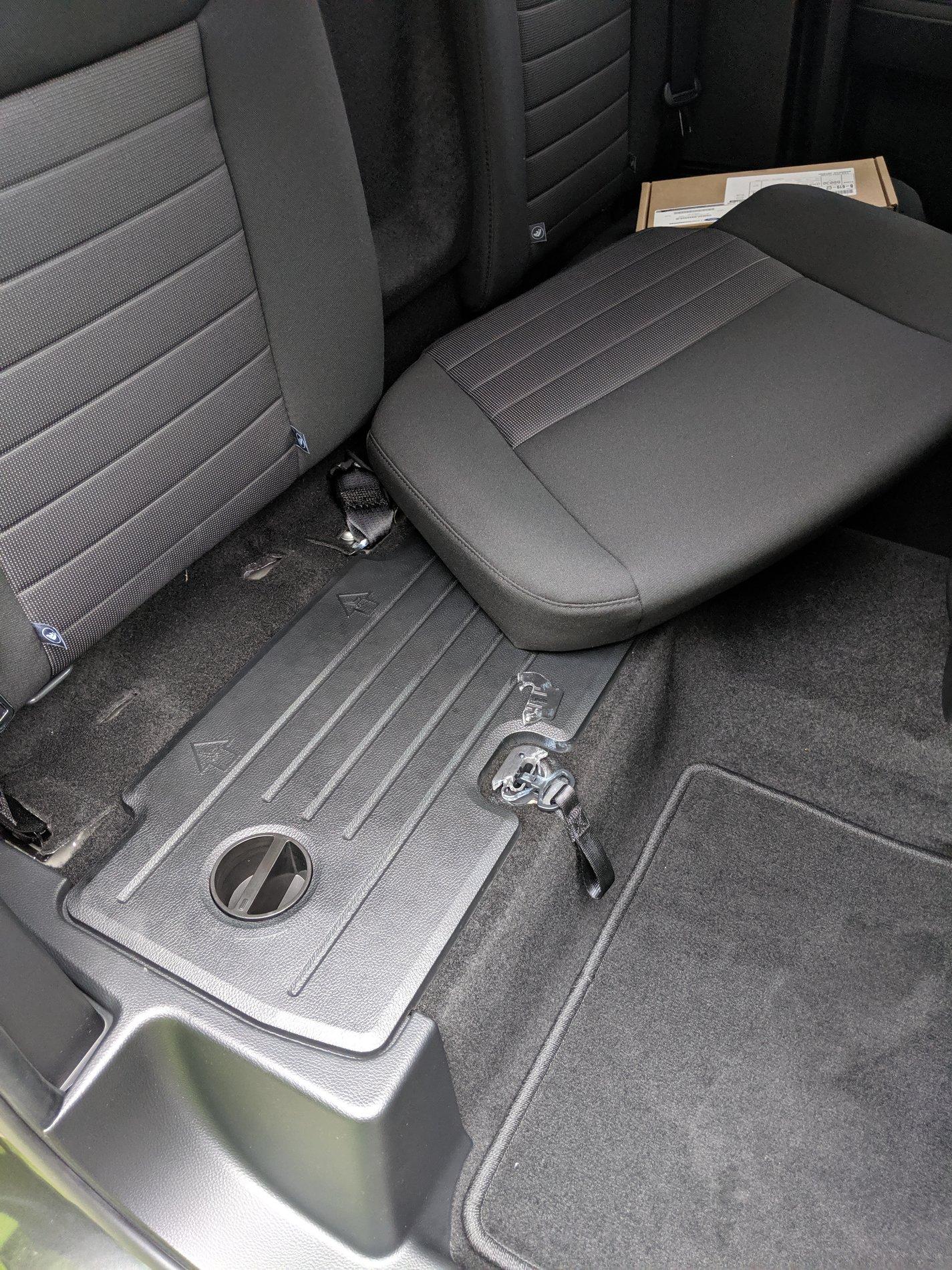

Brought my new truck home yesterday and was just checking out the rear jack storage location which required the removal of the rear jump seat base.

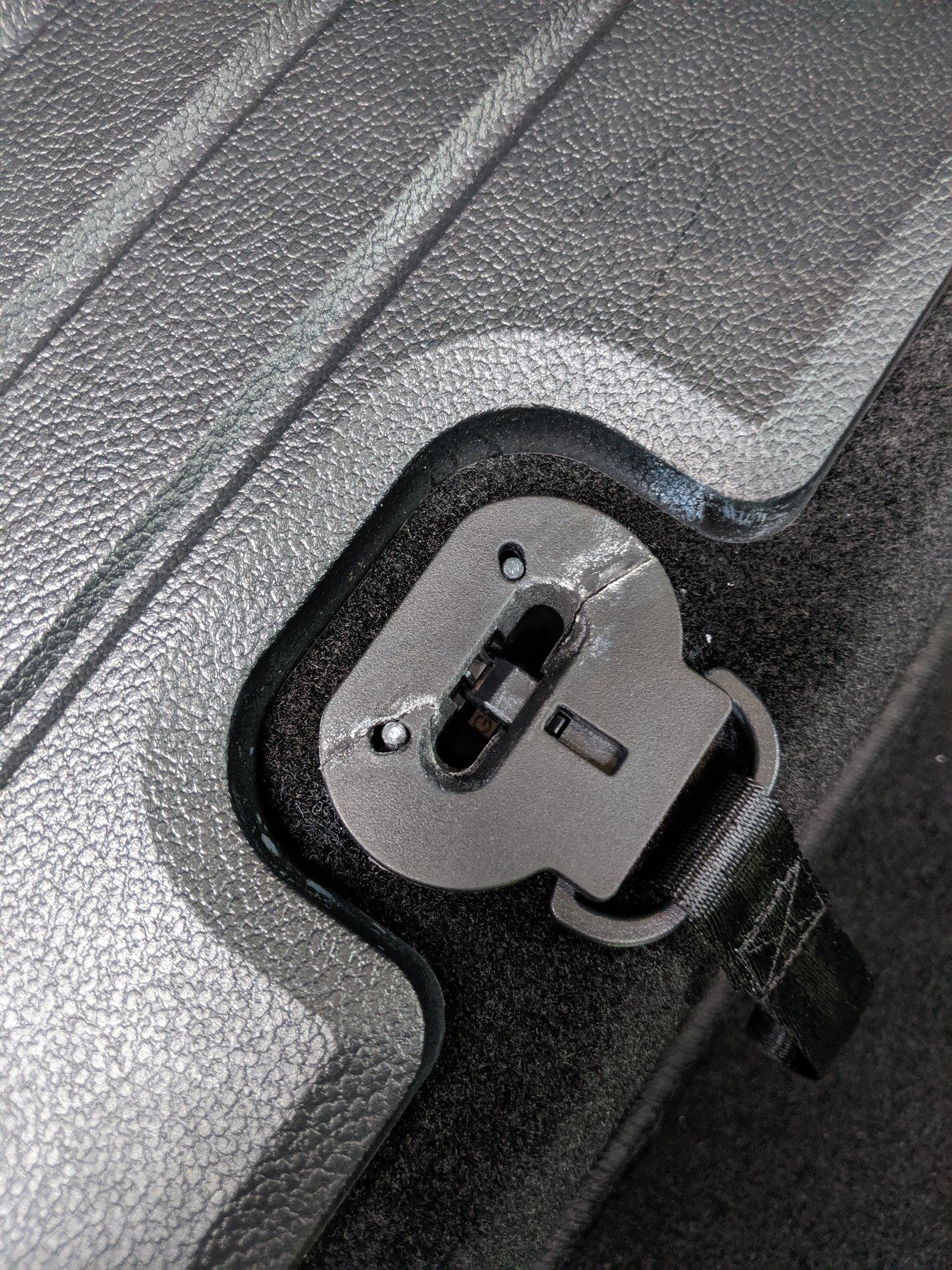

When I went to pull the tether to release seat base the plastic housing literally grenaded into two pieces. Upon inspection it looked like the plastic was corroded ??
Took some photos of the issue and shot it to dealer who had no problem ordering replacement part.
I feel like these latches maybe prone to breaking a few more times though...don't seem very robust.
On a side note when the new part comes I'm wondering exactly how I get that latch assembly out of the floor!
