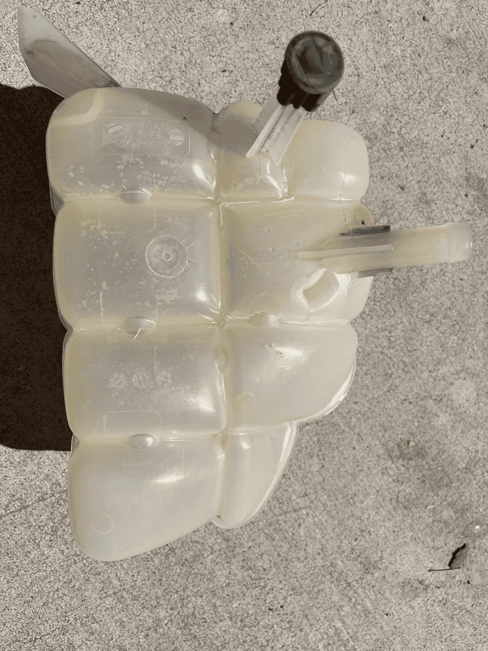

Wanted to report an issue I solved on my truck, 2019 with 75k miles. Since about halfway through my ownership I've noted that between oil changes, my coolant level would drop from maximum to minimum. Well last weekend I developed an actual leak (left a small puddle on the ground after parking).

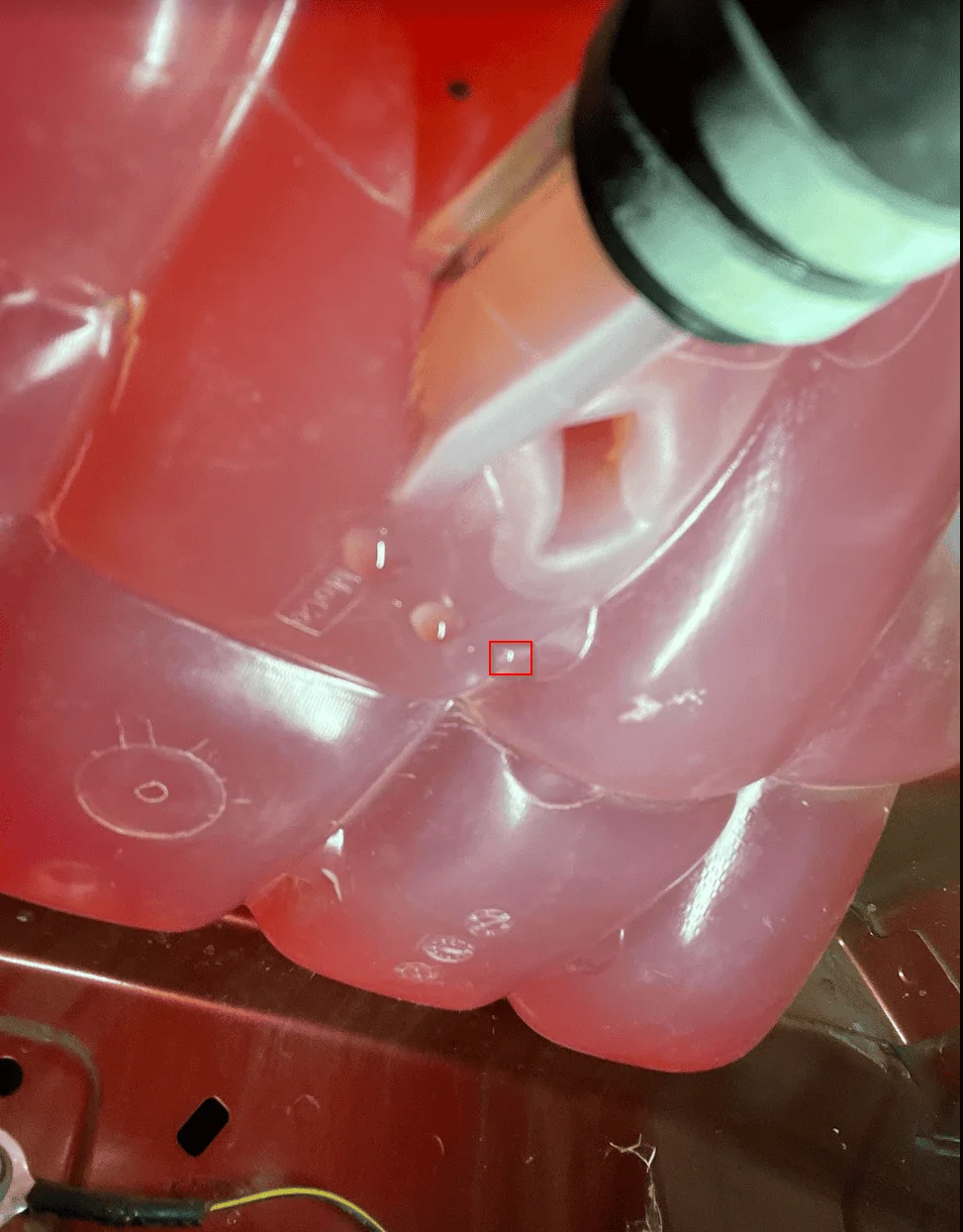

Investigation found that there was a small crack on the bottom of the tank that only opens up when the truck is at operating temperature (doesn't leak when cold). After swapping in a new tank, I noted that there seems to be a lot of stress cracking on the bottom of the tank.
Side notes / rants I discovered while doing the job:
1 - replaced the radiator cap, there is a newer revision. The old one was very stiff to get on, this one is much smoother (not sure if age or better design).

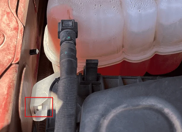

2 - The tank is only mounted with two bolts on the fender side, and a "pegleg" on the other side to hold it up. This makes it prone to a lot of vibrational stress as the tank bounces up and down on the leg. Horrible design effort by ford. Might consider strapping it down to reduce stress?
3 - The rectangular hole on the bottom of the tank is actually the overflow for the pressurized cap. So if you have coolant on the bottom of the tank, it could also be the cap is bad or high temperatures pushing the cap open. Another lazy design by ford not including an overflow hose.
4 - This bolt was a PITA to get to, probably easier to remove the airbox next time. Again a large miss by ford on serviceability, no reason the bolt couldn't have been 1 inch closer to the tank.
