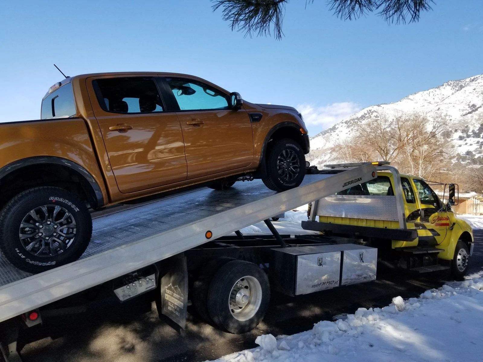

My father-in-law is a diesel mechanic (18-wheelers) and had the same thought as you. Definitely coolant. It seems the transmission is full of coolant and it's coming out of the gasket.
I tightened the pan slightly and that slowed it down, my thought is the thinner viscosity of the coolant got past the gasket where ATF wasn't.
Tow truck is on its way to my house. My question is, "With that few miles, how much damage was done to the transmission? Does it need to be replaced?"
I don't want problems in 30,000 miles because of this.

I too am a retired fleet mechanic. I would also be worried about transmission oil in the engine coolant.
You will just have to wait til they pull the tranny pan and drain and check the radiatorl.
If the leak simply pressured a little coolant into the tranny after it was parked and you DON"T drive it...
Only Ford engineers will know how coolant will effect the clutch materials or whether it can be cleaned.
Whatever they decide to do, make sure they explain it to you and someone you trust.
My heart sank in sympathy for you when I saw this, but you may be alright... keep us posted.

I wonder if you could get Ford to warrant the tranny for 100K due to this problem, just for your protection and peace of mind. If you don't ask, it'll never be offered....

@uthunter did you get an estimate of when it will be available? I assume you got a free rental car and the VIP treatment.
I met with the service manager and the mechanic this morning while they had it on the lift to discuss what I was seeing over the weekend and show them the pics of the fluid loss, etc... They have submitted a request to FMC and then have to wait 2 hours to talk to the engineers. The Regional Rep has been notified as well. Their plan is to pressurize things and see if they can get more leakage and then drop the pan and go from there. If there is coolant in the transmission, it is a total rebuild (I told them I don't want a rebuild and that I want a brand new transmission).
The dealer has committed that they'll unwind the deal if I'm not happy with the response from FMC so we'll wait and see what happens. The only hang-up is that I can't just get another one on a dealer-trade and would wait months if I start over. I'm going to wait and see what they say before I get too wound up about it.
