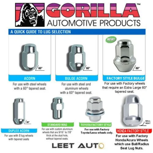

I found this on eBay showing different style lug seats. I searched an didn't see any of the "factory style bulge" just the acorn bulge.
I can’t find any 12x1.5 “factory style bulge” from Gorilla for sale tho. Their website sucks on my iPhone and is impossible to navigate as well.
I agree. I can't believe it is this difficult to find OEM "like" black lug nuts for the Ranger.
