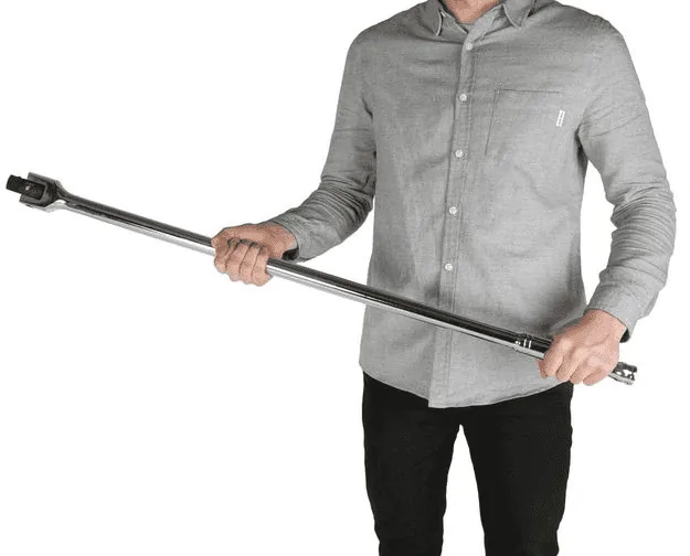

You think we have short memories, David, I remember you bought a breaker bar that would make Wilt Chamberlain blush. ?
But I did fall short. Mine's only 30 inches. I later saw a 38 inch one from Harbor Freight (LOL, would have to open both Supercab doors to pull that one out!).

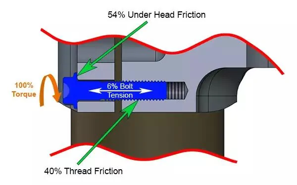

I've learned so much from the engineer/founder at Luxon about bolt torque. I now use specific anti-sieze on my bolts as highlighted in this post. The anti-seize makes tightening and losing bolts a breeze and requires 15-20% less torque -All explained in depth here (or do a Google search on this topic). I wasn't onboard with this theory initially, but I am now.
This is particularly useful for those stubborn bolts when you go to remove your wheel. It won't happen again when using anti-seize. If you try this technique on just one bolt, you'll quickly appreciate its applicability.

Very cool. The engineer I highlighted in my post is also VERY specific about the type of anti-seize used and how to apply it.
It is critical that the torque is adjusted when lubricant is used on bolts that have a torque specified as dry. The resulting tension can increase by 40% or more going from a dry bolt and a lubricated one for the same torque.
