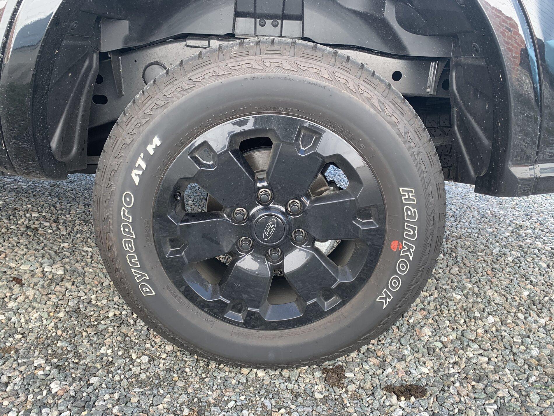

Those lug nuts look perfect.
I purchased special sockets for my breaker bar and torque wrench that have inserts to protect the lug nut and the wheel. Not for use with an air impact wrench. Price is right IMO.

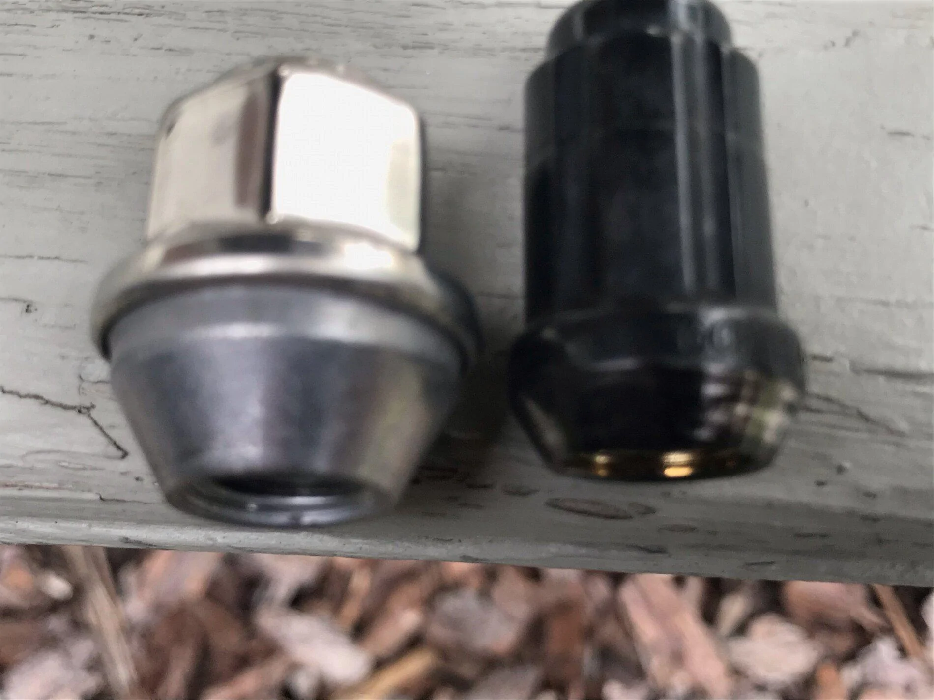

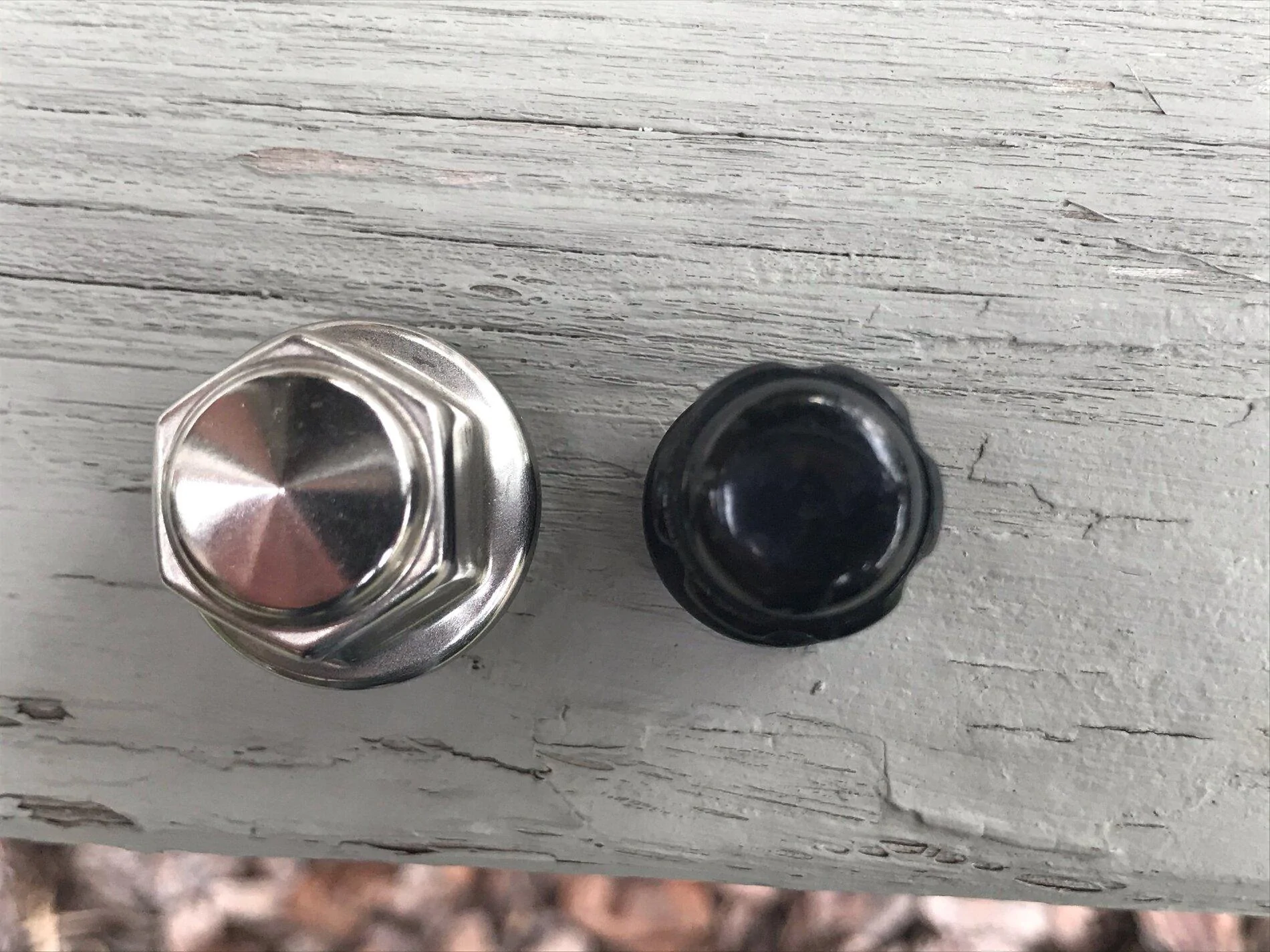

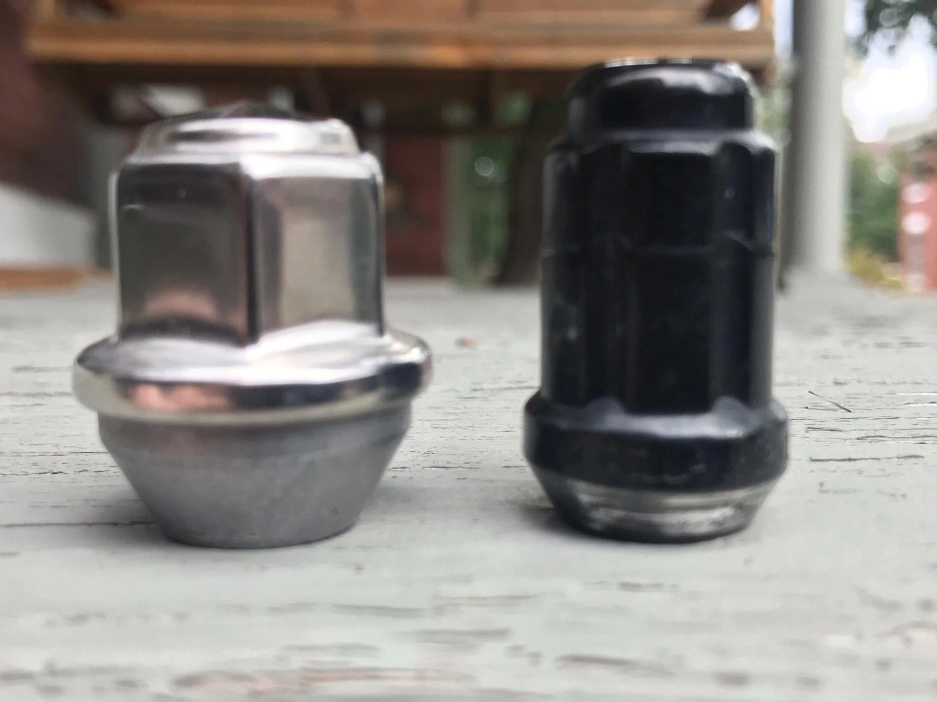

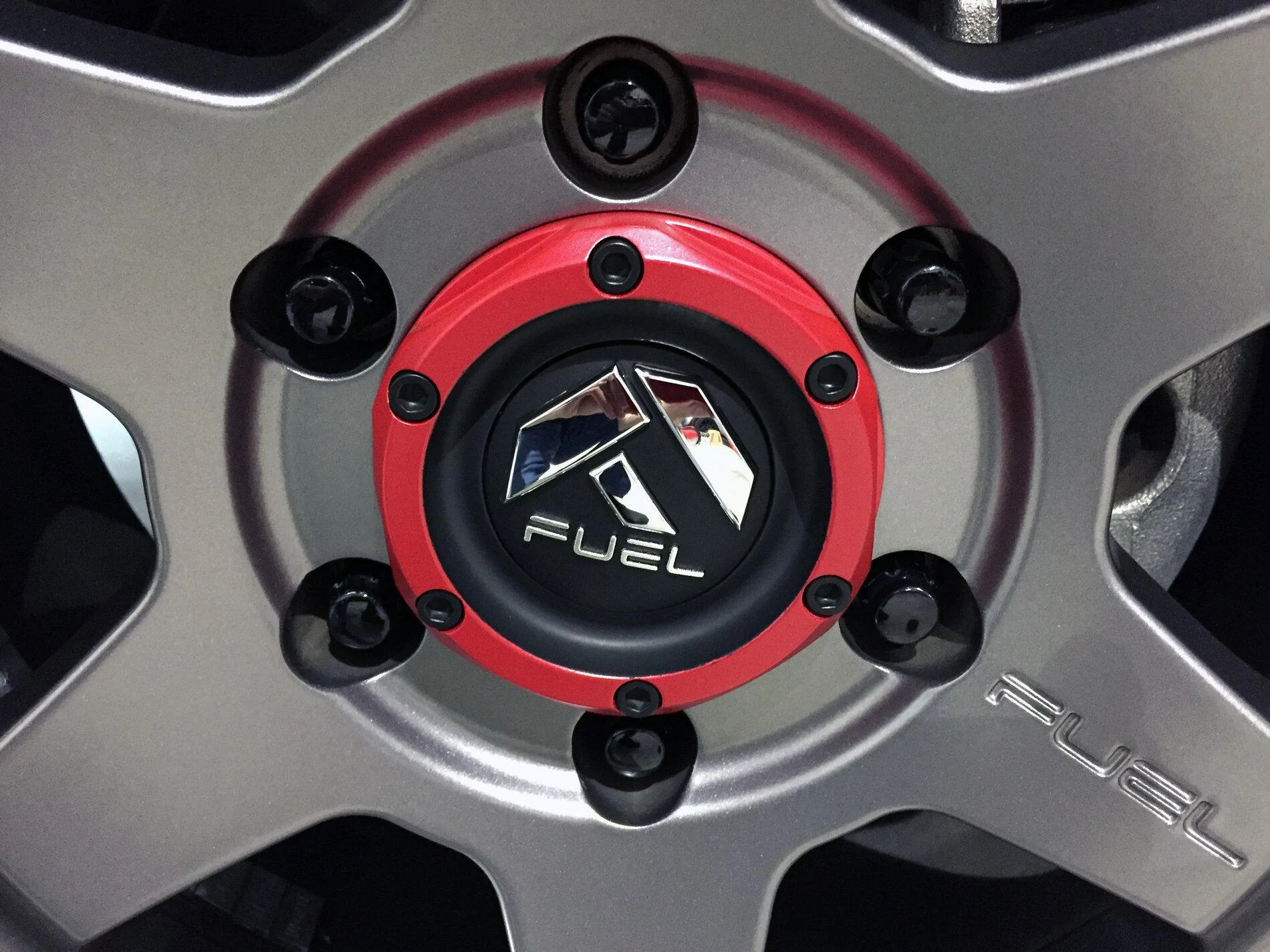

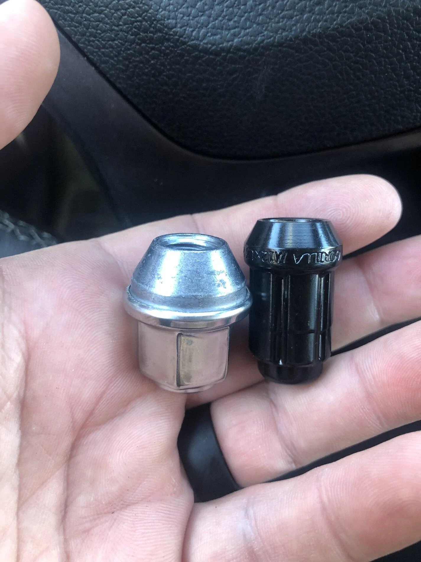

Seems like a LOT less surface contact with these! Looking at your wheels @JKocot , it’s comparable tho. I assume you haven’t had any issues?
the angle looks fine, but the amount of contact is drastically reduced.

I think the black ones should be avoided...not enough bearing area...McGard for the black one?

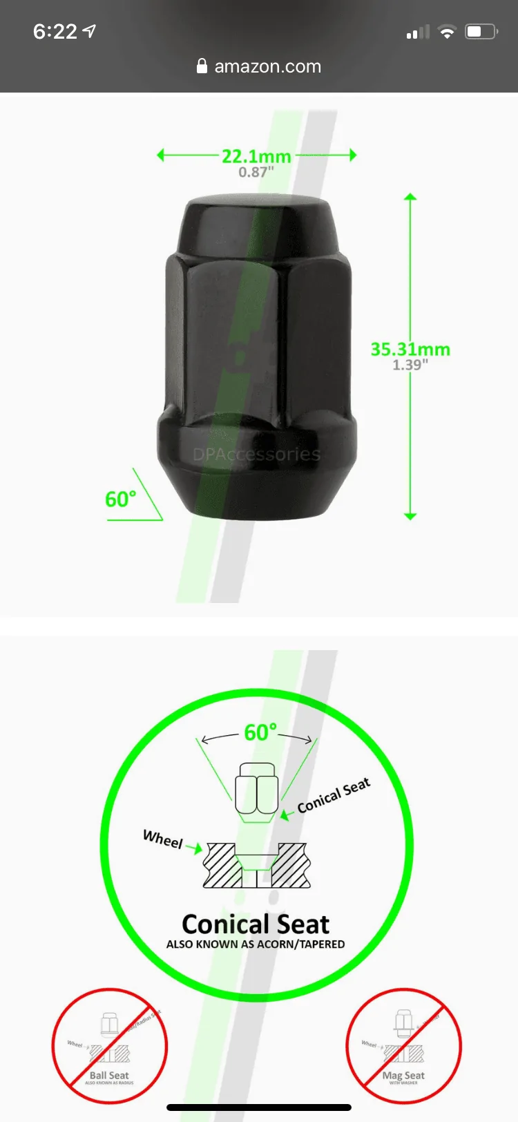

you can see the stock two piece lug nut that is prone to swelling. I got rid of these on my chrome package with ones off Ebay that have the same bearing area as the OEM lug nuts and are plated chrome. JMO Cone angle on both are 60°.

No I have had no problems but now I am paranoid.
