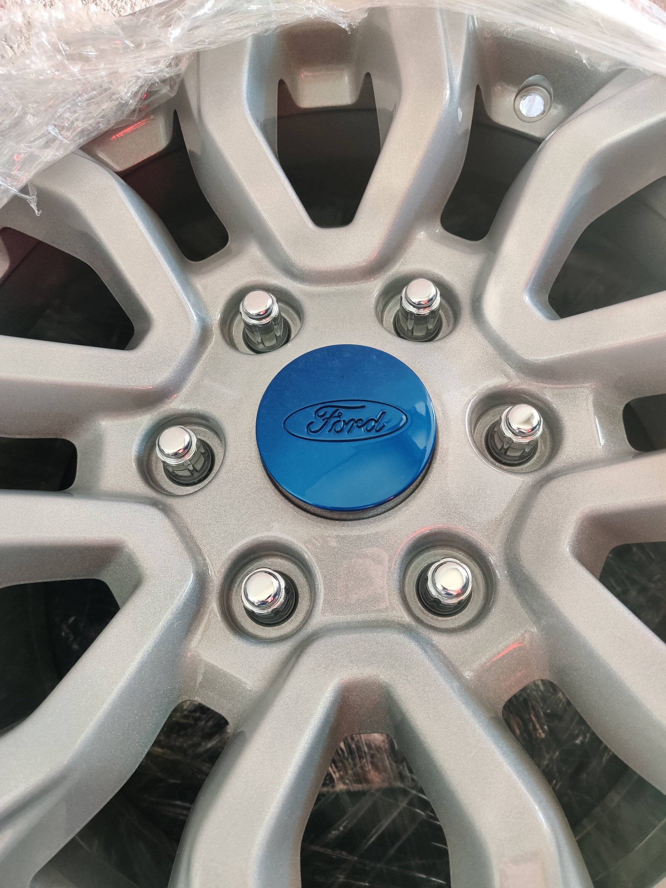

For the purposes of anything lugnuts, I won't run anything but Gorilla. They're actually fairly cheap, and they're top recommended from any shop I've ever asked and I've run them on multiple vehicles. I confirmed this set works flawlessly on the Ranger and have run it since July 2021.

On Stock Ford Wheels? Amazon is saying they don't fit a 2020 Ranger. Of course Amazon seems to be wrong more then they are right.
Yes. They also say they don't fit my 2019 Ranger either, but I confirmed with them before ordering and they do fit perfect.

I've been looking and all the gorilla nuts are just a taper. The ranger factory Wheels requre a bulge type. Are y'all using aftermarket wheels or just using a straight taper anyways?

I'm using the gorilla nuts and the factory wheels. They're acorn style that work perfectly.

Have you pulled one off to see of its mating the wheel properly. I haven't found any gorilla lugnuts that have the proper bulge where it seats against the wheel. I know a tapered nut will hold it, but won't have the proper hold that the bulge taper will provide. Sorry if you think I'm being picky, but I'm a retired master auto tech and want the proper nuts holding my wheels.
