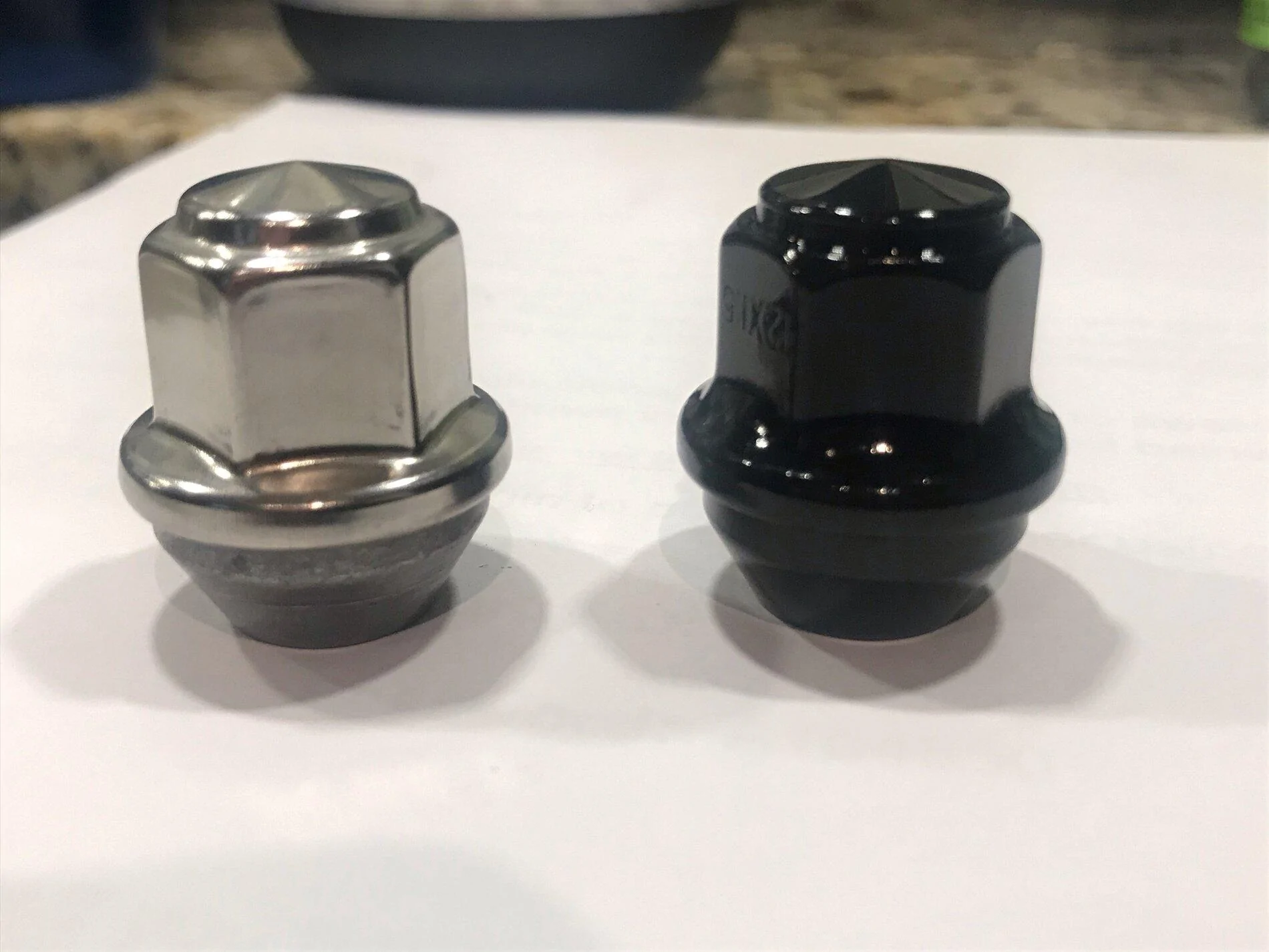

Hi Rence,
I believe these will work. However I would verify the thread depth to make certain the these lug nuts will not bottom out on the stud before clamping the wheel to the rotor.
best,
Phil Schilke
Ranger Vehicle Engineering
Ford Motor Co. Retired
1.25” depth on the detail portion from that link. 1.36-1.39” is what I found on others posted and what I have, but unsure what the depth of the factory lug nuts are.
Hi Dillen,
Take one off your Ranger...and check the dimensions....Should tell you if the Ebay offering is going to work for your Ranger.

I'll pull one after work and measure it.

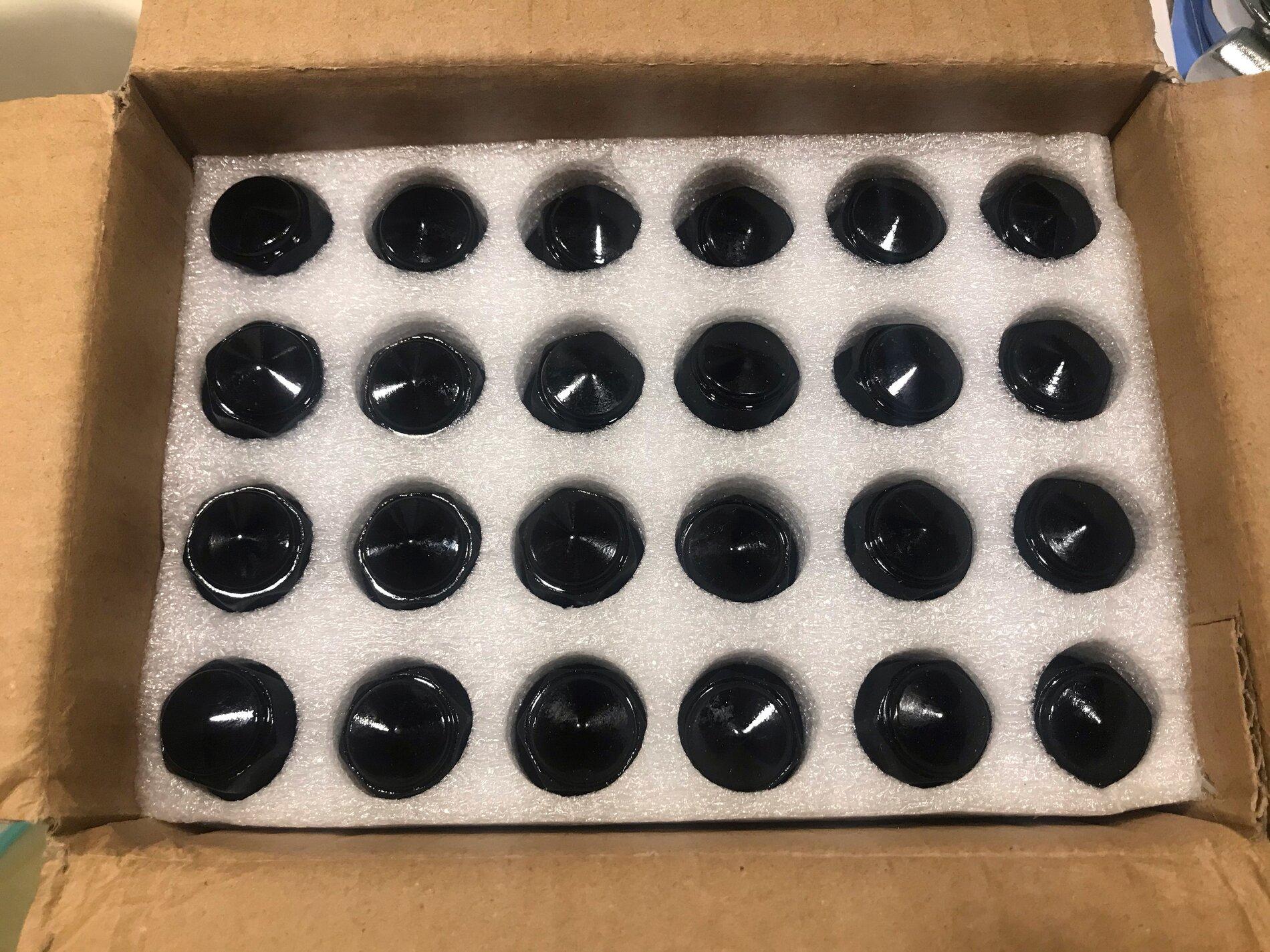

My solid black lug nuts arrived today. Was quite impressed with the packaging. Closely compared them to OEM before installing. Perfect match!
Doug - take a pic once they are on and post please! Also your pic has 24 but the ebay link says 20.
That is what I’ll be ordering soon!
I ordered 2 packs of 20 and combined the package just for the photo. I'll grab a picture tomorrow in the light.

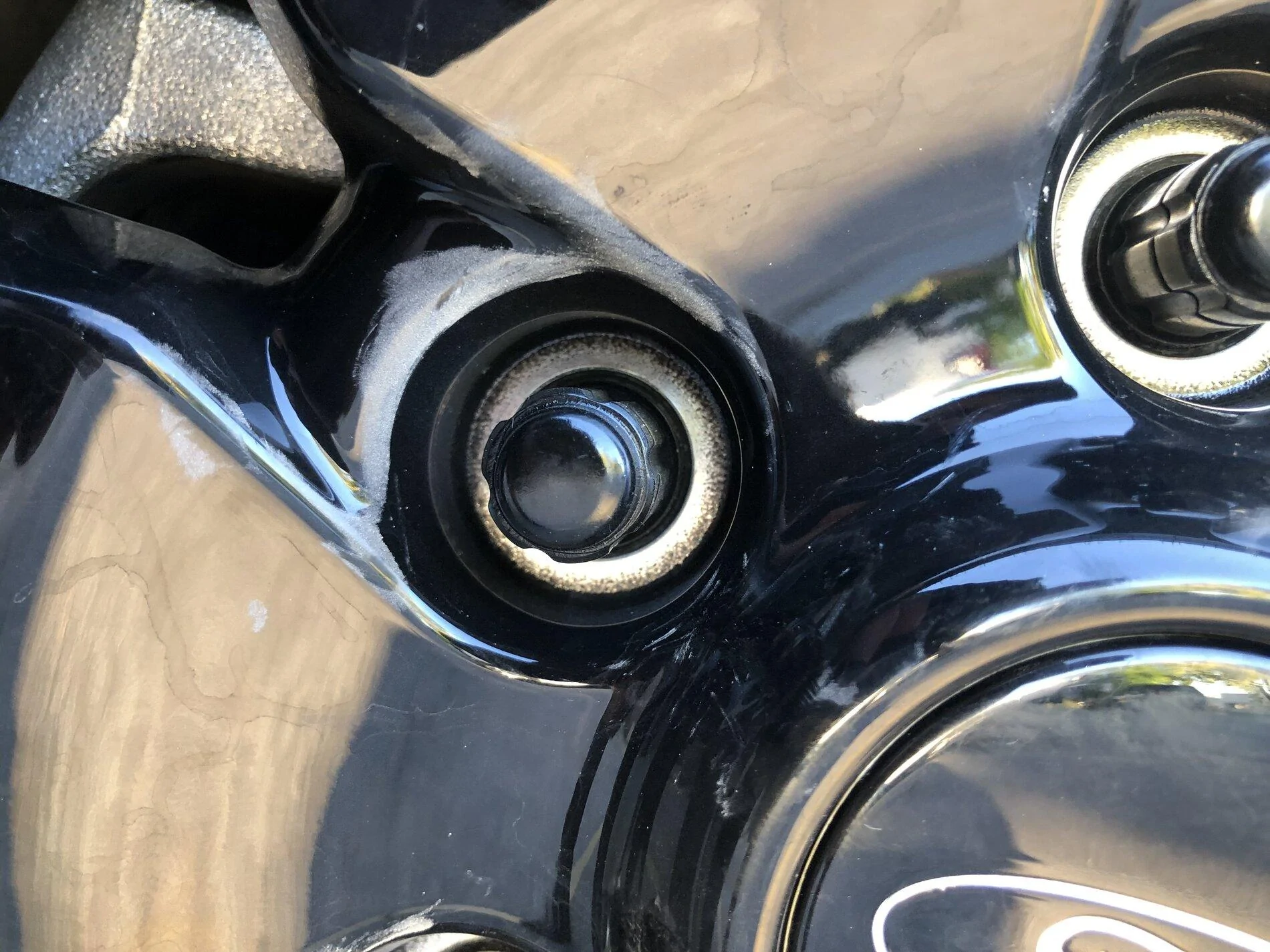

That looks much better than these...

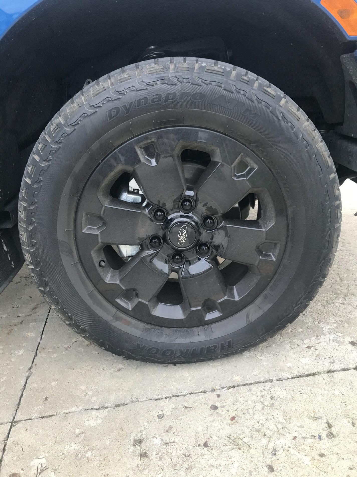

Need to wash the truck.
HI Doug,
Looks great!
