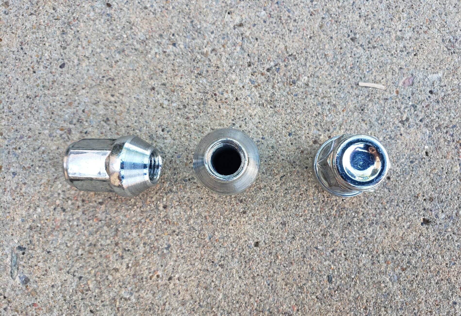

Doe's anybody recognize these lug nuts? If so, what is the brand and quality? These came with the upgraded wheel and tire set. The brand is not stamped on them. The only thing the seller said was they are not factory Ford lug nuts and they are longer than the factory ones (1 3/8"). Don't know if they are aftermarket or Ford upgrades?
Thanks.

I bought a set from a reputable company who said they fit, but the cone angle seat was too small and may have come thru the wheel over time. We went round and round for a week . I sent them back and got factory black lug nuts . I was not going to take the chance of them pulling out.

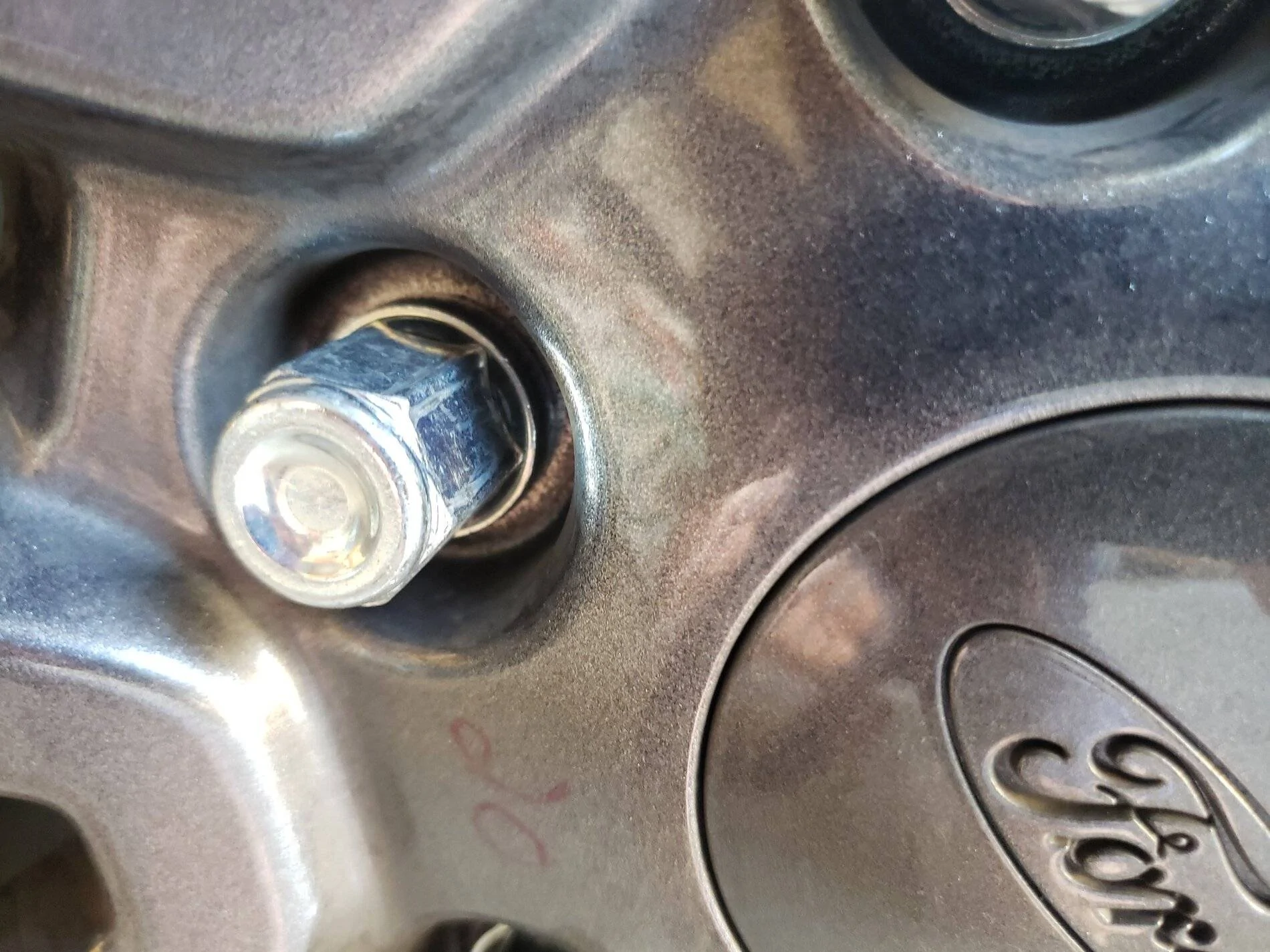

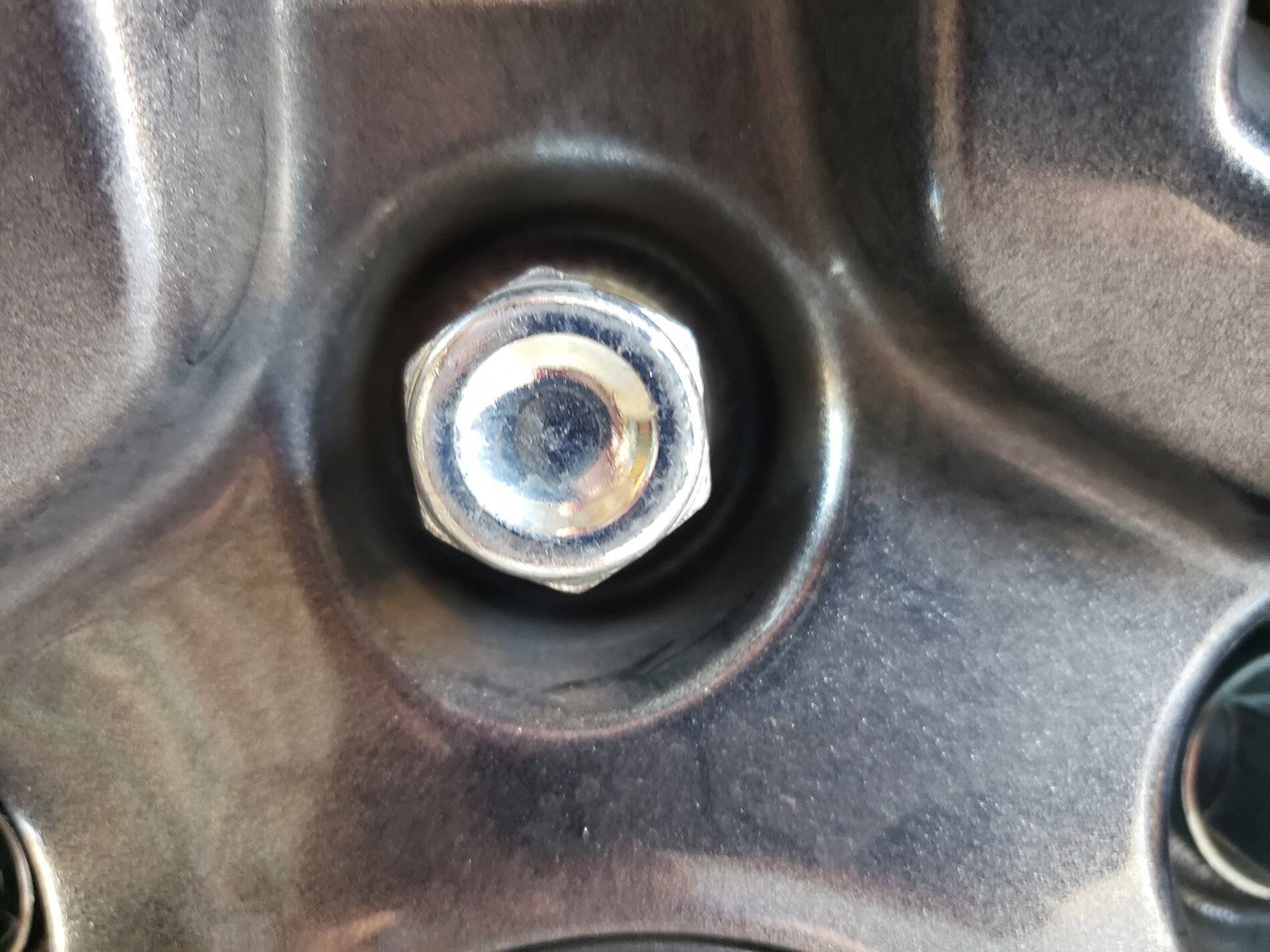

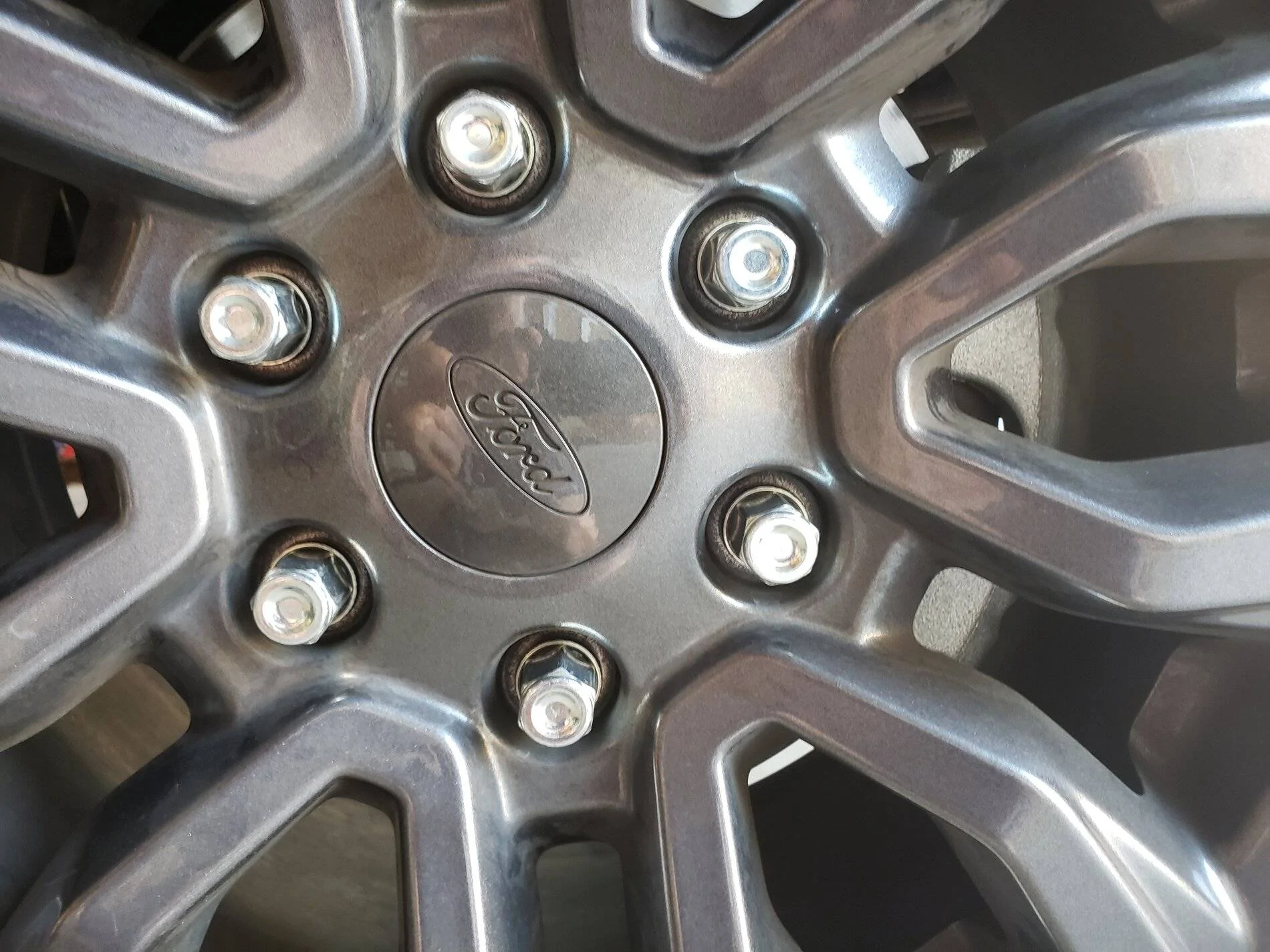

I’m looking to switch to black lug nuts, but wanted to check with the experts here to make sure these are the correct size as the ones that come with our trucks. I’m big on safety and don’t want my wheels falling off! Thanks!
They look like the crappy two piece oem lug nuts but in black
do yourself a favor and find solid lug nuts
7,085
37,247
I’ve read that those are no good. They don’t have that 60 degree cone that’s needed from what I understood
