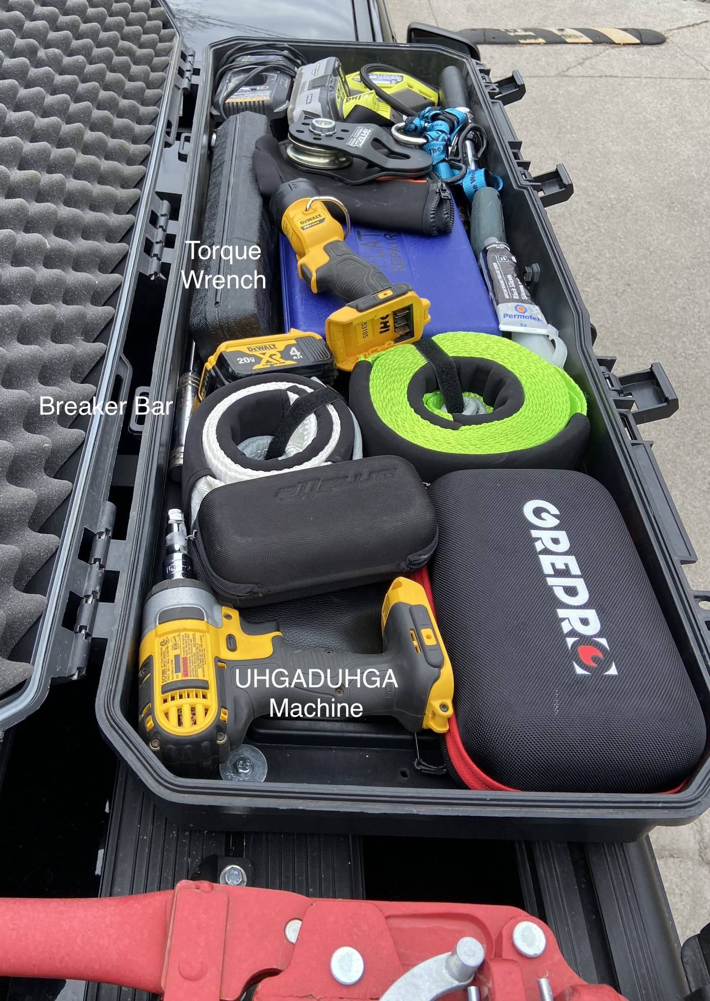

9,830
47,016
Yep...I have splined lugs so that attachment is taped to a 1/2" socket...I carry my long breaker and a torque wrench all the time...
Gotta keep those things together - good job Sid! In the picture above, that black Arnette sunglasses case by the 1/2” impact tool has my wheel set’s splined socket and the necessary impact socket that slides over it.
