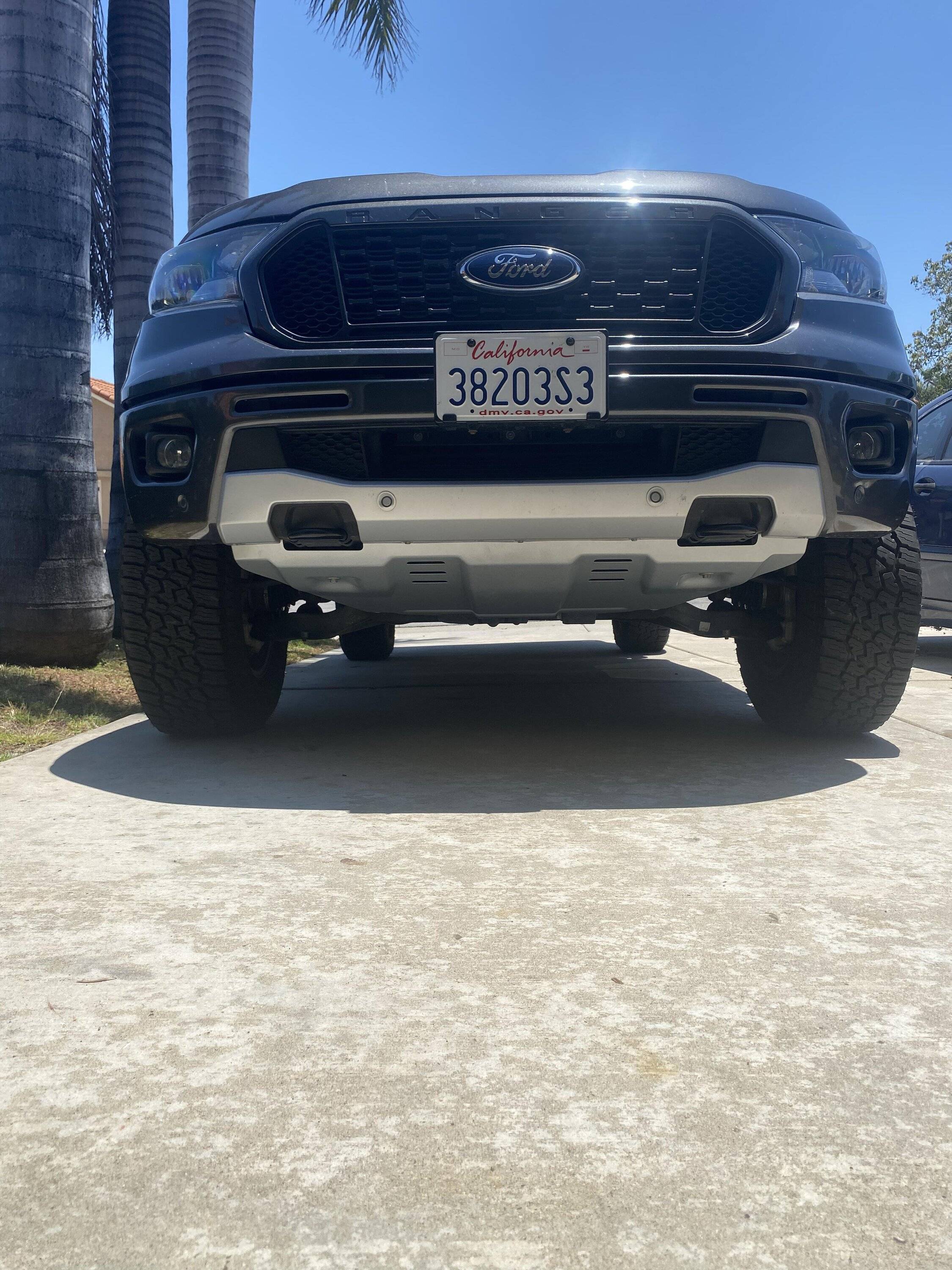

Hmmm... I got the (FX4) skid plate for points from Ford- I have an STX. Everything was pretty straightforward on the install. I opted to remove the big air dam and not get/install the two small air dams...
Looks much better…..
did you buy the upper piece with the sensors or was that piece already silver?

Systems Analyst for Bonsall Unified School District
Already silver, but I might get it and the skid plate Rhino coated black
