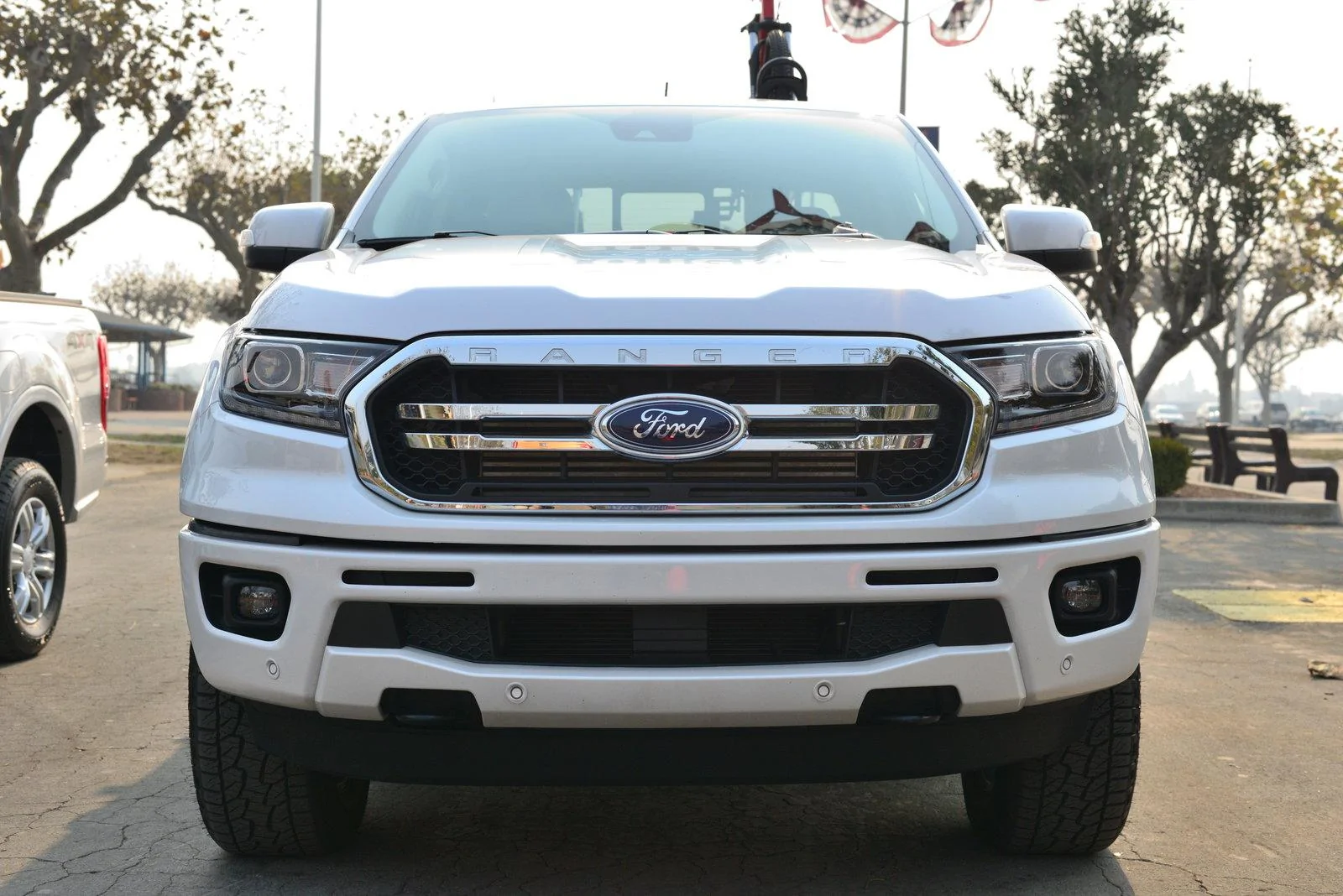

I really like the look of the FX4 package, so since Ford doesn't offer a FX2 package on 4x2 Rangers, I think I’m going to remove the front air dam and install a factory skid plate.
From what I can tell, it looks like the front air dam is held on by a few bolts, and the skid plate looks easy to install yourself as well.
Who else doesn’t really care about fuel efficiency as much as improved ground clearance and looks?

I wonder how much of an impact the front Air Dam has on fuel economy. It will be interesting to see if there is a difference in MPG with the FX4 package.

2016 CHEVROLET COLORADO Z71 DIESEL UPDATE 5: REAL MPG WITHOUT AN AIR DAM
It's a significant benefit to fuel economy," Burke said over the phone. "It's one of the things that we focused a lot on as we developed the Colorado, paying attention to how [the air] floats around the fenders, the lamps, the hood, the roof, and that air dam is a key attribute to it, so there will be a notable difference in fuel economy once you remove it." Pressed on providing a number figure, Burke estimated that highway fuel economy will drop at least 1 mpg on the highway without the air dam.
Its first test would be completely stock as delivered from the factory with the air dam affixed. Under our Real MPG cycle, our stock diesel Colorado Z71 4x4 achieved an impressive 21.5/31.9/25.2 Real MPG city/highway/combined.
With the air dam and side steps removed, I handed the keys back to the Emissions Analytics team and eagerly awaited their results. Their testing shows that without the air dam, our Colorado Duramax 4x4 achieved 23.6/30.6/26.3 Real MPG city/highway/combined. Compared to the same truck with the air dam on the Real MPG cycle, that's a 9.7 percent improvement in the city, a 4.0 percent drop on the highway, and a 4.3 percent improvement overall. Compared to the EPA, our truck [without the air dam] improves 18.0 percent in the city, 9.3 percent on the highway, and 14.3 percent on the combined cycle.

I’m pretty sure it has more to do with cooling than fuel economy. It creates more of a block for air trying to travel under the truck and therefore makes the path through the grill and radiator less restrictive. In other words instead of giving air hitting the front bumper an easy path under the truck it slows it down, creates a bit of a roadblock so more air will follow the path through the radiator

Aerodynamically, removing the air dam allows more air under the vehicle, creating dirty air. This creates drag and drag reduces fuel economy. From the Colorado forum, most users experienced at least a 1mpg drop when removing the air dam. If the dam hindered the fuel economy, and with CARB specs, why would a manufacturer install something that reduces economy ?
