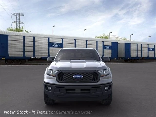

mine wont have a skid. still removable? will look like this 21

Idk if you can tuck it if you dont have a skid plate there but you can take it off
you should be able to take it off regardless idk if you can tuck it if you dont have the skid plate down there is yours 4x4?

You can remove it but modding it to close a gap? No. The gap exists because of the skid plate and the skid plate holds the modified dam in place, using the tow hook bolts to pinch it in place.

again, my truck wont have a skid, as the one pictured in my previous post

it will be 4x4 but without a skid

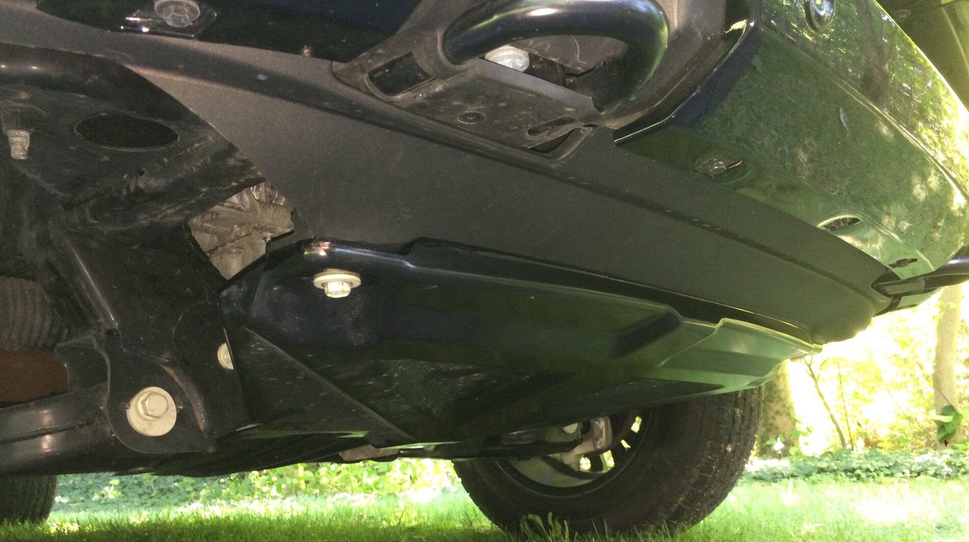

I have a 4x4 and replaced the skid plate with the FX4 one. It did not require a different bumper.

Looks amazing, thanks for taking the time to shoot these pics for me. :)
I wonder why people were having issues with a gap between their skid plate and bumper then... hmm
No problem! I would’ve taken a better picture, but if I had opened up my garage door, the wife would’ve probably thought I was escaping the house for good ?
Pretty sure the gap people are referring to comes from the non FX4 skid plate. When you remove the air dam, there is definitely a gap… It covered up completely when you swap it out with the FX4 version though.
