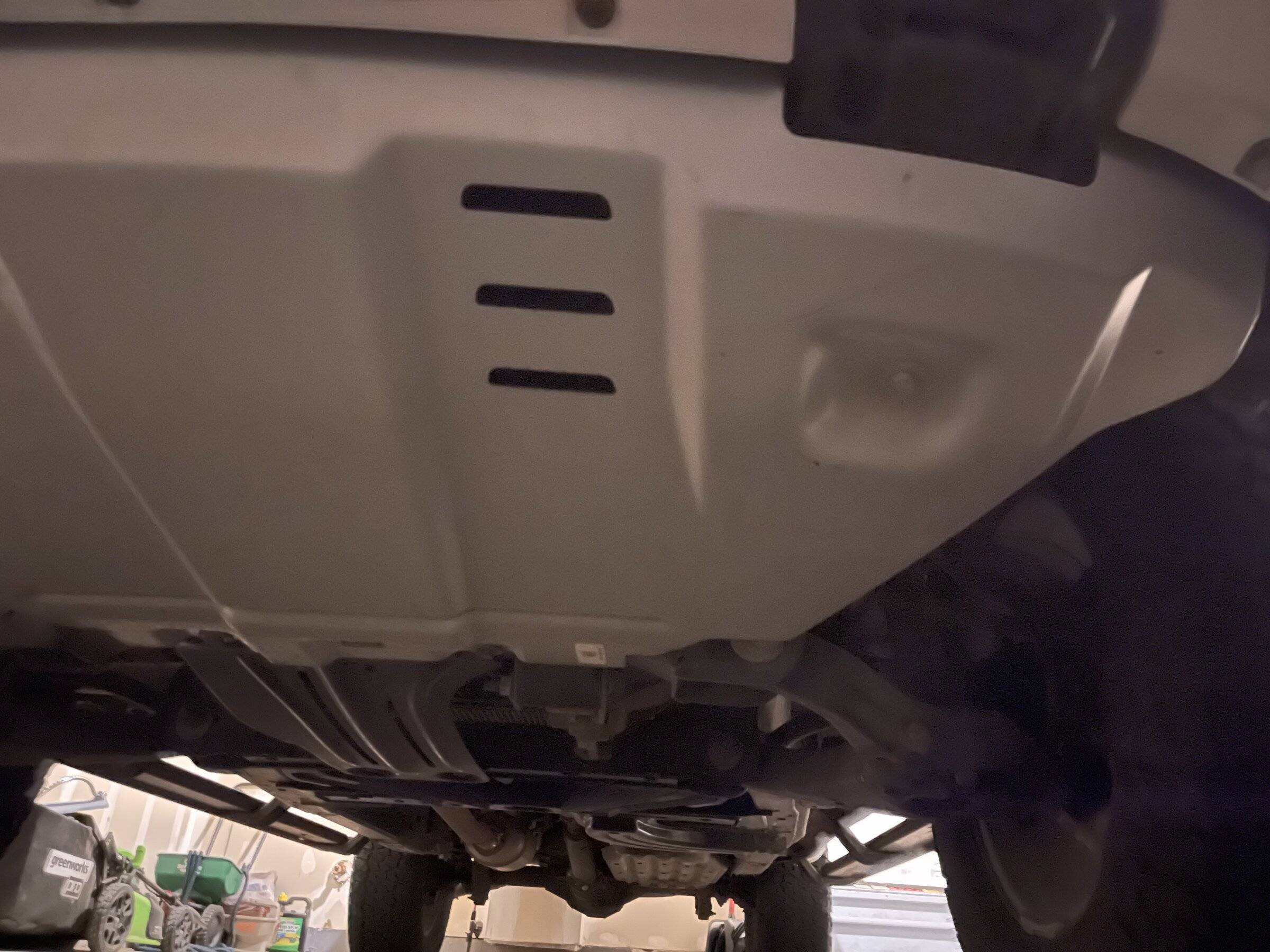

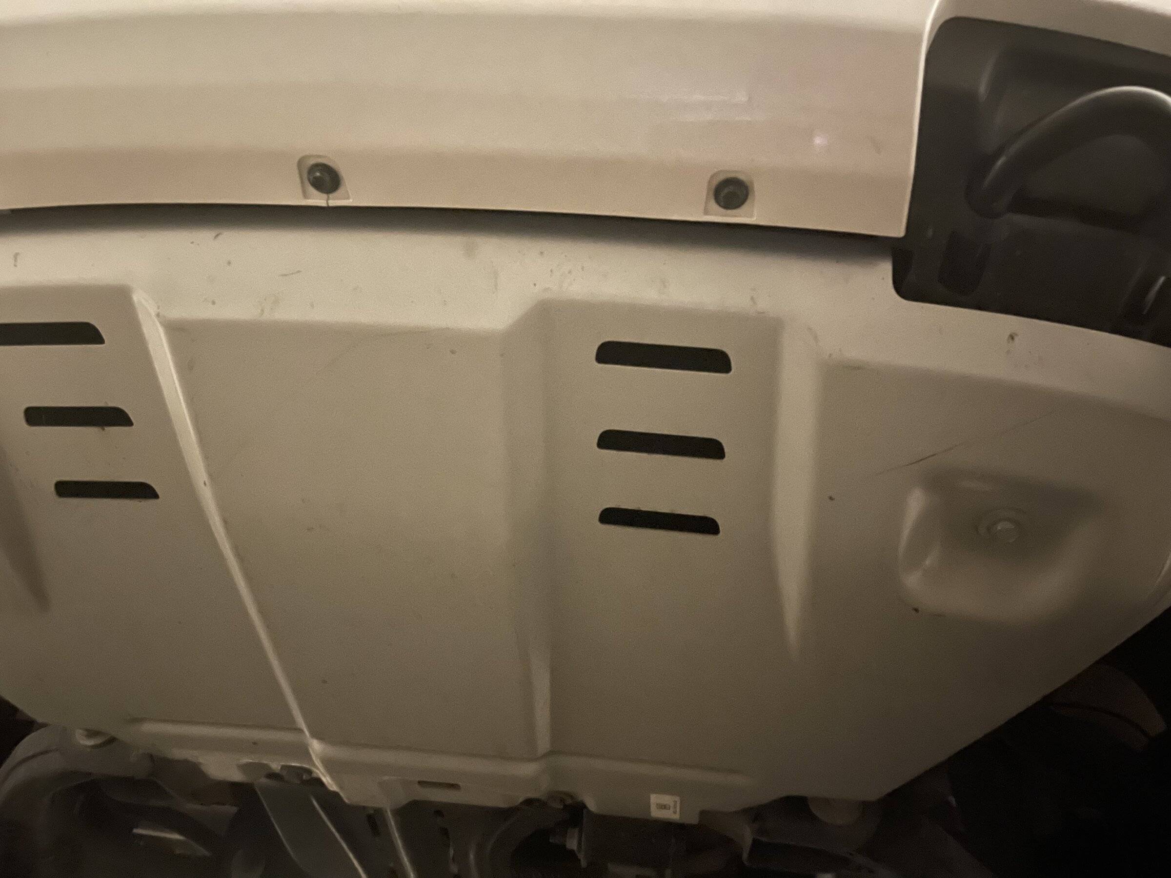

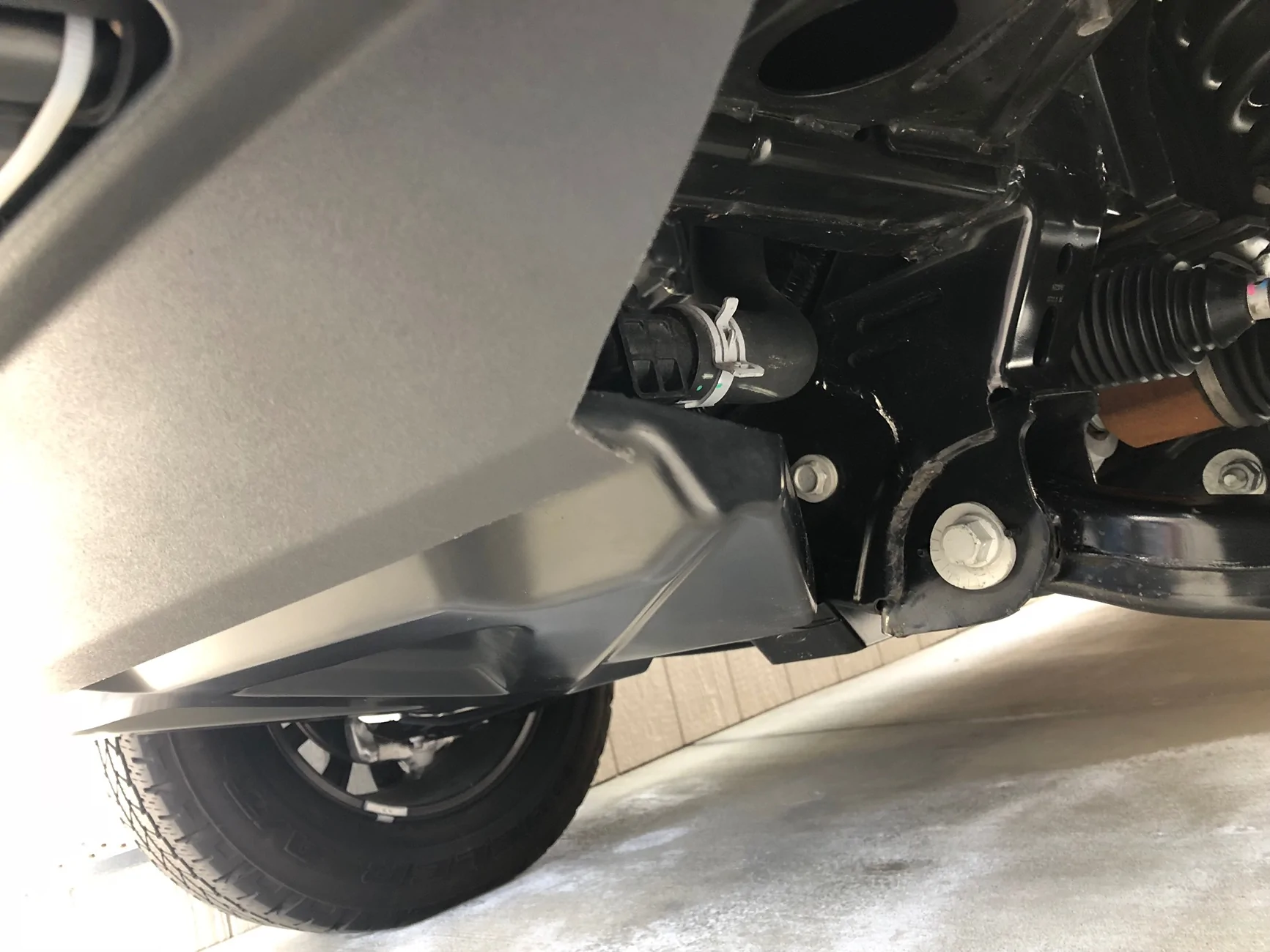

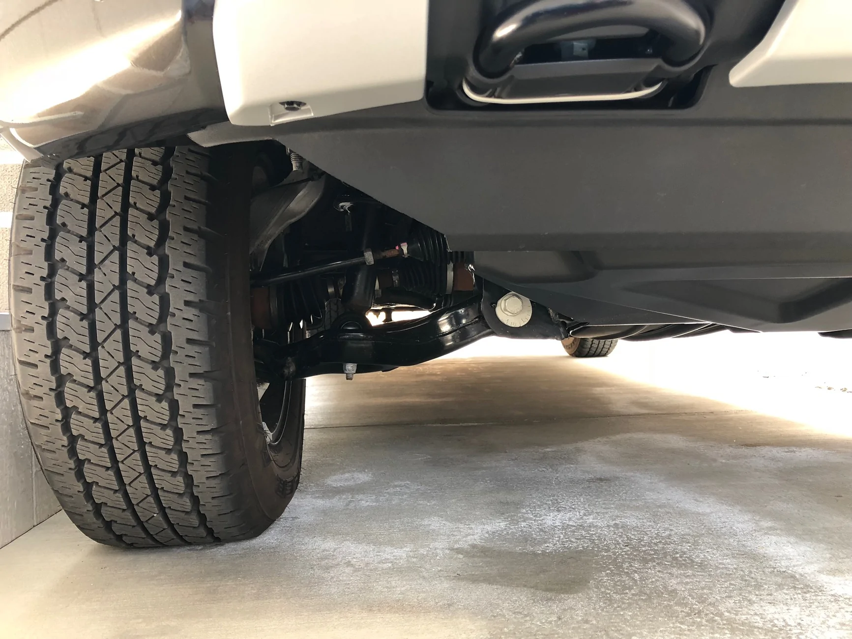

No problem! I would’ve taken a better picture, but if I had opened up my garage door, the wife would’ve probably thought I was escaping the house for good ?
Pretty sure the gap people are referring to comes from the non FX4 skid plate. When you remove the air dam, there is definitely a gap… It covered up completely when you swap it out with the FX4 version though.

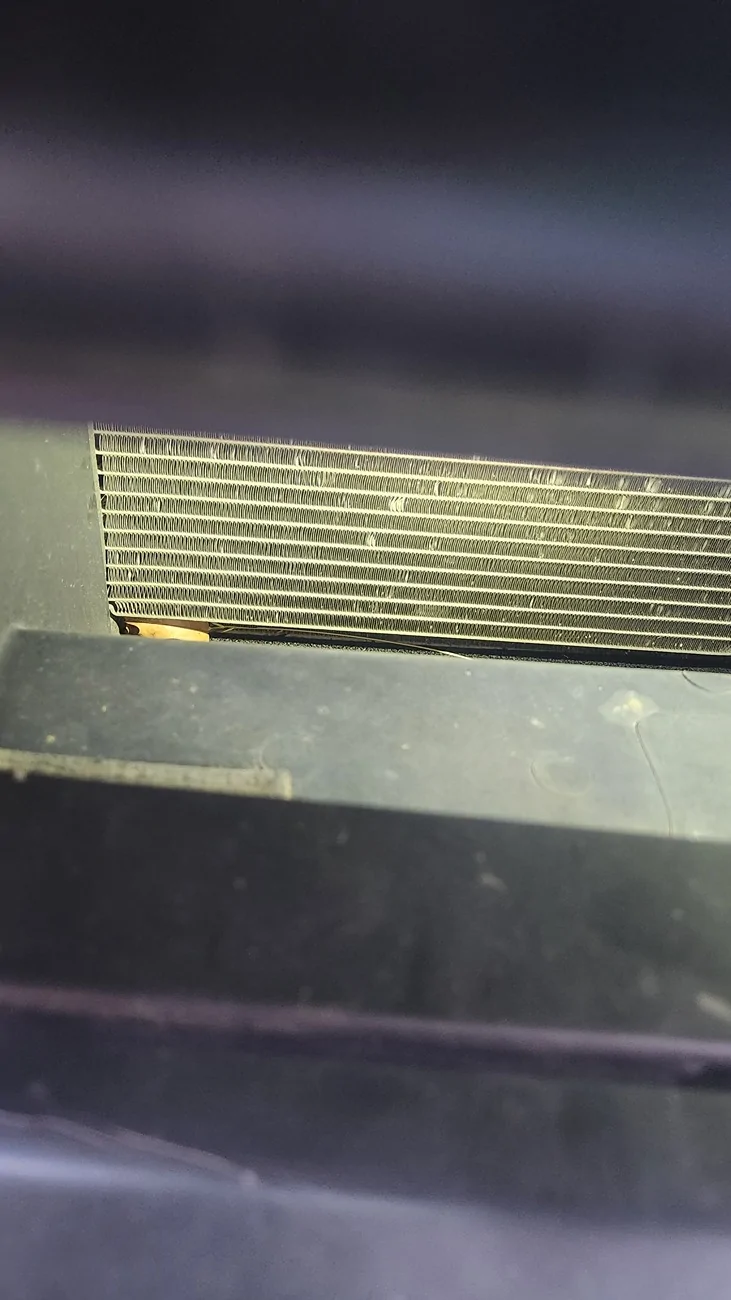

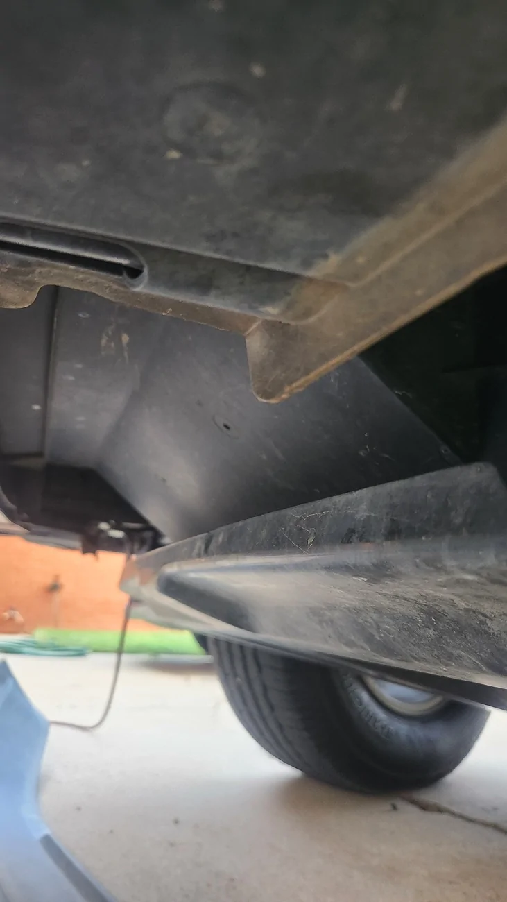

Hi,
I pulled my air dam off and looked at the location, and design of the part. It is only for mpg/drag purposes. The radiator area is separated by its own air dam that opens up just below where a front license plate goes. Removing the dam does not impact air flow to the radiator. Hope this helps!

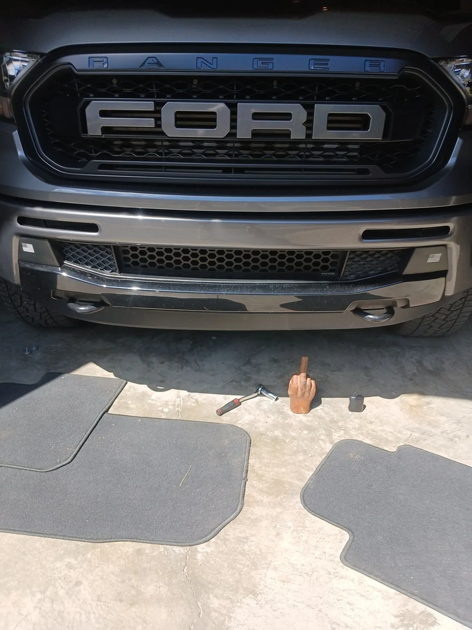

I did the Duke mod

Im going for it... that finger is not ment for anyone here (well, maybe some naysayers) its for any uncooperative parts of the truck as I got tired of putting down whatever i was holding to make the actual gesture so I carved an exact duplicate out of some wood 🪵.... comes in "handy" (hahahahah see what I did there ?)

I’m diggin’ those Magnetic letters. As Doc would say, Nice!

From a Technician who has been at that frustration point - many times over the years:
That sir is (PRICELESS):LOL:

That is some Amazon wrap that is pretty damn close to my paint color and was way cheaper than paint to match... they have held up MUCH better than I expected...
