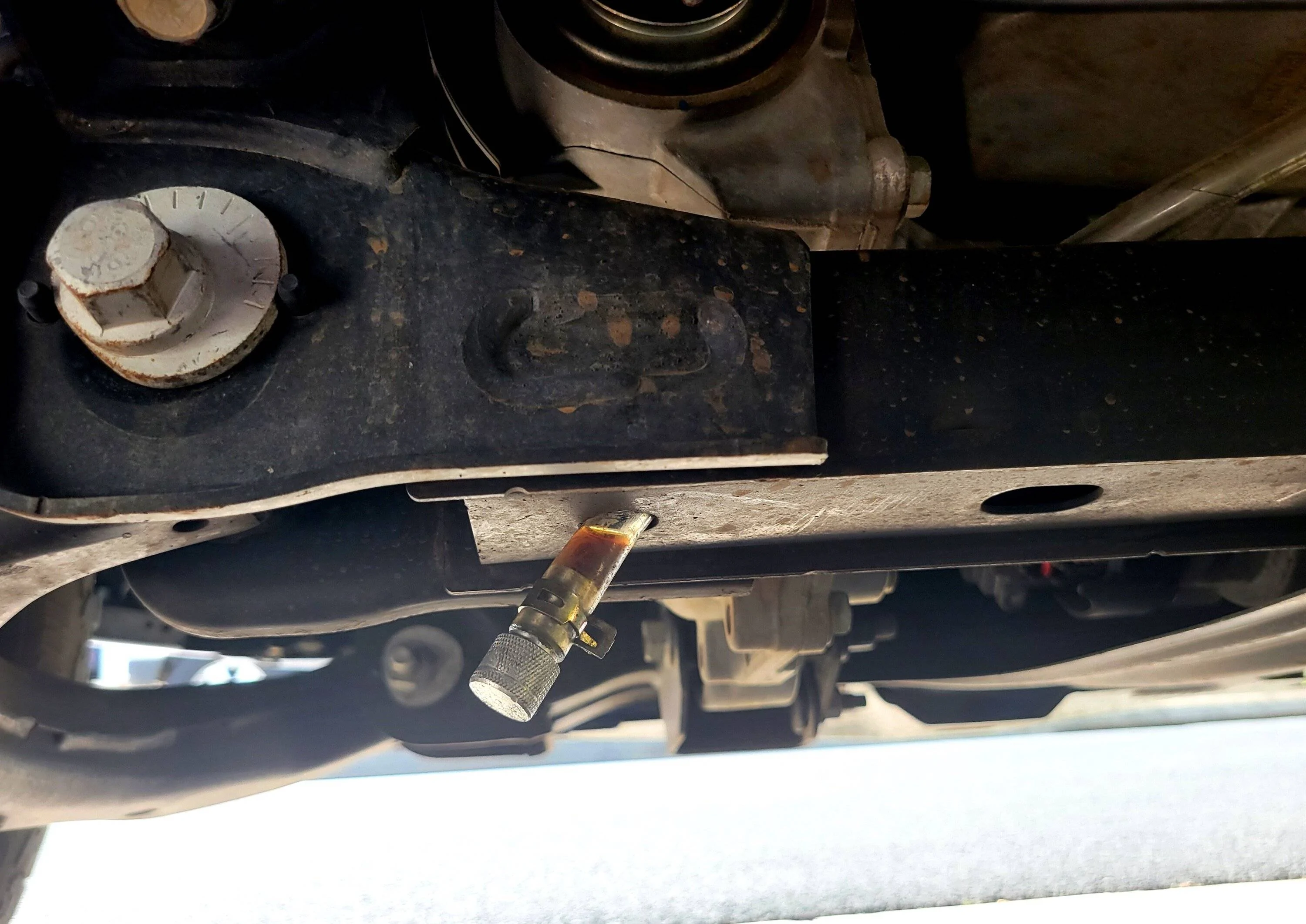

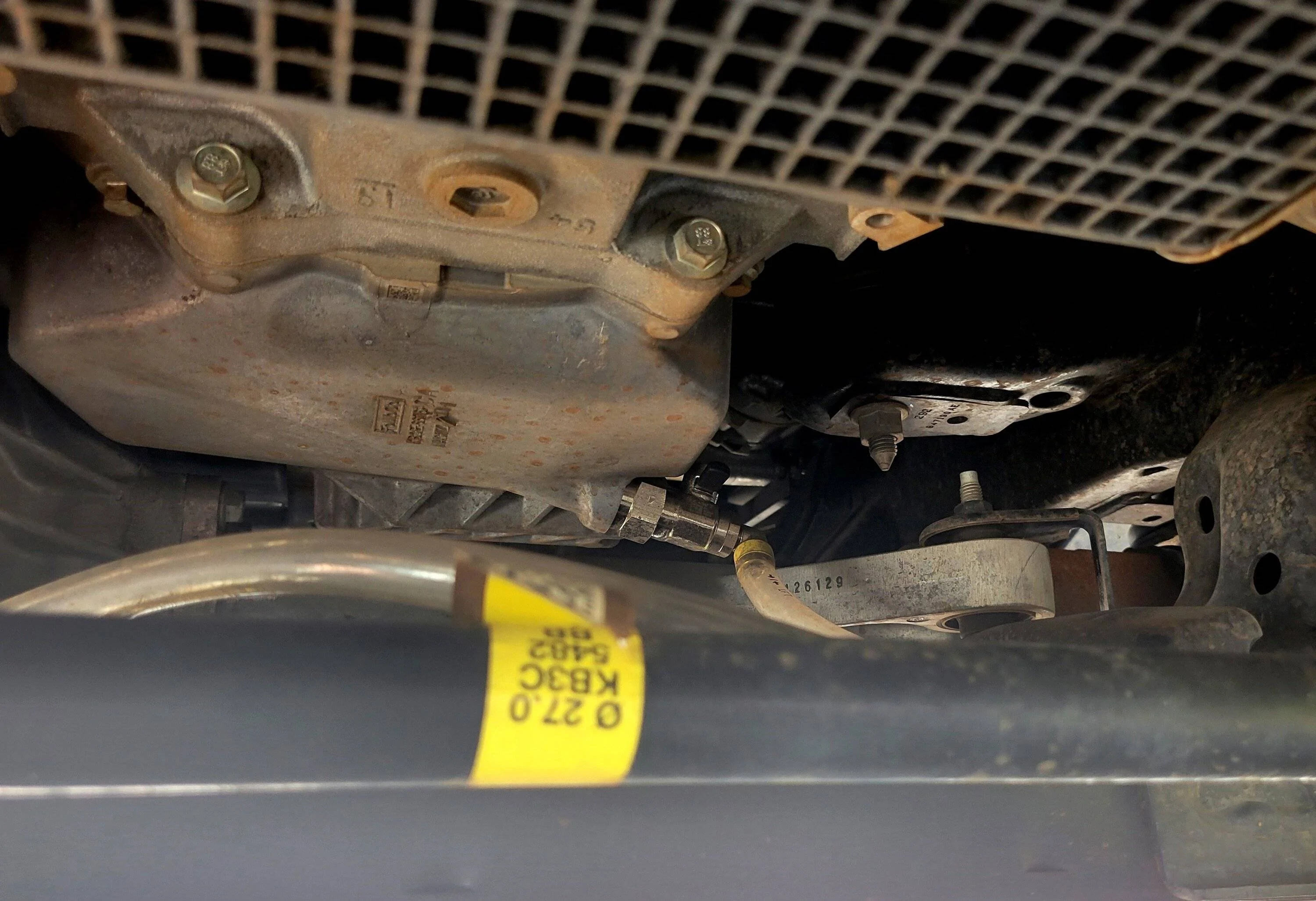

Gents,
Regarding oil changes, I found this item to be a life saver. No PITA removal of the skid plate, and if you purchase a 2' section of clear vinyl tubing, you can plumb it down and through the frame to a location that makes it easier to access. I added a plug to the end of mine, so it won't drip any residue from the tube after each change. Works like a champ! Cuts rolling around on the cold concrete down to mere minutes and for me, that's huge. I no longer feel like I've been pushed down a flight of stairs the next day..
EZ-107(12mm-1.75) EZ Oil Drain Valve with removable L-Shape Hose End Combo: https://www.amazon.com/gp/product/B00JBR9NAQ/ref=ppx_yo_dt_b_asin_title_o02_s00?ie=UTF8&psc=1
