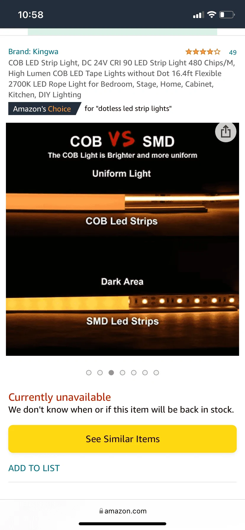

Ive been looking at those to make my version of the RTR snout lights, but in amber. Probably is it won't look right with those led strips. I need basically neon tubing, but everyone makes versions that either;
A. Are switchbacks (white drl, with amber sequential) (I want amber drl only)
B. Are neon tubing in the 16+ range meant for homes.
If you have any ideas where I can find amber neon tubing that I can use let me know!
Check out cob strips. There are different densities. As bright, or brighter than your average LED strip lights. You don’t see the individual diodes.
