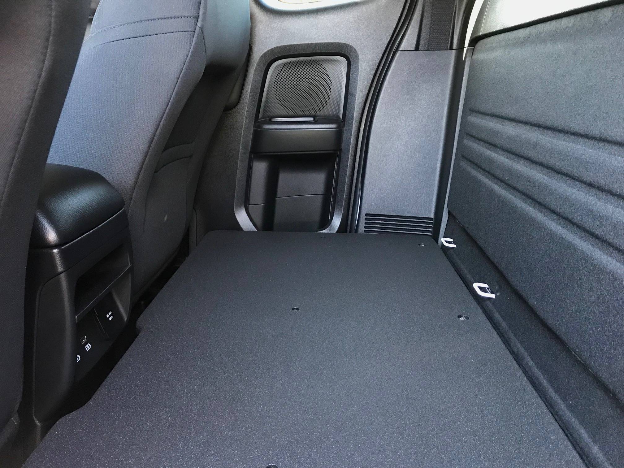

Do you think that platform could be hinged and lock in the up position against that back panel ?
I suppose anything is possible. There are four (4) existing seatbelt connection points in the rear of cab that are bomber and you could attach a hinged ledger board of sorts to those points. I used those and also installed 1/4-20 riv nuts to the edge of the seat base framework and secured the forward edge of the platform to the inserts. A 10mm bolt fits the the seatbelt points and 1/4" bolts at the front. I'll also mention that when you remove the Ford seat bottoms what you are left with is not a flat plane. There is a hump above the driveshaft that creates an area that is raised in the center. I solved this by creating spacers to level everything out. It was not a quick project. It took me a solid week to get everything dialed in.

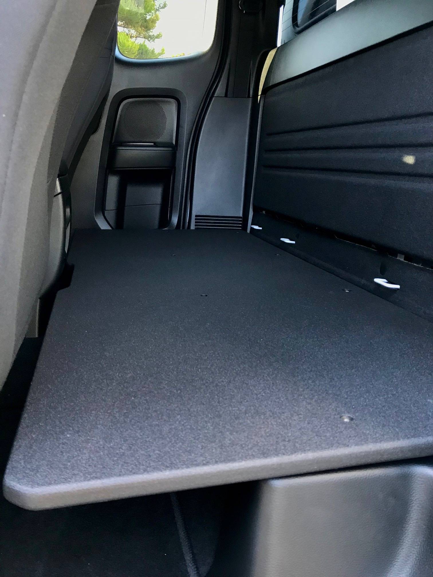

I wanted a platform for totes and gear inside my 2020 SuperCab so I pulled the rear seats out and fabricated a bench using a sheet of 3/4" Baltic Burch which I had coated with Line-X. Mounted up into the stock seatbelt points in the frame and purchased the OEM Ranger Seat Delete panel and trim to cover up the rear wall of the cab. Considerably less expense than a Goose Gear Panel and in my opinion a better fit and finish. Plan to add L-Track to the forward edge to afifix straps to hold down cargo. Stoked on the results. Onto the next project...
Nice and clean. Well done!
