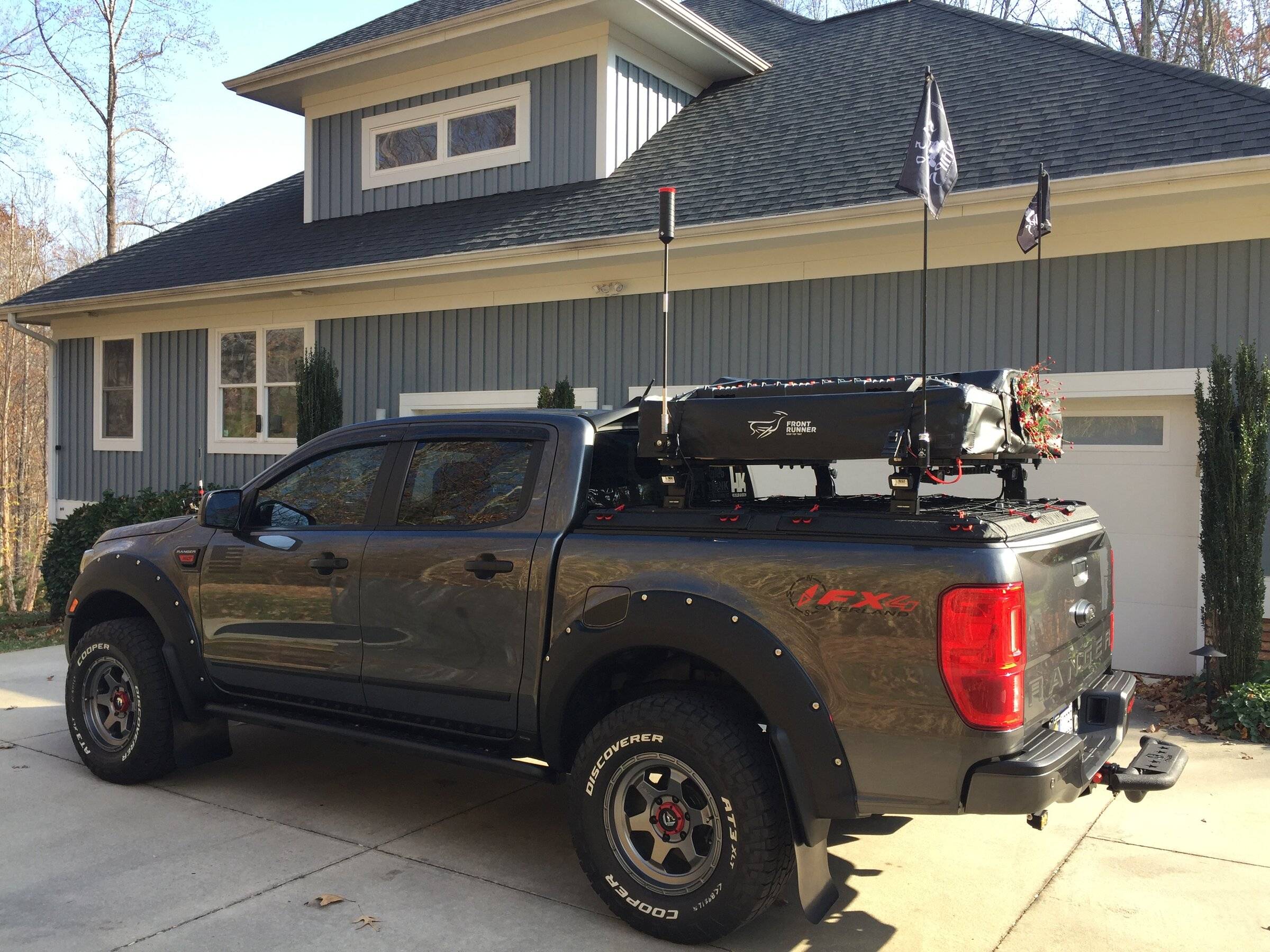

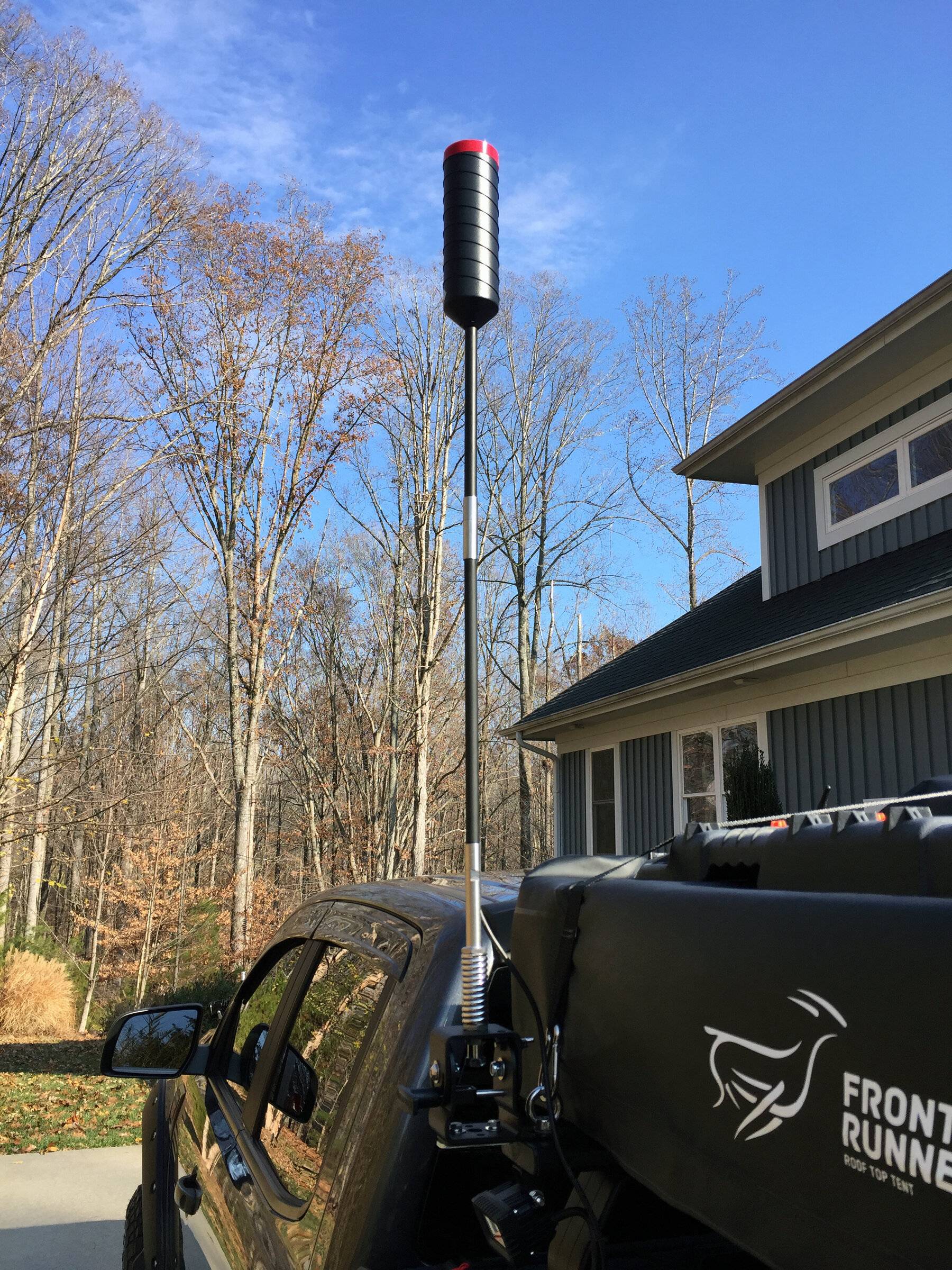

That looks like some NSA level stuff?

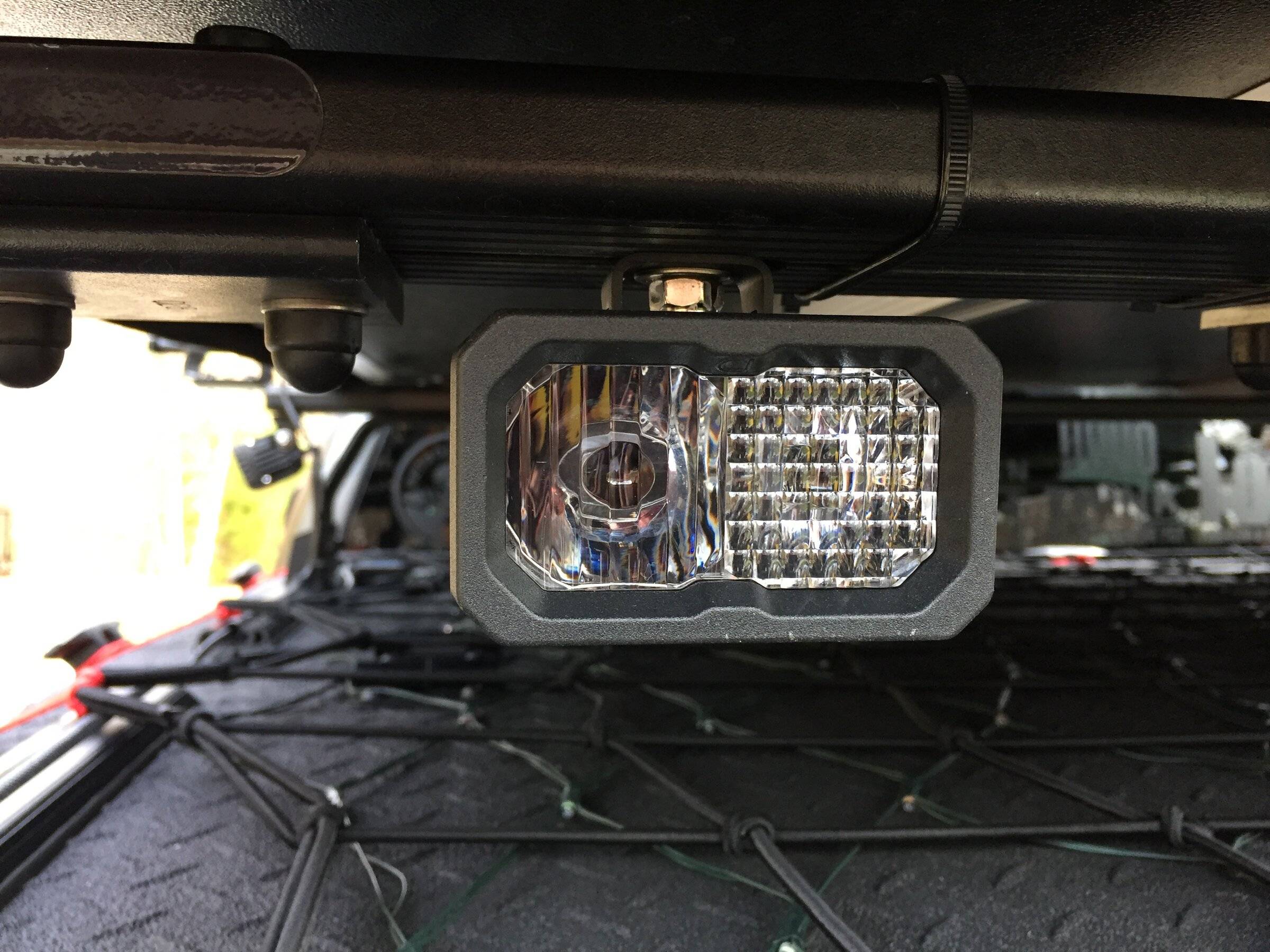

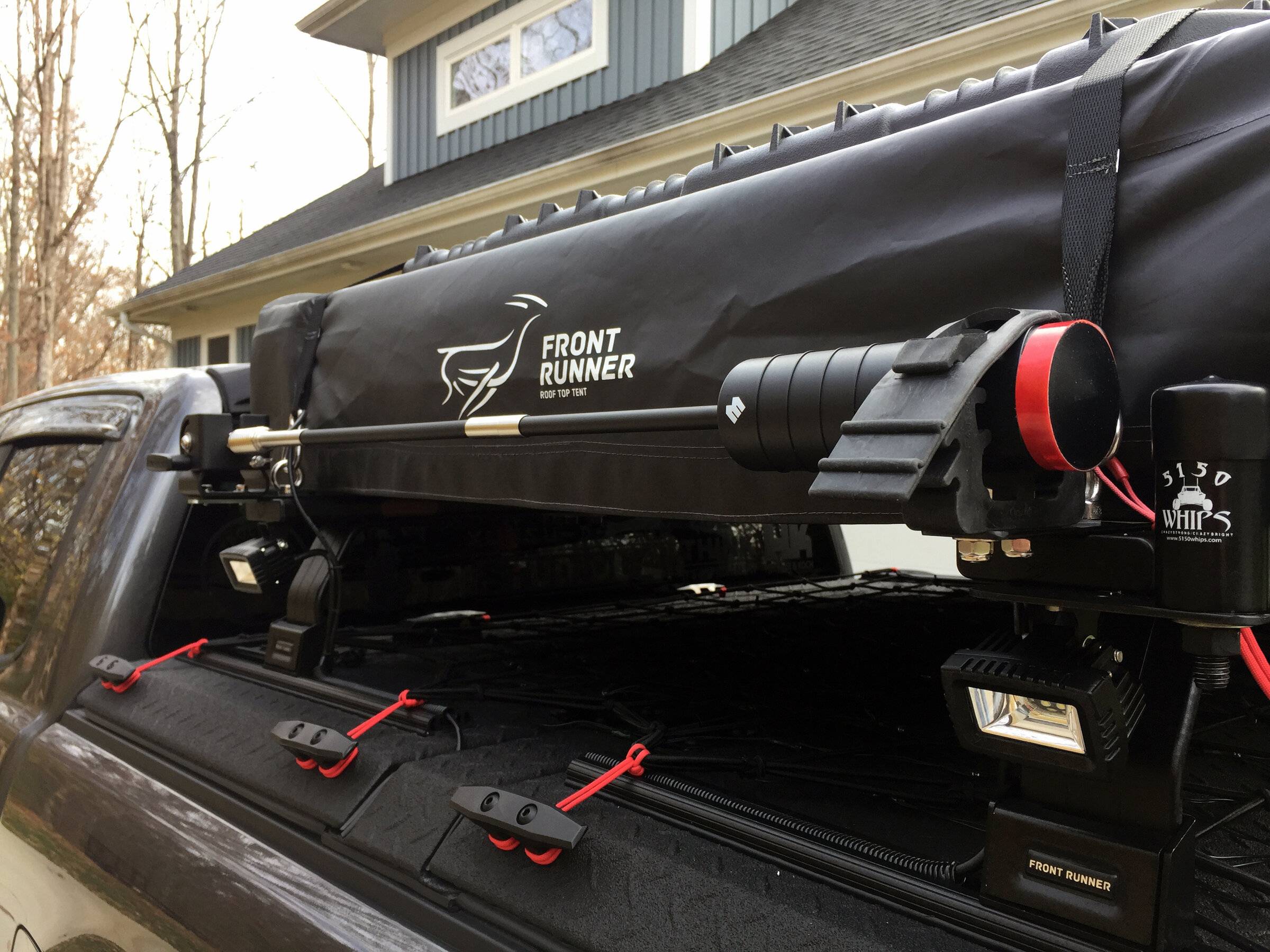

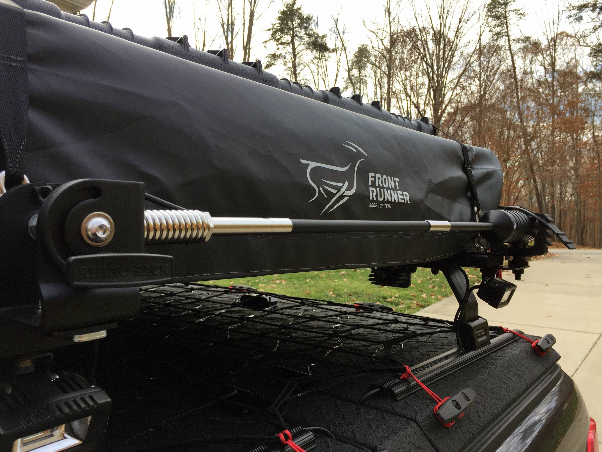

Nice overcast weather...rain coming...updated pics...:cool:
