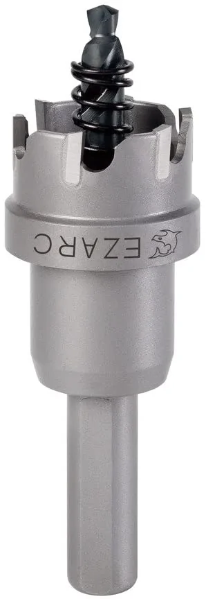

There we go...finally finished the rocker lights...boring 3/4" holes through the steps with carbide tipped cutter was a nail biter...after that, the black light rings were RTV'd to the steps and set over night...took another 4 hours running cables from tail lamp harness to each LED going forward on each side...?
Two for...reflecting off door panels doubles the effect...really helps light up the entry when opened at night...

Hi Sid,
What was the nail biter? Too big a drill bit? Tough drilling due to alloy metal used?

Hi Sid,
Hi Phil...the carbide bit I used did the job on the first two holes but one by one, the tips started to catch causing abrupt sudden yank on on the drill (and me o_O) ...ultimately, a few carbide tips broke off near the end of the sixth hole...I used plenty of lubricant during the process...probably not an issue if I could've worked with a drill press but not the case here...the 1/8" steel Shrock used is pretty hard...
