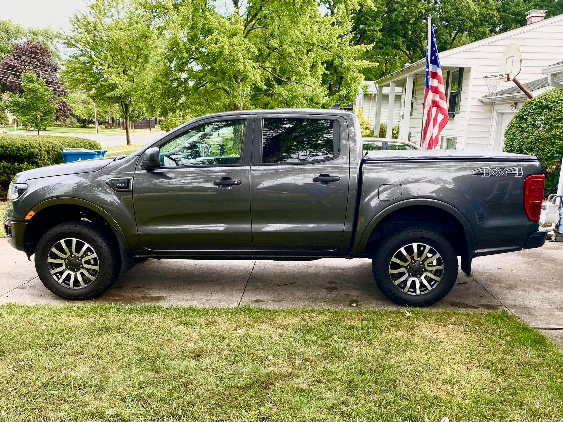

I really need to get a bigger tire. 2" level and a stock tire, considering a 275-65-18. Might be my Christmas present to myself....

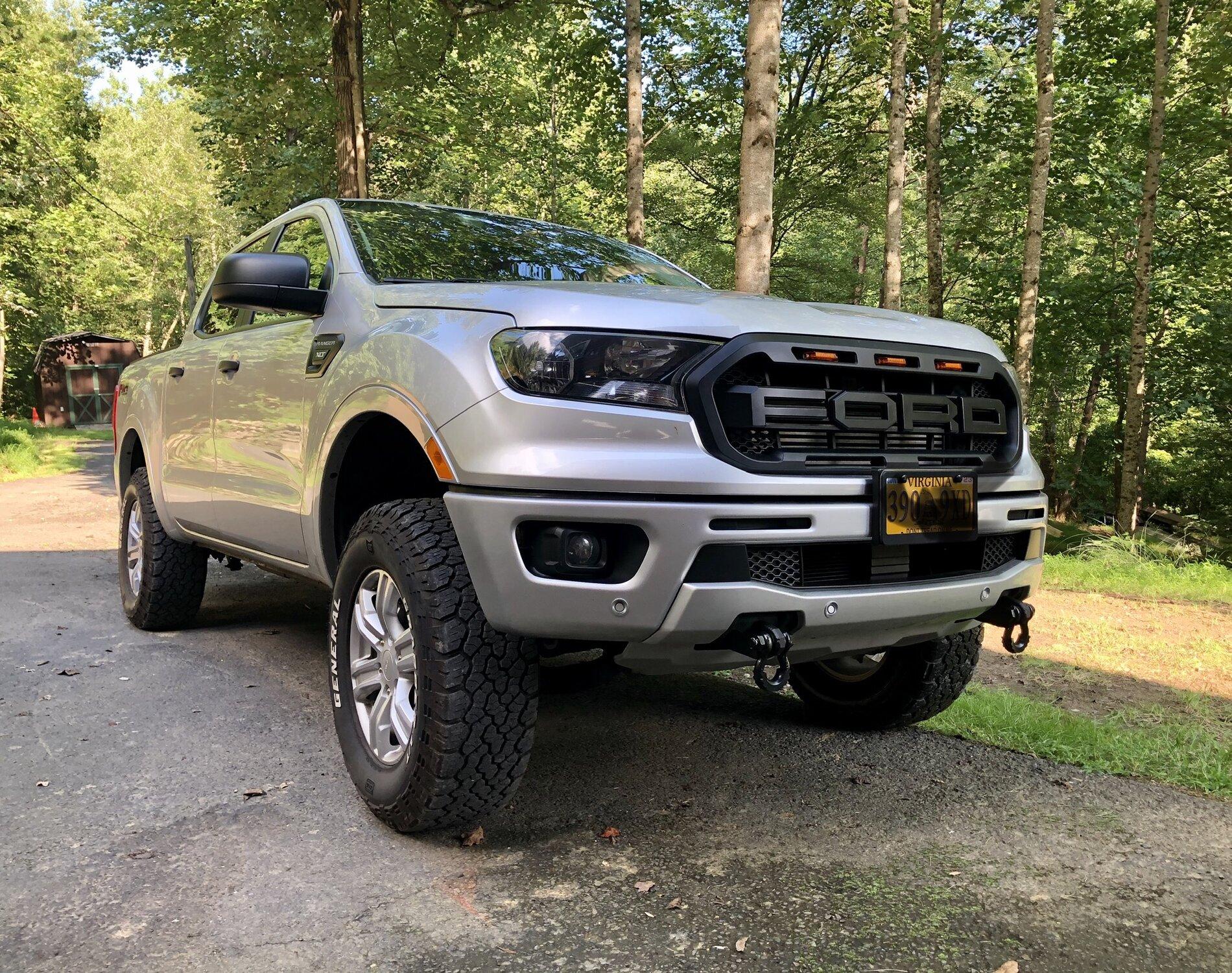

Here's a side by side photo of stock tires vs 265/70R17. It fills in that wheel gap so much better IMO.
Wow! You wouldn’t think it Would make much difference but it really does. The one on right looks perfect and it makes the stock look almost silly tbh.

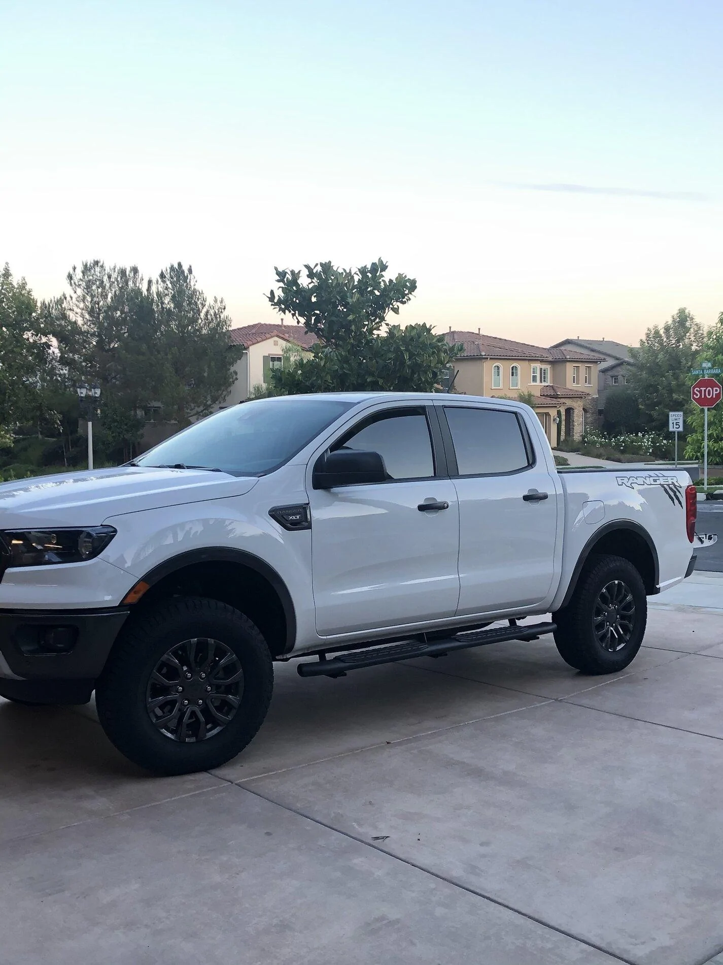

I want to upgrade my stock tires 255/65/17 and have the XLT 4X4 and have only done the 2inch front level kit. Is it best to do 255/70/17 or will the 265/70/17 work without any needed modifications? thanks for suggestions...the stock tires look so small....
A 265/70R17 works real well on the stock 17" wheel with a front 2" lift. No issues at all and plenty of clearance.
