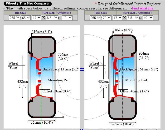

Is there a big difference from 265/70-17 and 265/65-17 (Hankook-factory)? My Ranger was ordered with the latter and there was no interference issues at stock height. They're for sale BTW:wink:
There's a 1" in diameter difference (30.6"-31.6") and the width is the same.
https://tiresize.com/comparison/

OEM size is a 30.5" OD tire and 265/70R17 is a 31.6" OD tire.
In the massive "Biggest tires, no lift" thread, it's been pretty well established that 265/70R17 is the biggest you can safely go without any mods whatsoever. The two caveats are going 255/75R17 (skinnier and taller) or removing crash bars. The skinnier and taller tire is a great option, but your tire choices are limited as it's not a common size (and also more expensive).
There's about a 1" difference in outside diameter between the two. Which will raise the truck about .5". Apparently the 265/70/17 works fine on stock suspension.
They’re only an inch taller.

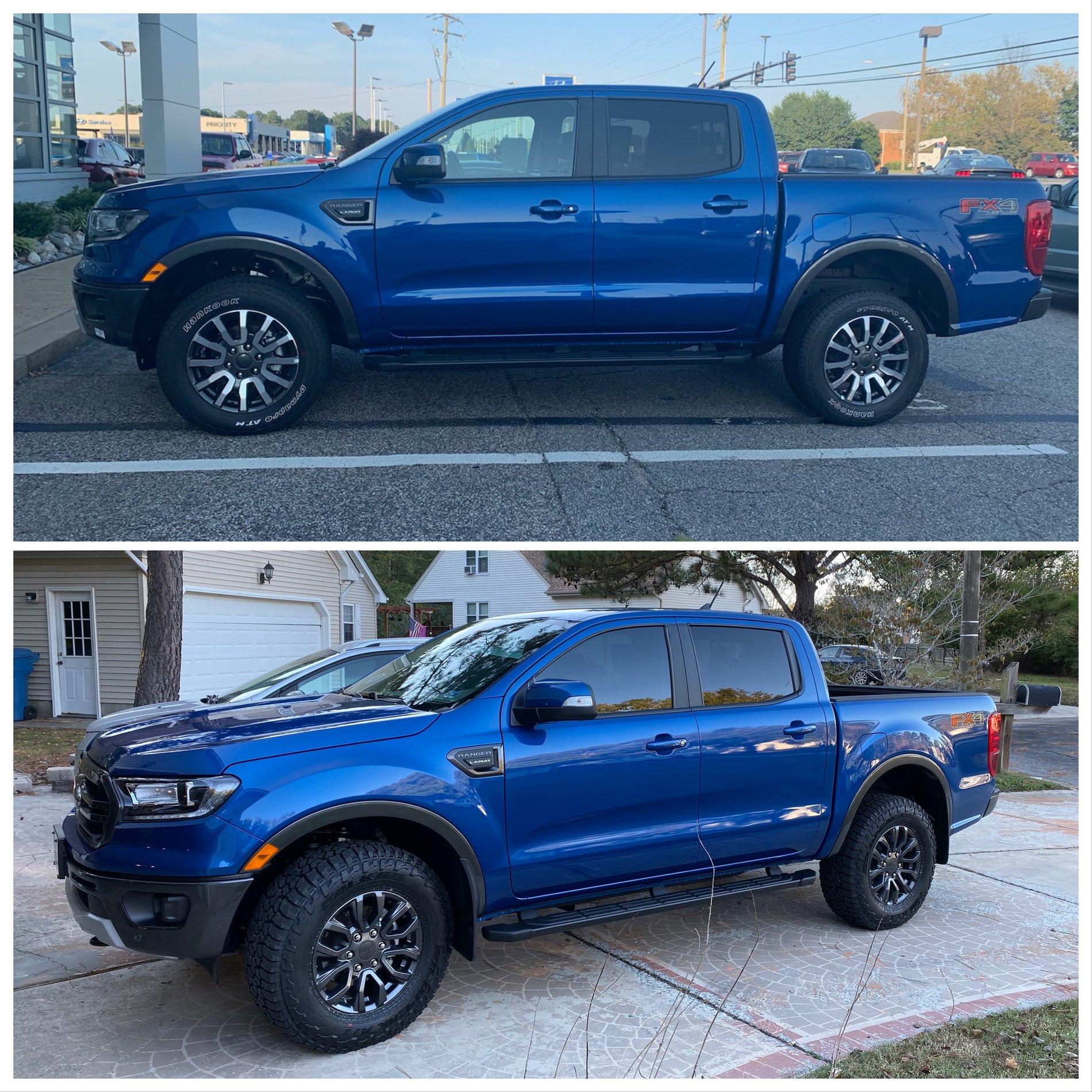

Upgraded to 265/70/17 Falken Wildpeak.
Oh yeah, that's definitely the right size for these trucks. That OD fills out the wells perfectly at stock height and I think it will look awesome with a level kit as well.
