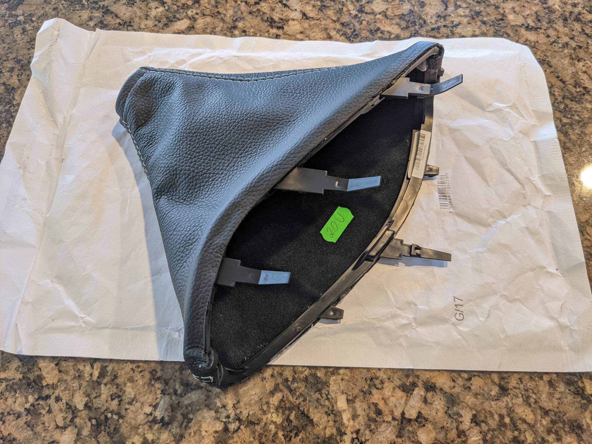

Did you install this yet, why do you need glue? The website says "very easy to install." Using glue is not what I would call very easy.
I glued it up and it is curing now. Redline only makes the leather portion of the boot that replaces the factory pleather. You need to remove the pleather from the plastic retaining ring then glue the new leather boot back on. Removing it was very easy I used a bic pen cap to slide between the plastic and pleather to separate the two. Gluing is definitely something you want three hands for, but i was able to do it by my self. Not sure i would call it easy but it certainly wasn't difficult either. I fit it up without glue first and made some marks so i had an idea of where i should aim to line it up. All in all not bad and I'm excited to get it on the truck once it is cured.

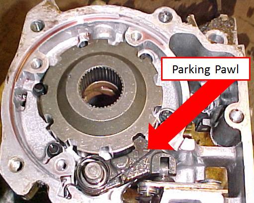

Never been one to use parking brake on automatic vehicles but always did on manual. Probably should to make sure it works.
I use it everywhere except in my level garage. Mostly because it eases stress on the transmission avoiding torque lock; where the vehicle rolls slightly forward or backward jamming the parking pawl tight against the gear.
And a gut feeling that it might slow down a thief for a couple seconds or more to release the parking brake.
This is all that's holding your 4500lb truck in place on a hill:
FWIW, I was taught by my mechanic father-in-law to always use the parking brake on manual transmissions (for obvious safety reasons).
His opinion on automatics was, either always use it or always don't. His logic was that the parking brake cable was the weakest point. If you choose to exercise that cable on a regular basis, you should not have any issues. But if you never used the parking brake (ie years), and then decide to use it that one time, it's usually that one time when the cable breaks from the lack of use (not stretched, seized, rusted, etc.) Any parking brakes he repaired were usually on vehicles where the owner had not used it on a regular basis. I personally use it when on any incline/decline just as habit.
As far as the parking pawl...it's a hit or miss. Sounds like the manufacturing of that piece over the years has been affected by cost cutting and poor manufacturing processes like everything else.

Redline boot is on. Looks like factory and as expected much higher quality, way more flexible. This is their black regular leather and silver thread.
I love how it matches the plastic of the console so well, as if it's just one piece.
