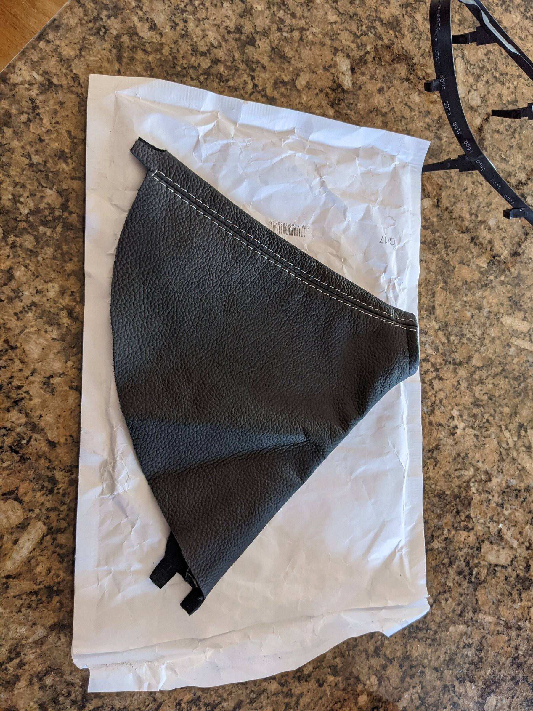

Redline boot showed up today. Will try to install it tomorrow. Any suggestions on what glue to attach it to the ABS plastic of the clip on ring bit would be welcome. Was thinking some contact cement might work but i think I'll want something that doesn't set instantly so I can make adjustments.

I used some Barge contact cement (link below) to bond some tanned deer hide to a Kydex holster. It's definitely on there !! I roughed up the Kydex with a bur (like the pic below) to give it some bite. This contact cement is highly recommended with lots of reviews....it worked for me. If the leather soaks up the first coat (mine did), just apply another coat, let it get tacky, and stick it together--just make sure it's positioned good !!!
These are Typhoon burs and are pretty aggressive and only took a few seconds to roughen the surface.

? Looks identical to the OEM boot. Guess I'll be going to the local upholstery shop for pricing today...

Did you install this yet, why do you need glue? The website says "very easy to install." Using glue is not what I would call very easy.
