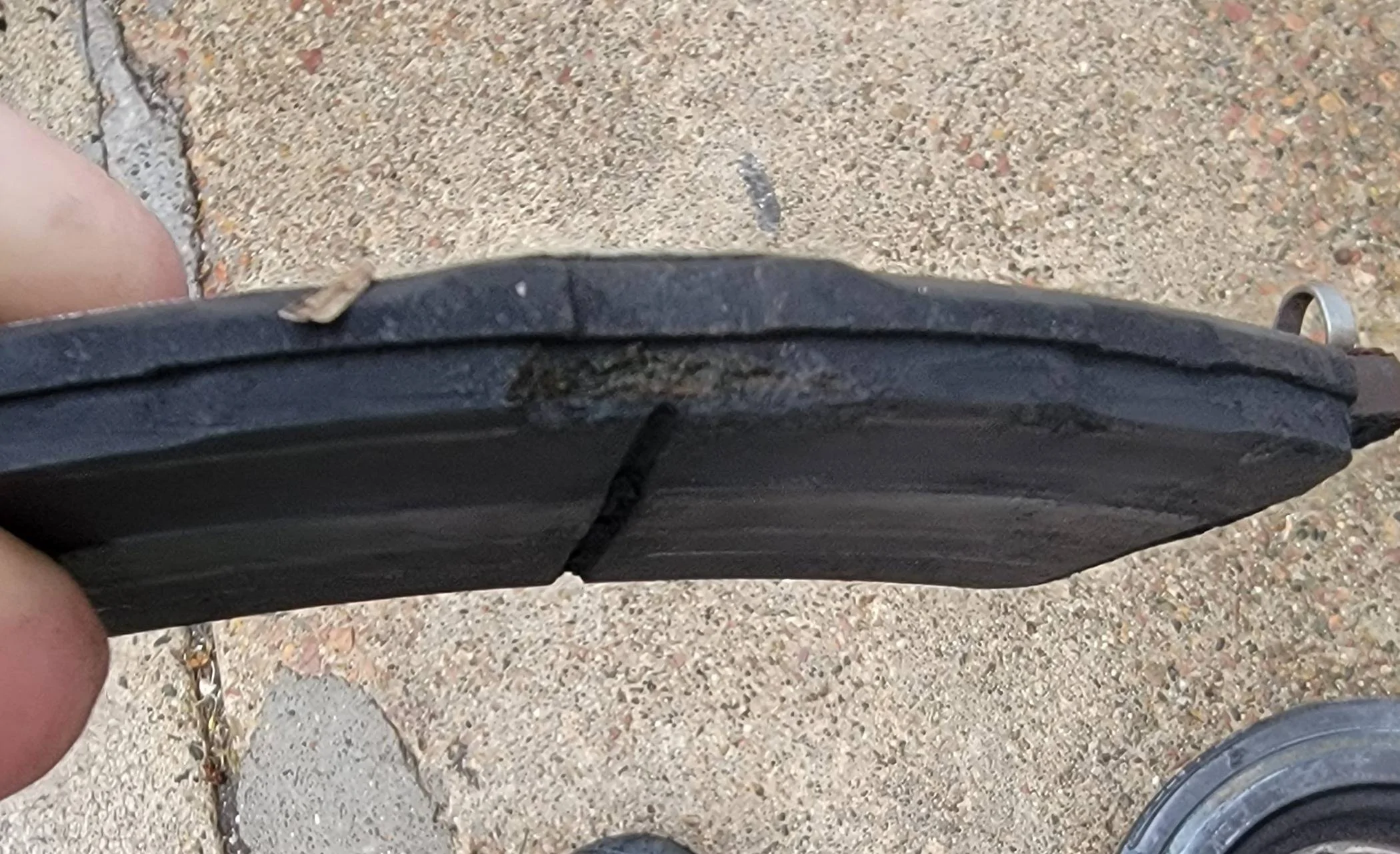

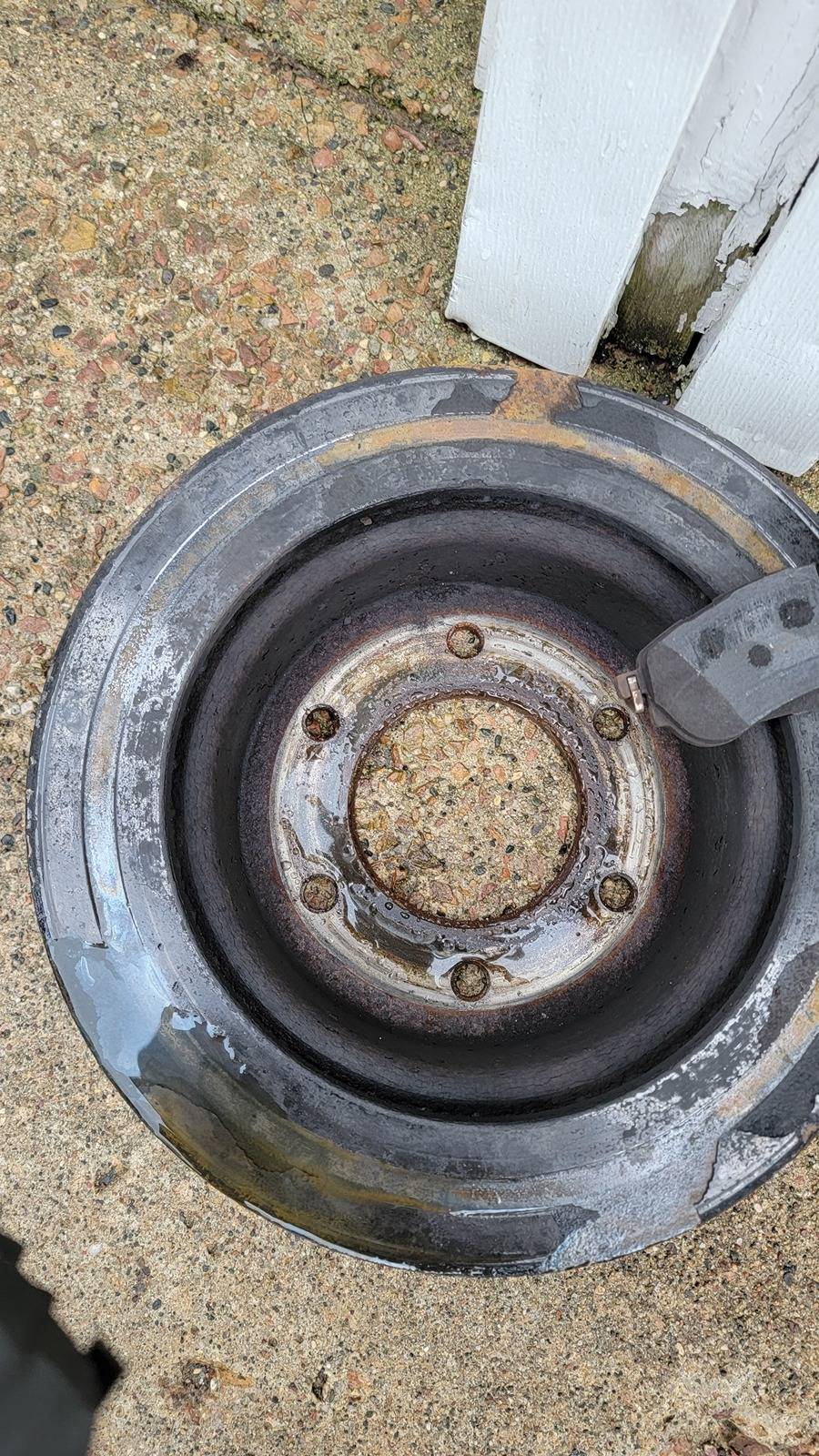

sorry im just getting back. ending up replacing the pads, calipers, and rotors. right rear break was hanging up. so it built lots of heat which of course made the other parts unhappy. and then any time i set the parking break everything was already hot. so the slightest pull on the parking break resulted in brake setting hard.
