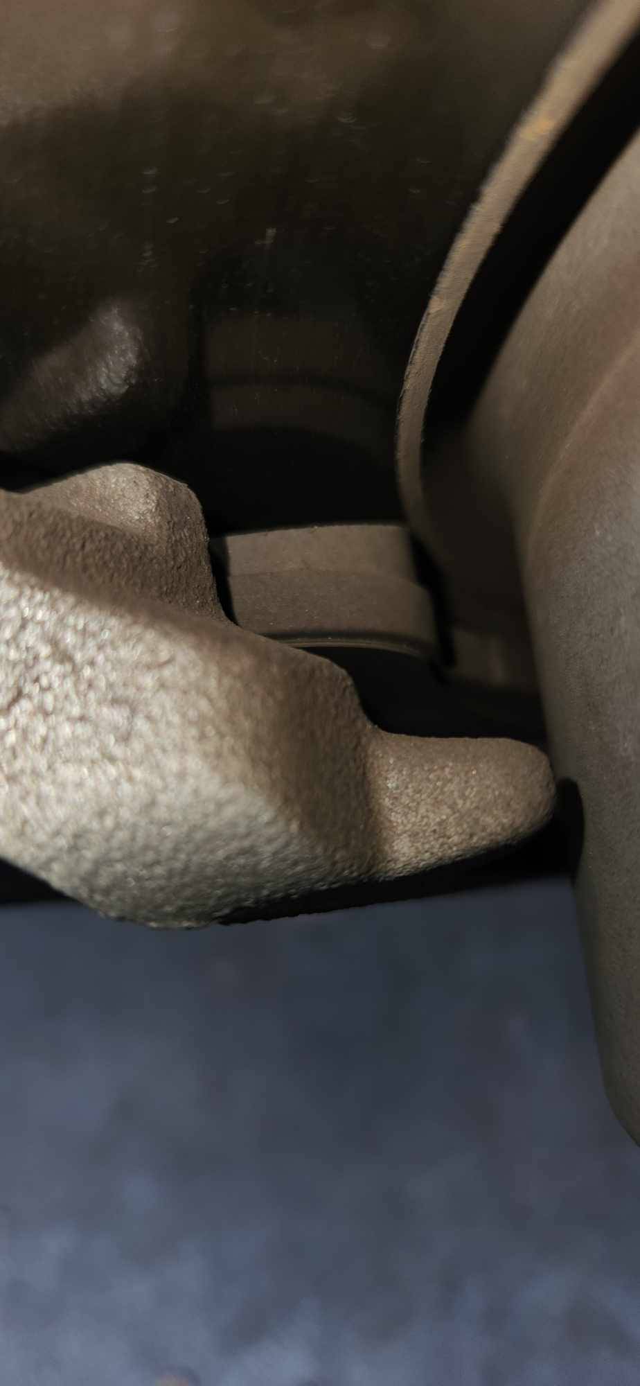

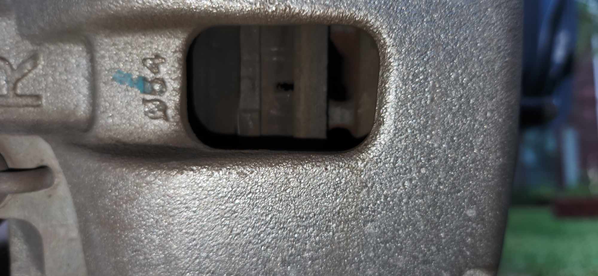

Thought about this post today when I had to throw the spare on thanks to a flat. Snapped some pictures as it got dark when the normal tire was going back on.
Just hit 27k miles. I cause the TC light to come on from time to time. Looks like plenty of pad left and no rotor wobbling going on yet.
I wonder why some are going so freaking soon? Doing more things to get the TC to use the rear more than I do. Tuned but don't exactly drive it flat out often.
wow those seem big; sorry about that.
