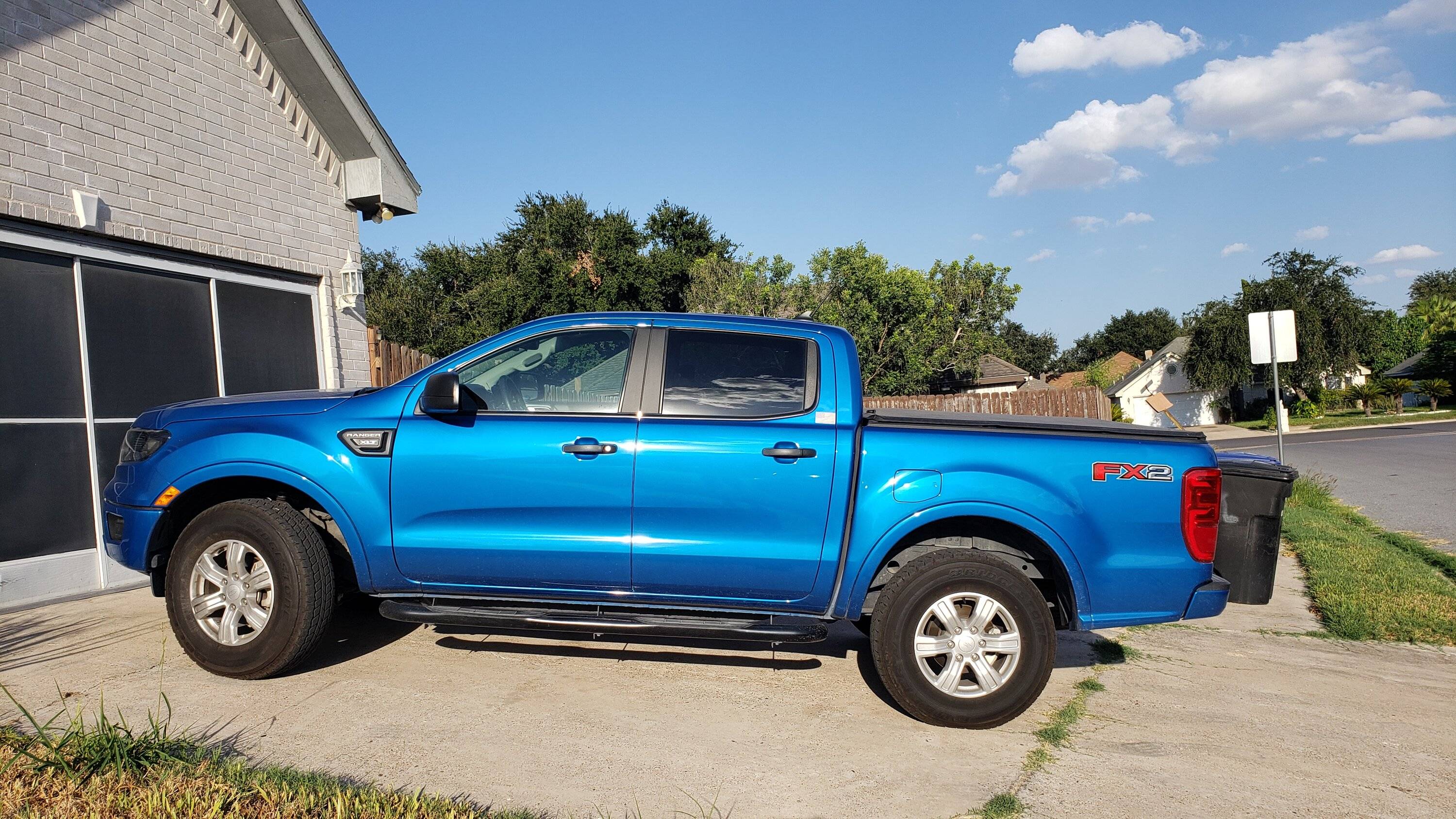

I park on this hill several times a day. I never have a problem with rear brakes.

That looks like the biggest hill in Texas. 🤣
