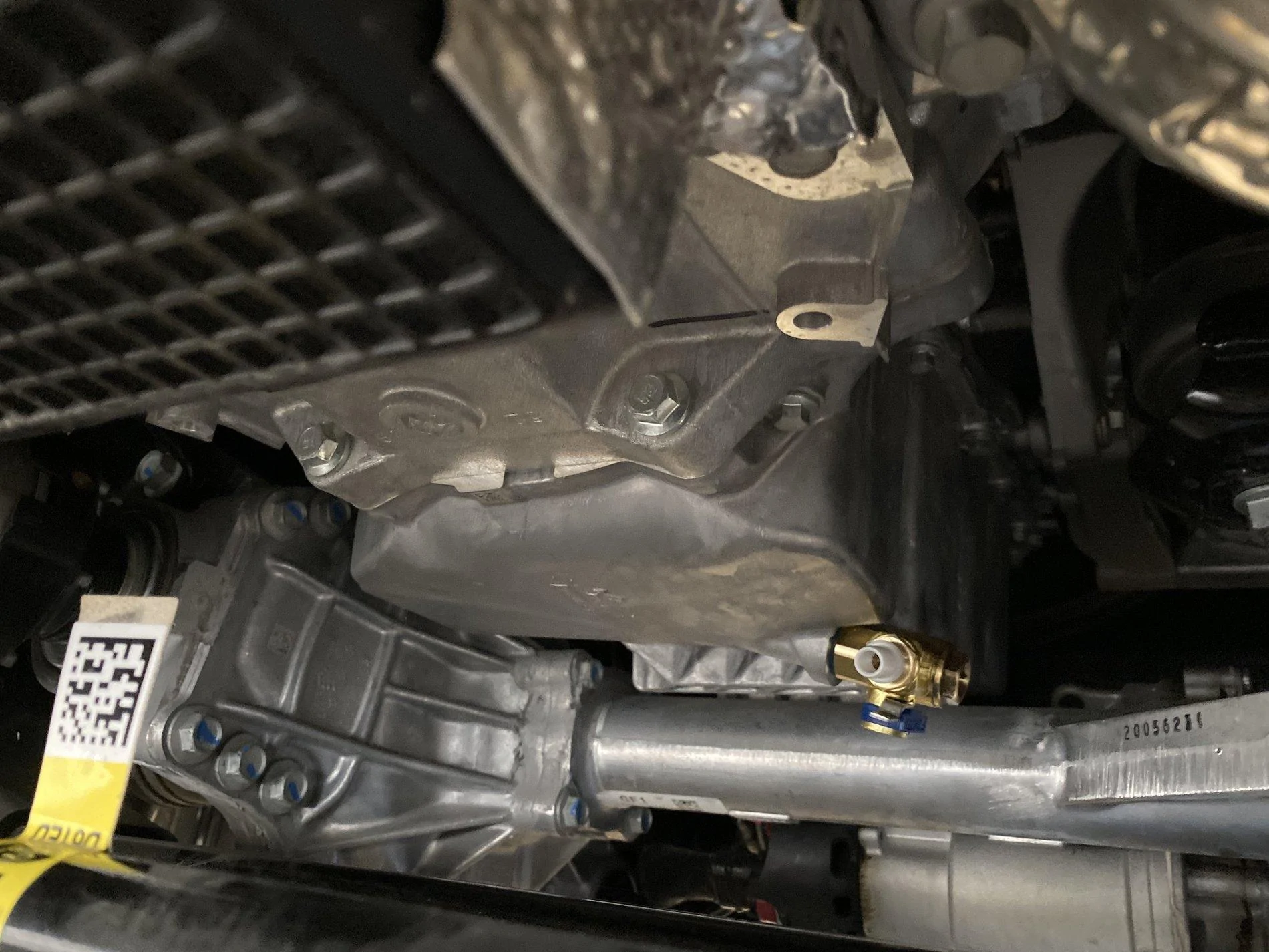

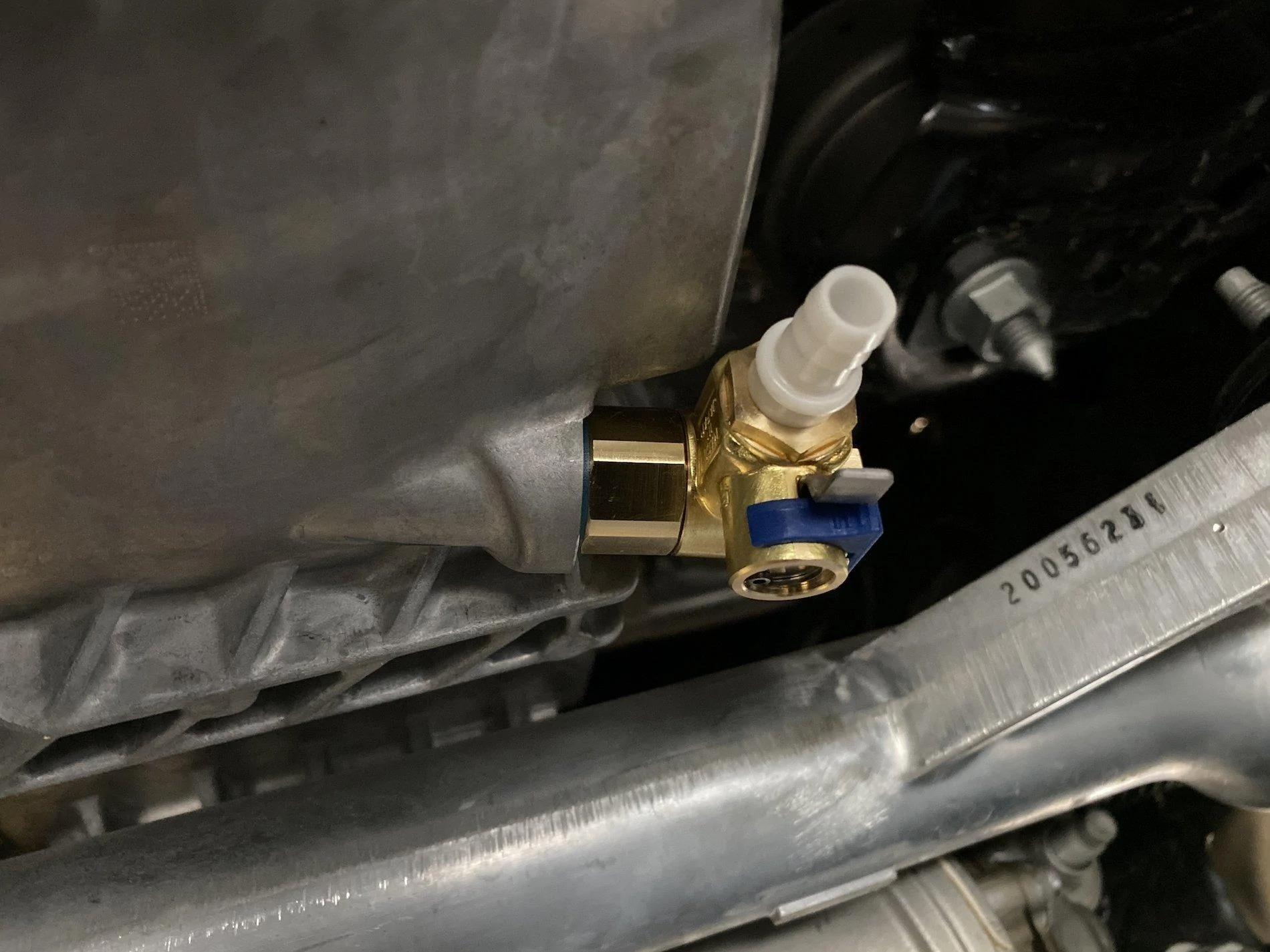

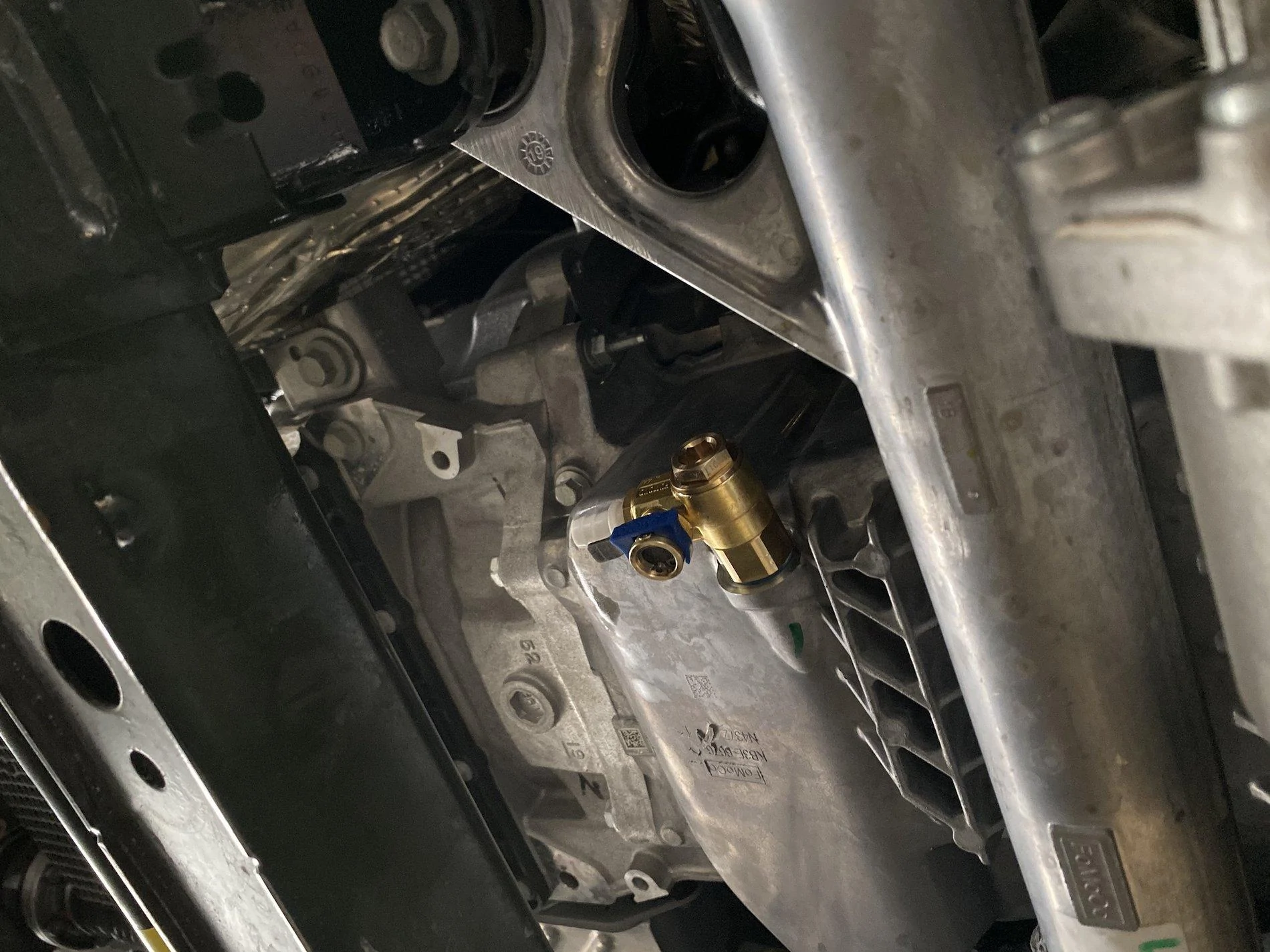

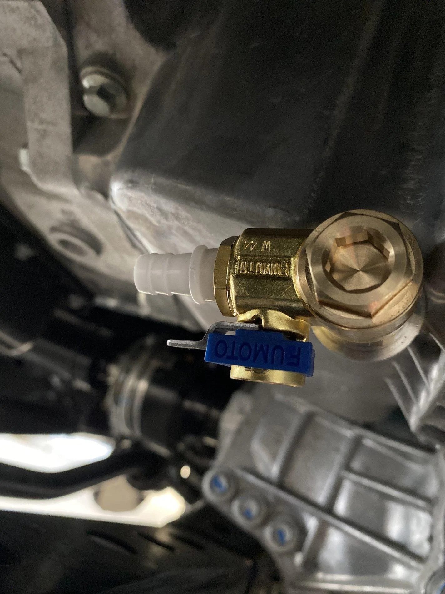

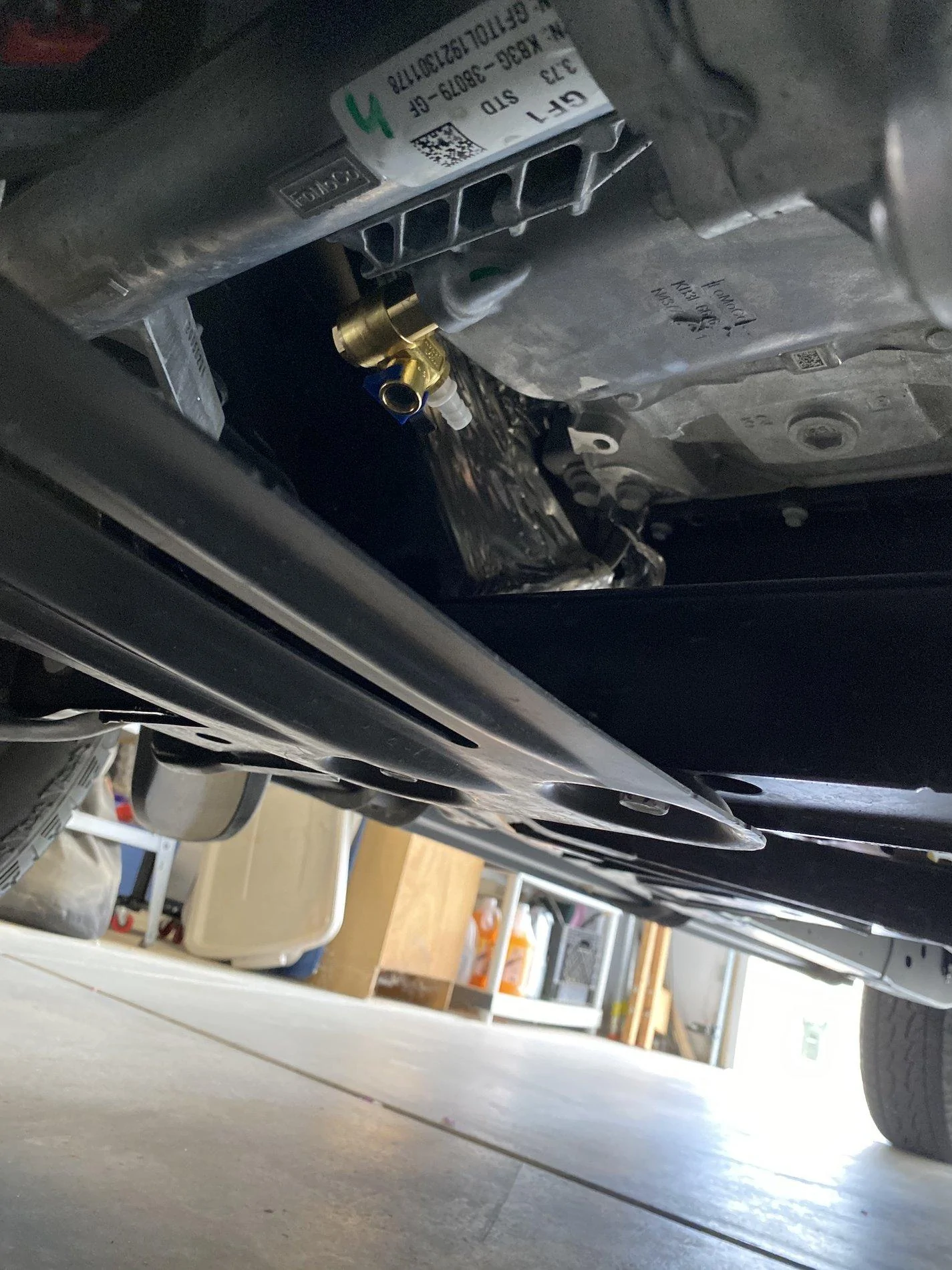

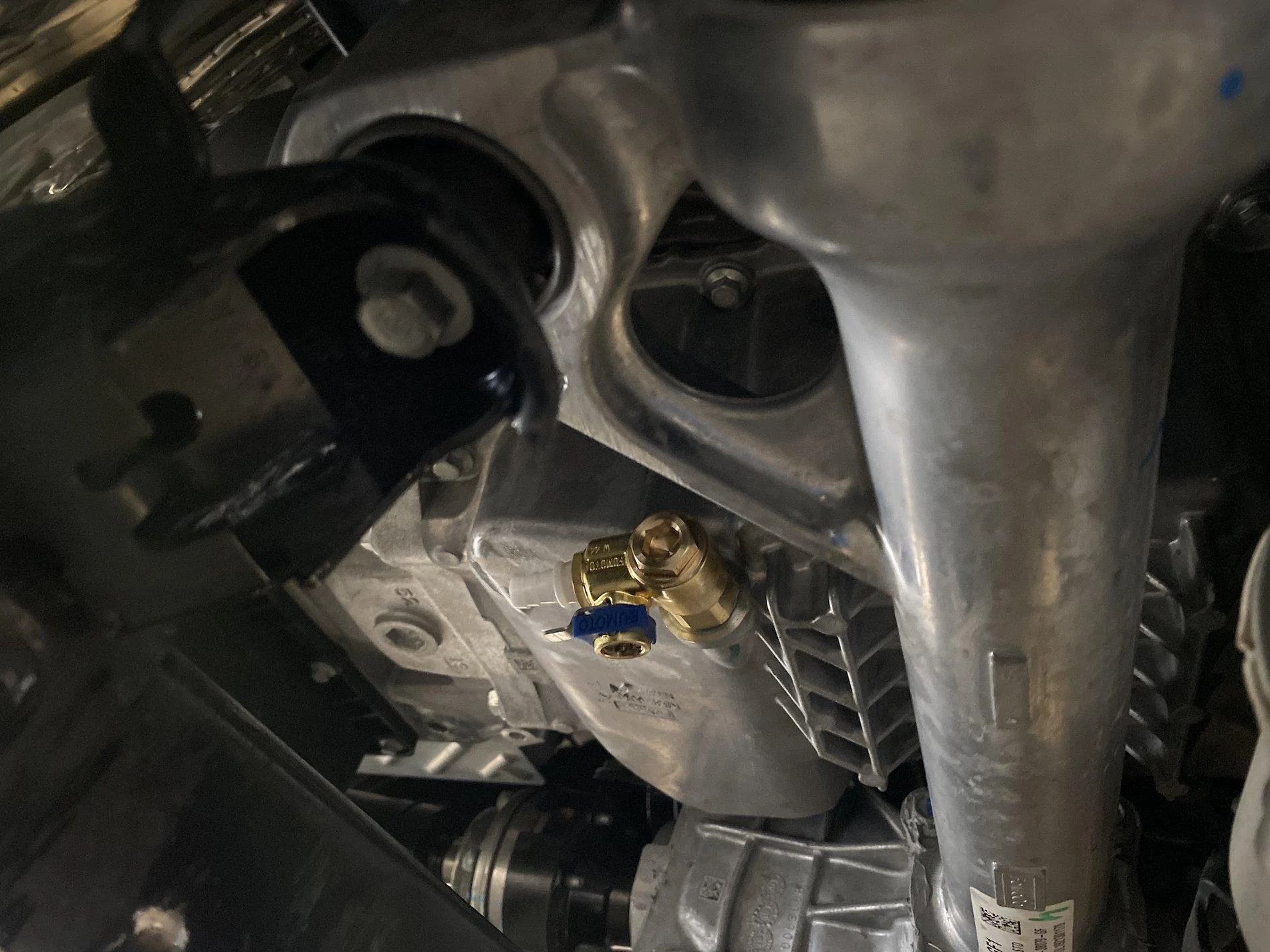

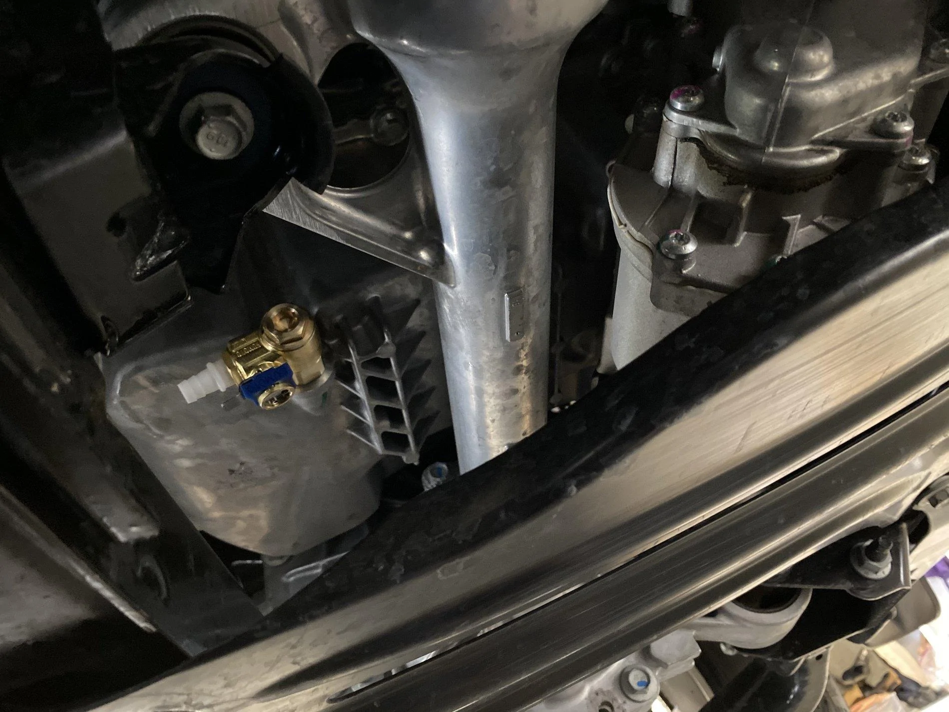

For anyone who is interested in installing a Fumoto drain valve, but confused about exactly which valve to order, whether you need the extension piece: I installed one yesterday during my first oil change, and I'm really happy with how it turned out.
First, the exact parts to order from Fumoto:
Drain Valve Model F107SX
Extension Adapter ADP-137
I also ordered the hose kit with nipples, which will make it so I don't have to remove the FX4 skid plate when doing an oil change.
The installation was easy. Be careful to follow the instructions NOT to put either the extension or the drain valve on too tightly. Snug it down, then an extra 1/4 turn is what Fumoto recommends. That is how I did mine, and there are no leaks so far. The extension came with a paper gasket that seems to be just fine. The drain valve has an integrated rubber ring gasket that also appears to seal well.
Here are some pictures of the finished install, both with and without the skid plate installed so you can see how to access it:

Thanks for the great write up and photos.
It almost looks like the F107SX could work even without the adapter in the orientation that you set it. Did you check to see if it would mate up without the adapter?

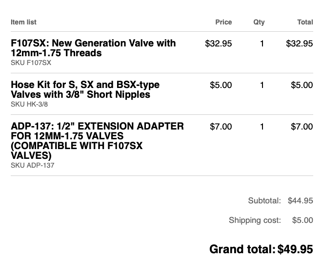

Please confirm the extension is adp 107 and not adp 137.
Please and thank you
I definitely installed the ADP 137, as I mentioned in my writeup. Here is a screenshot of my invoice:

I did not check. It *might* work, but the corners of the square body of the drain valve may actually *just barely* interfere with the fitment. I think if you wanted to install the drain valve pointing straight down it would likely fit ok without the adapter, but I wanted it pointing towards the rear of the truck on purpose so I could more easily reach up and past the skid plate to connect the hose when changing the oil.
Okay thanks. I see the 107sx and adp 107 sold as a matching kit. That's why I asked before I ordered the kit. OK, I'll locate a retailer and order separately. Good price you got from someone. Thanks again.
