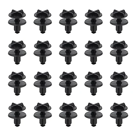

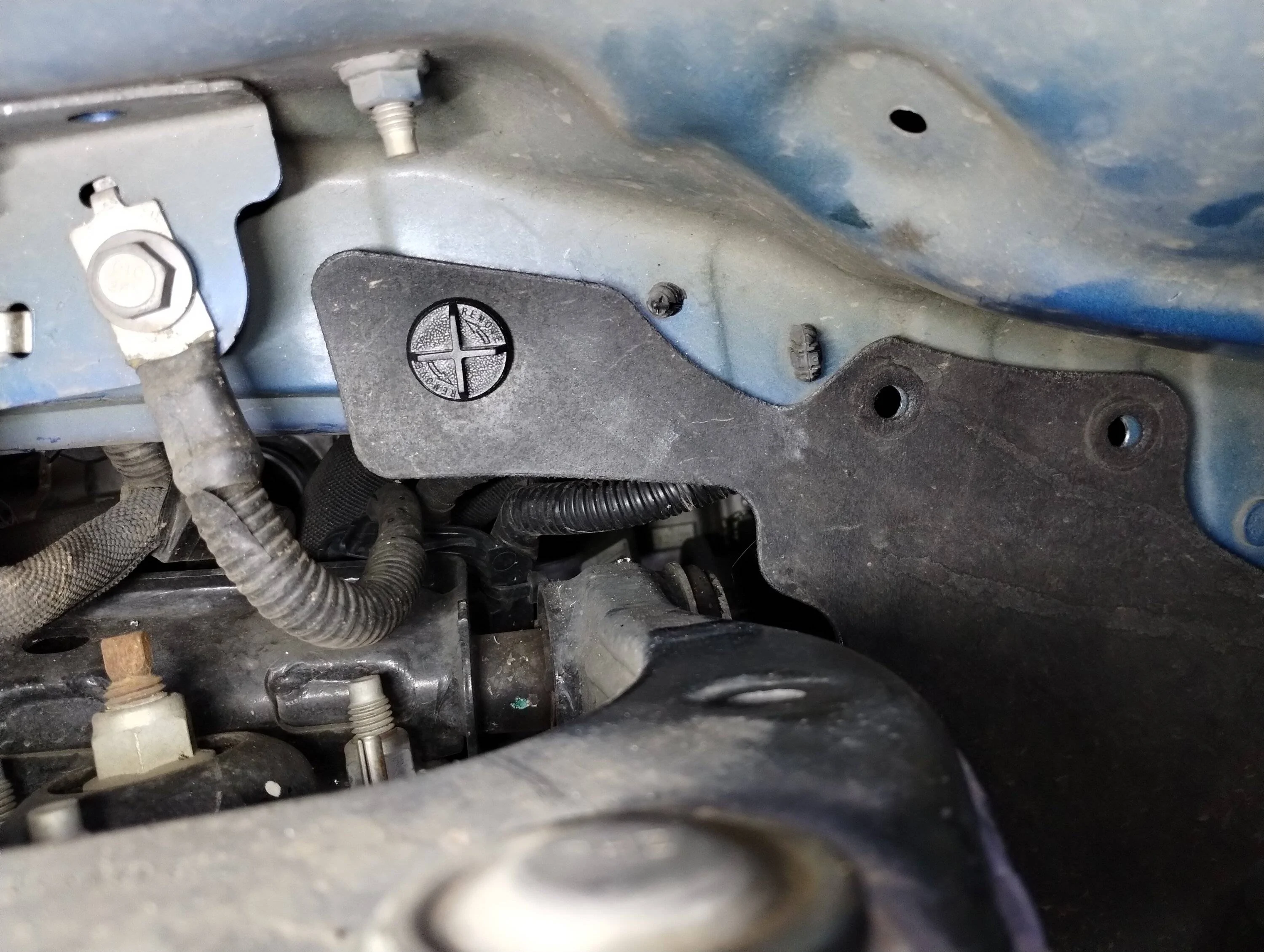

Lots of folks hate those stupid little plastic screw inserts that hold the cover on to access the oil filter, and for good reason, they suck.
If you're not opposed to opening up the 3 holes very slightly with a step drill, you can install these GM Style fasteners:
On my 2wd truck, there is nothing behind the holes to get in the way, but if you choose to go this route, double check. I'm not responsible if you chew up a wire harness. Folks in the salt belt would probably want to put a little paint on the metal afterwards, or some form of protectant.
Now it's just a simple twist to take the rubber shield off.

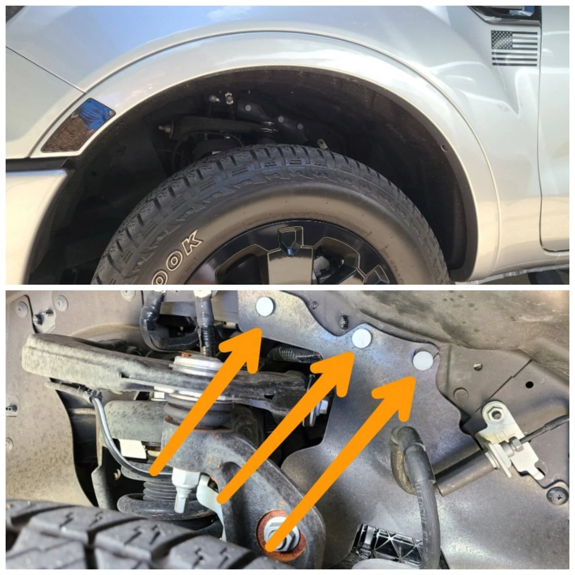

I've replaced mine with rivnuts and thumb screws. I believe Ford did this on later model years.

I just bought some 5mm x 10mm stainless thumb screws with plastic knows off of Amazon along with a cheap rivnut kit. I did have to drill the holes in the inner fender out a little to fit the nuts. If I was to do it again I'd borrow or rent a rivnut tool to set the rivnuts. Other than that it works great. The thumb screws seat against the flap and haven't come loose between oil changes.

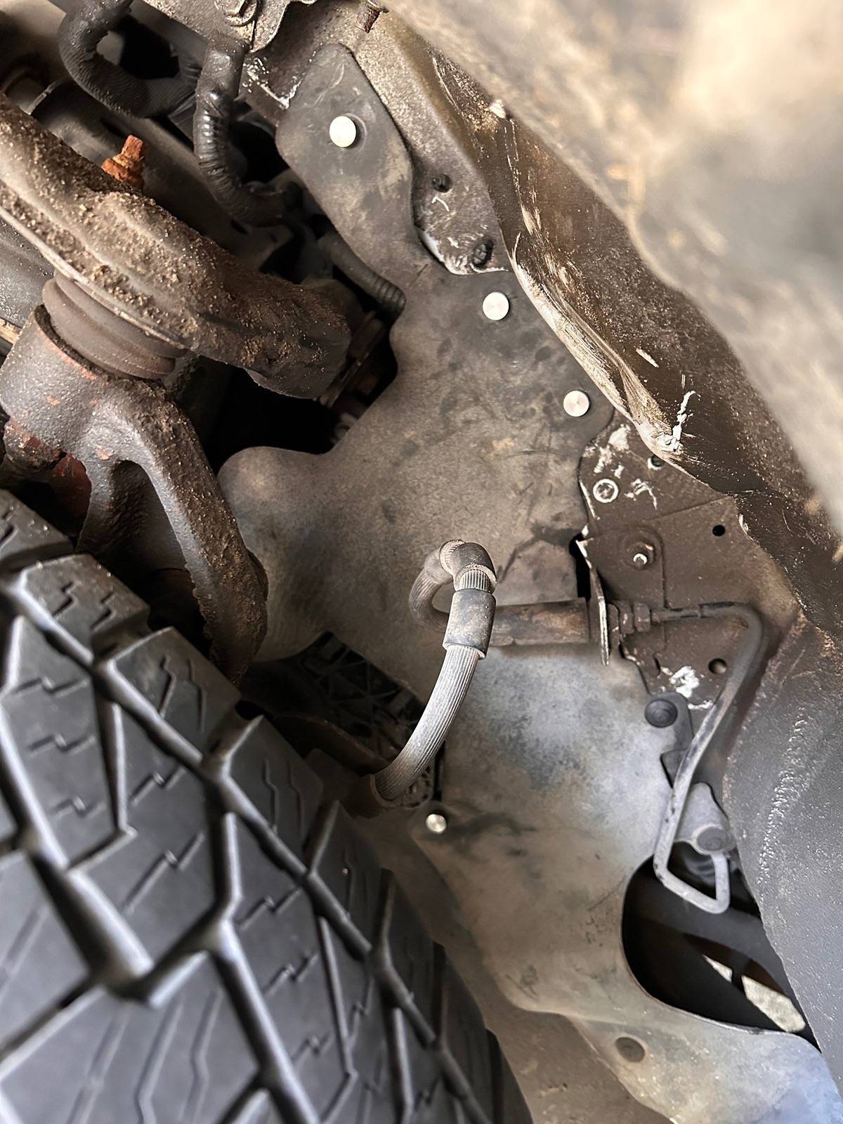

Finally installed nut inserts for oil filter access. Three at top is all that’s required for filter access. I lost the original at bottom so I installed an insert. I purchased a cheap insert tool from Amazon with SS M4x0.7 inserts. It was quicker than I thought and I didn’t have to remove the tire. The SS fasteners are M4x0.7 x 10mm long. All from Amazon.
