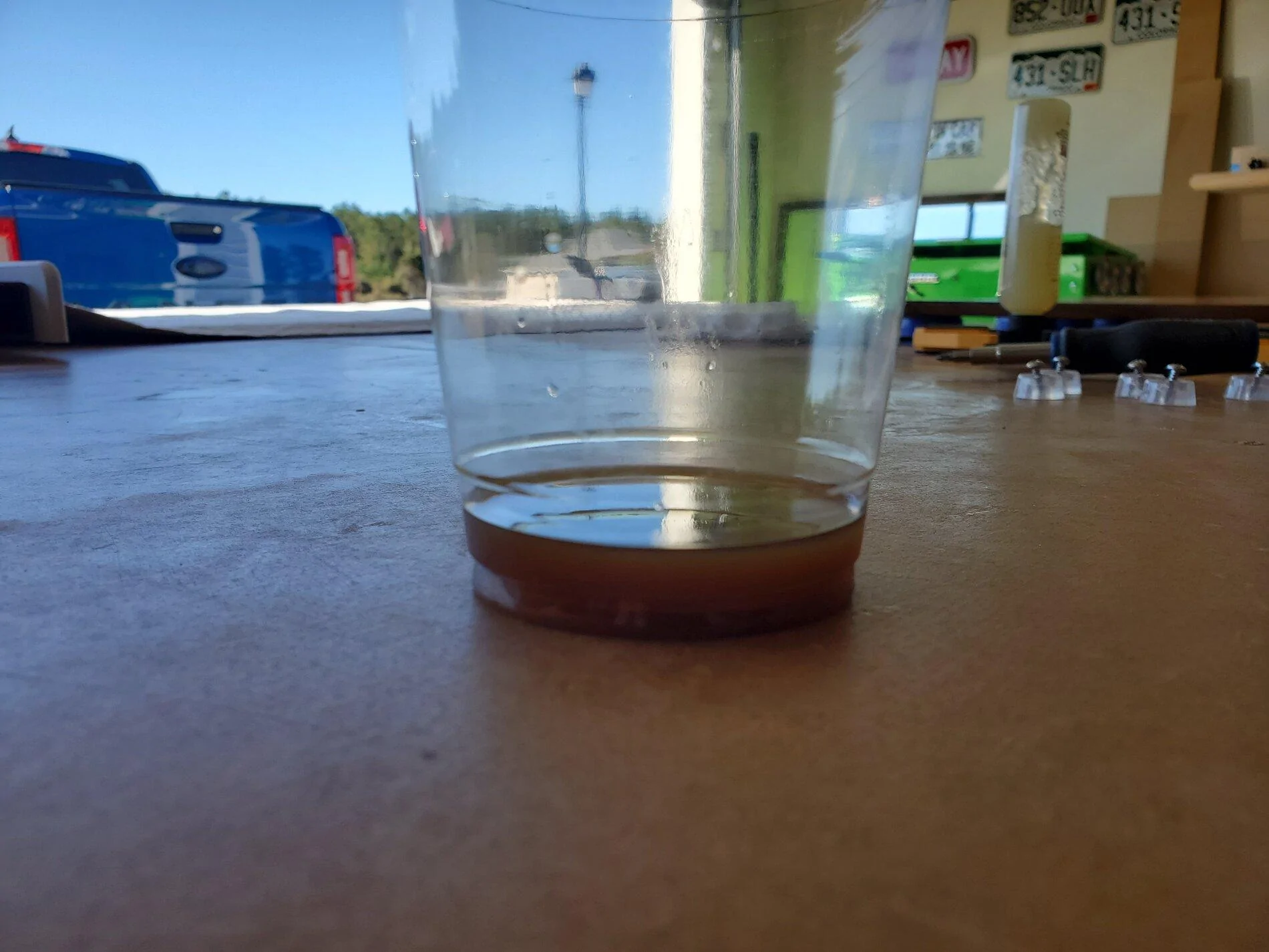

This was the amount of oil pulled out after the first 1000 miles after installing a oil catch can. Standard size solo cup for reference. Catch can was roughly half full.
I am getting about the same amount this winter every 200 or so miles. It is almost all condensation. Warm ups in the morning when it is cold and damp outside can do this quickly. I don't like to let it sit and warm up too much, but the wife likes to get in when there is some heat coming out of the vents. Lol.
I expect this to taper off to about that much every 1000 miles or so once the weather warms up and the humidity drops.

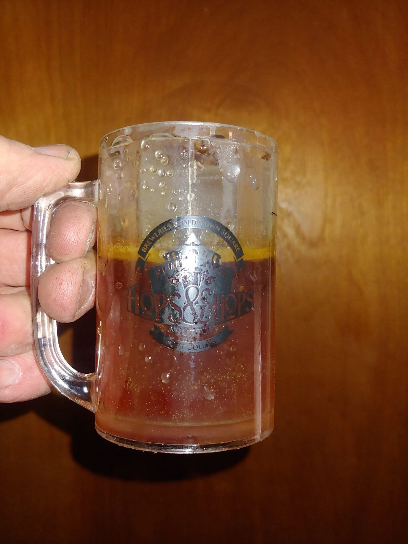

I put one on (Mishimoto). Only bad thing is I wish I now had room for a bigger one. Thus summer I might mount it differently and get an extended volume can. I am just getting condensation from the winter weather which is good, but it needs emptied at least twice a week. I have a petcock and hose, so it isn't too bad.

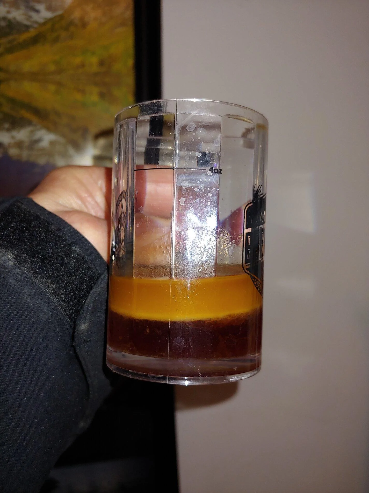

well I installed the catch can 2 weeks ago, and I have had to empty it twice already. Mostly water, its been really cold here. This might be one of the reasons that Ford didn't install a catch can. It needs to be looked after quite a bit and making somethin require more maintenance will not fly. Week 1 I drained 2+oz of water/oil mix, week 2 almost 4oz. I will keep checking it every week, as long as its cold. I am curious to see how mush it collects in warmer weather.
