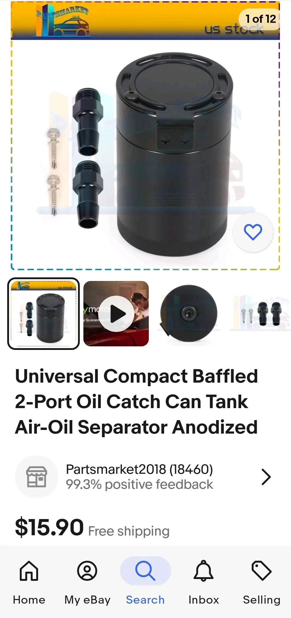

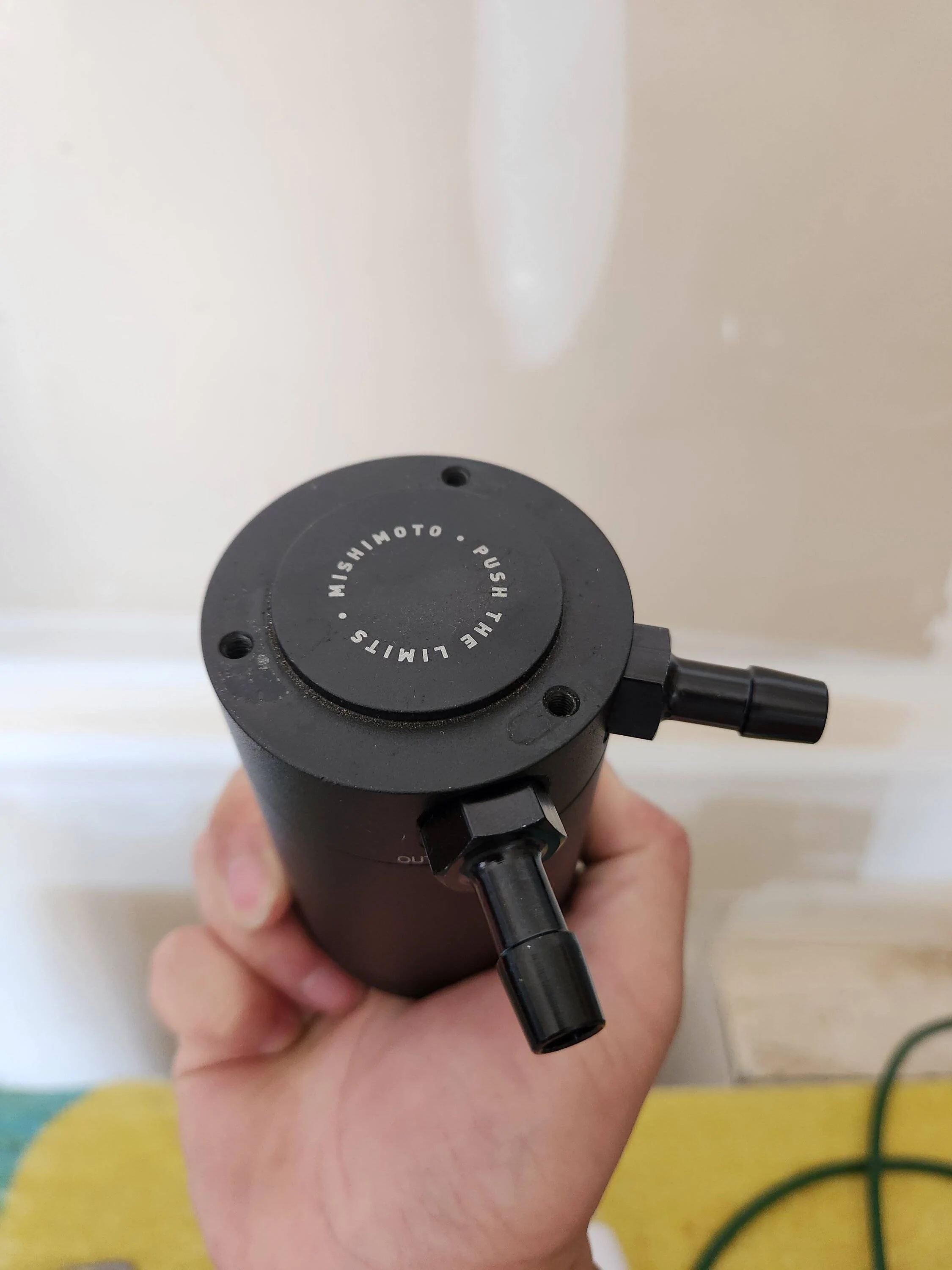

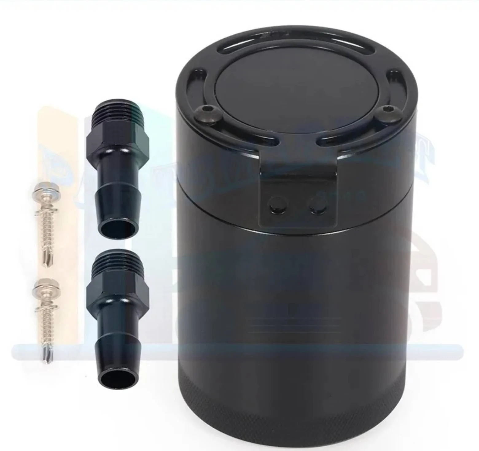

Did my oil change last weekend and I usually empty/clean out my oil catch can at the same time. I usually just unscrew the bottom of the can instead of removing the drain plug. But for some reason, I couldn't remove the bottom of the can because it's seized up. I ended up removing the whole unit to see if I can get a better grip but with no luck. I don't have a pair of channel locks that big or a bench vise. So I decided to see if I can purchase a replacement can from Mishimoto. Holy crap! That thing is expensive! So I looked at other alternatives. Wouldn't you know it, I found something similar on eBay for 15 bucks. It seems to be identical to Mishimoto's minus obviously the branding. I also purchased some hose end caps and some hose separator to clean up the installation a bit.

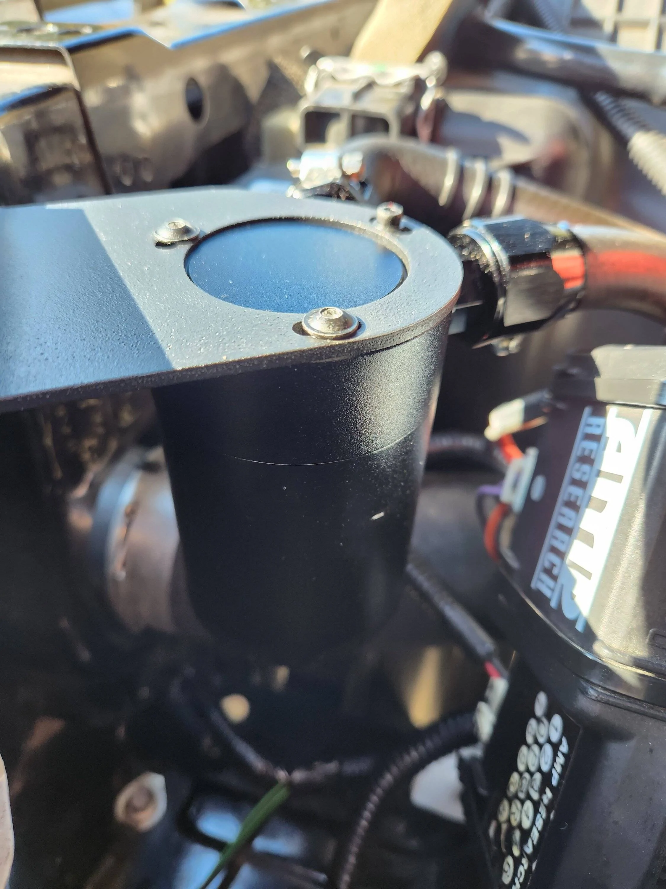

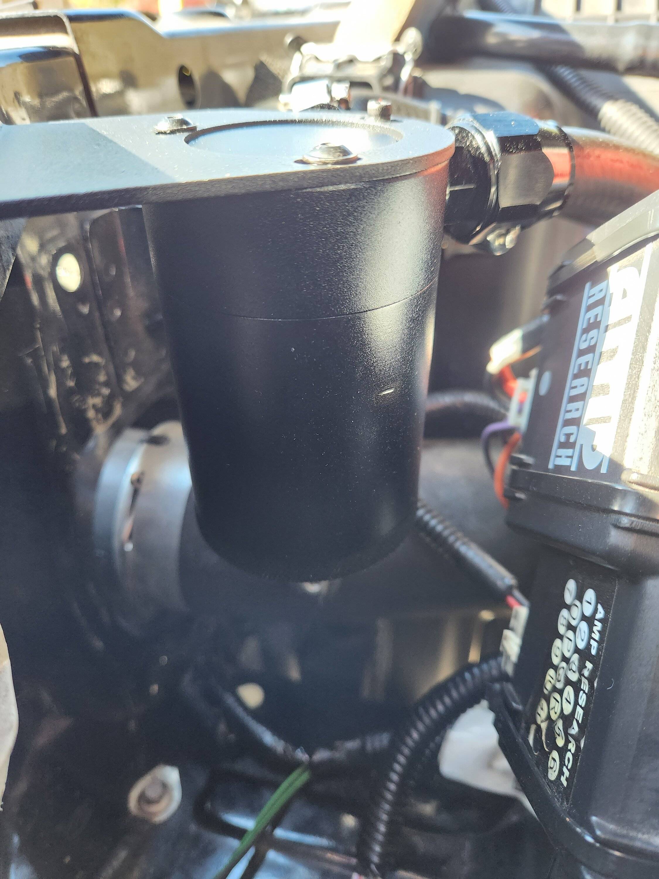

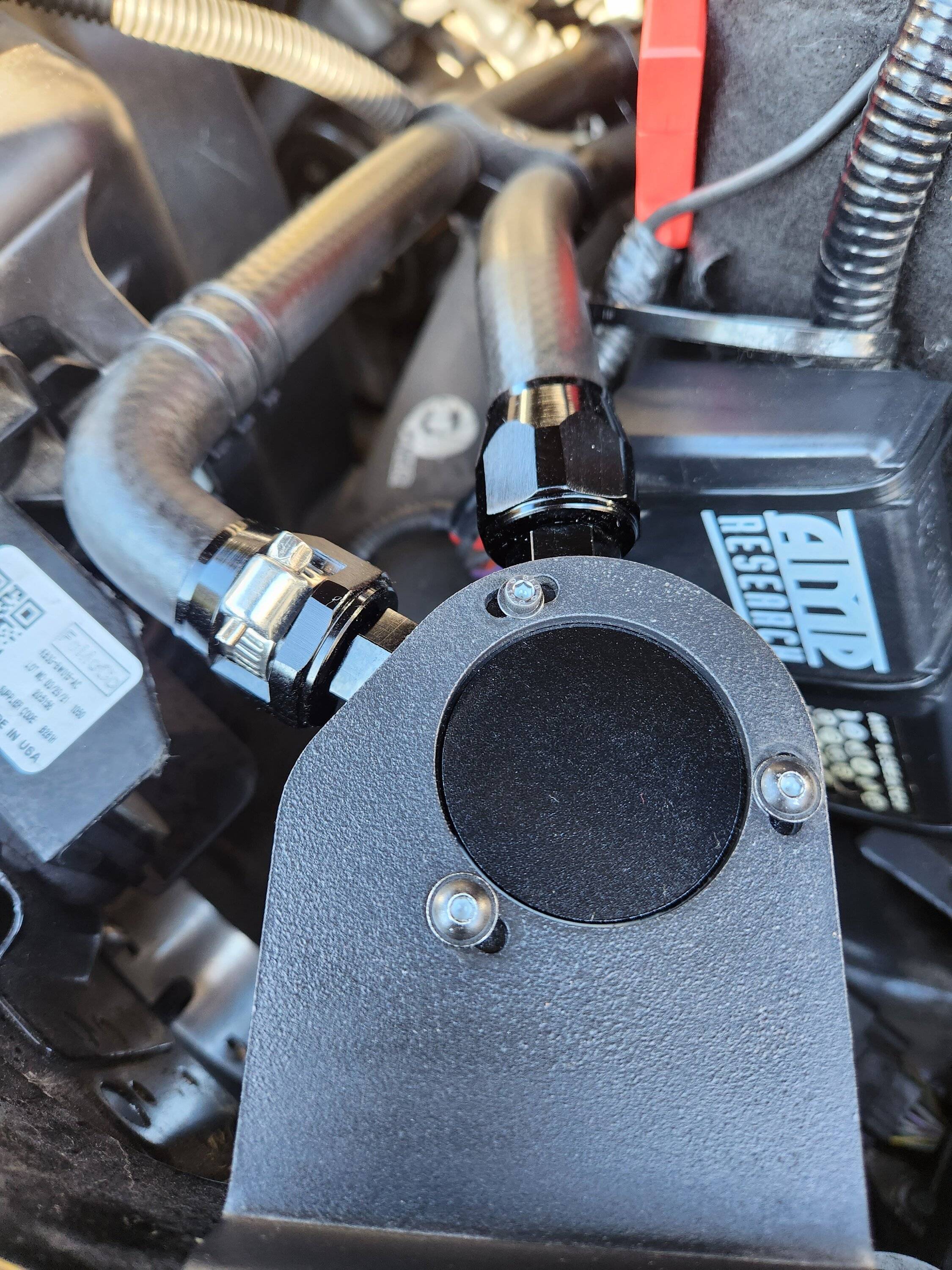

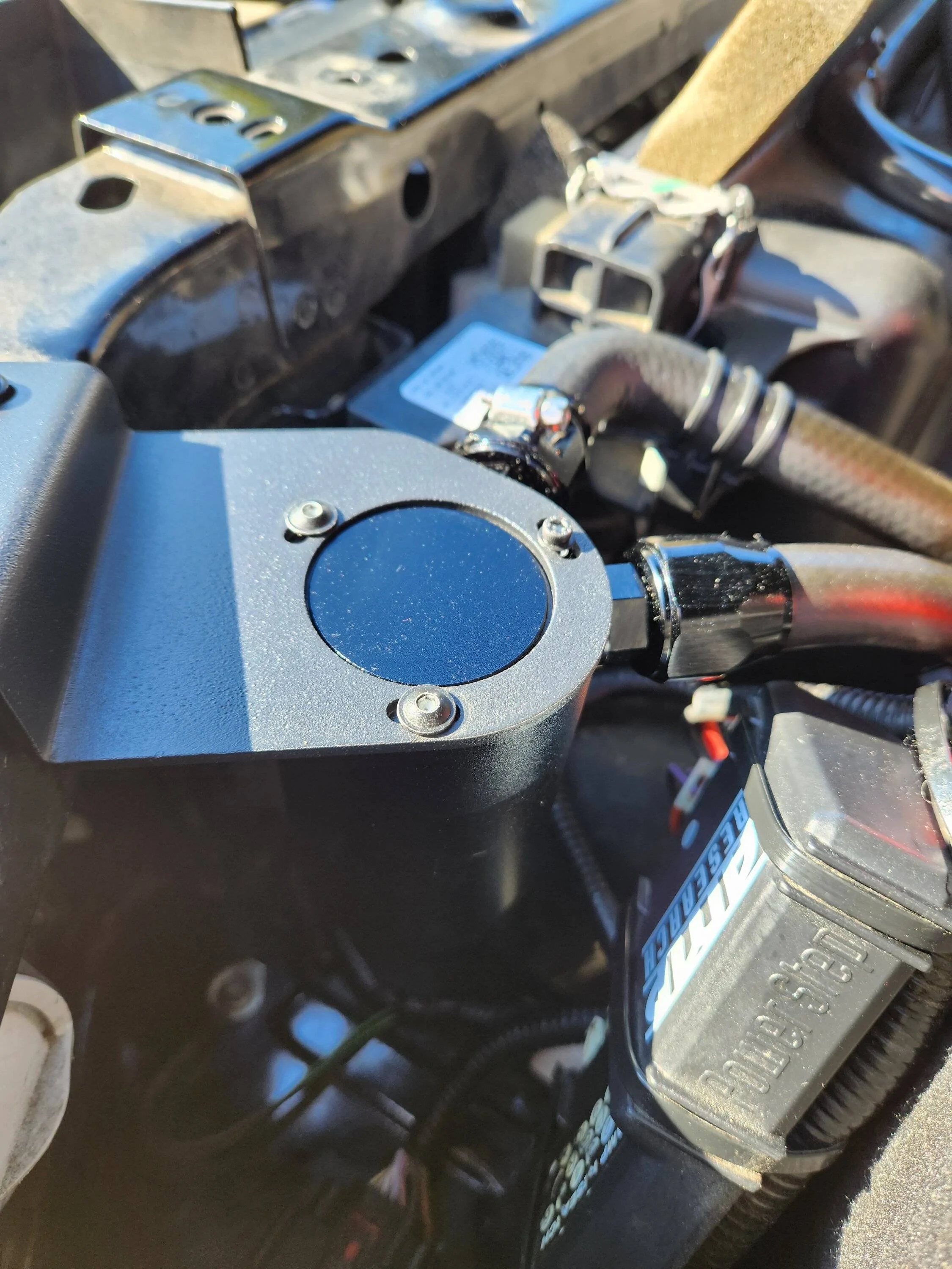

It turned out pretty good I think. I made sure to put a little anti seize on the threads this time to make sure this issue won't happen again.
Any of you guys that have this system run into this issue before?

Do you have enough space for it?
Yeah, the can stops about an inch above the silicone hose for the intercooler.
I don't have a mishimoto branded can though, just some cheap $30 from amazon.

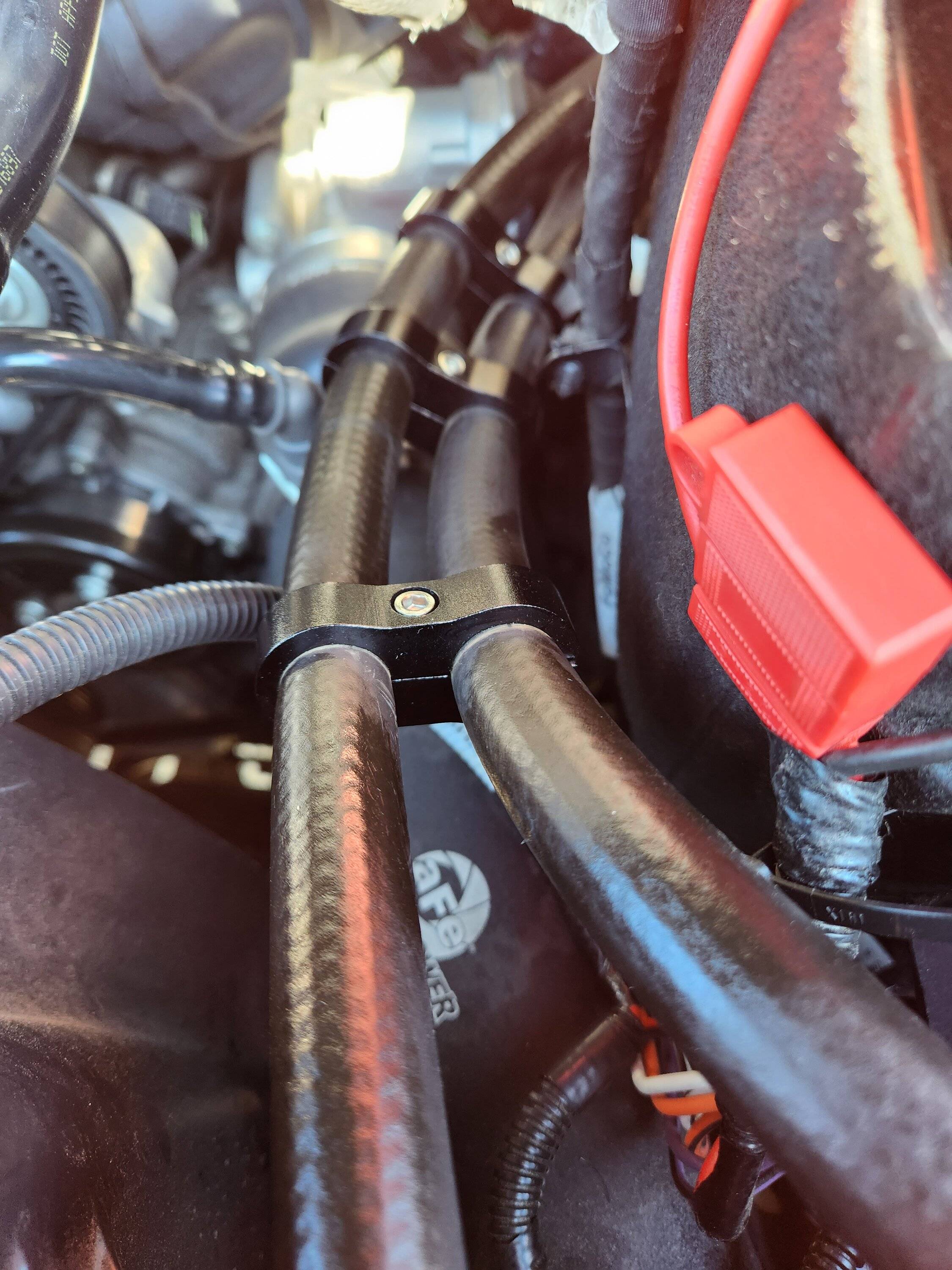

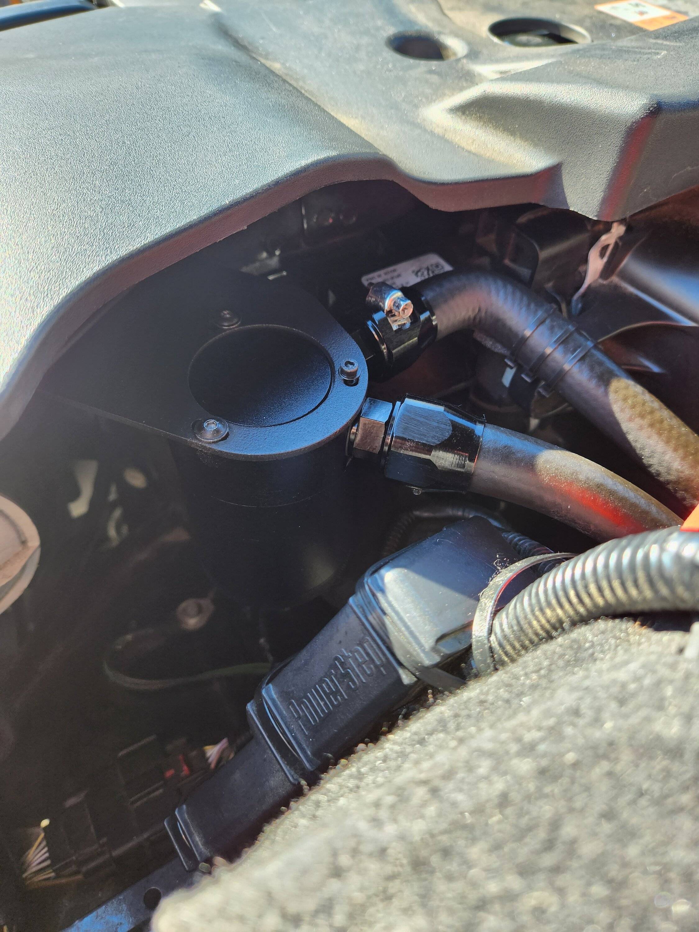

I wouldn't go and throw it away literally. Well, my faith in the brand have made me "throw it away," metaphorically speaking. It's done me well until up at this point. I did re-check the installation and re-routed the hoses and added paddings to potential areas it may vibrate on and rub a hole that can potentially cause a leak. I've added hose separators so it would rub against each other or other components. I've made sure it's clean of any substances to make sure it wouldn't prematurely deteriorate.
As far as how much oil it's capturing, its surprisingly quite a lot. Especially around this time of year that it's a bit cooler outside, it captures a lot more than usual. Enough to have a peace of mind knowing it's not going back into your intake system and gunking things up.
