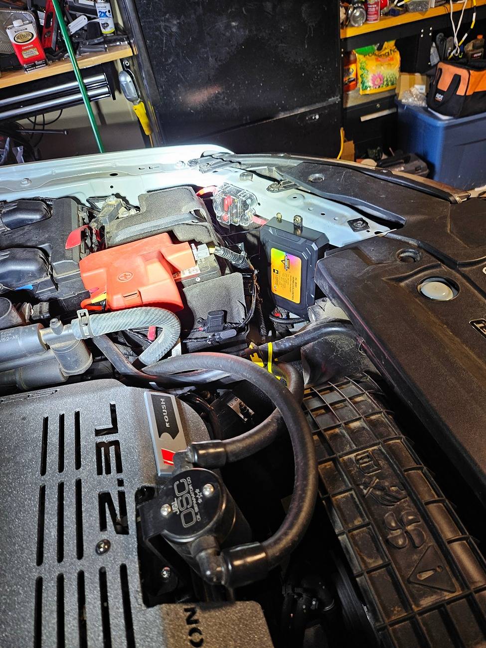

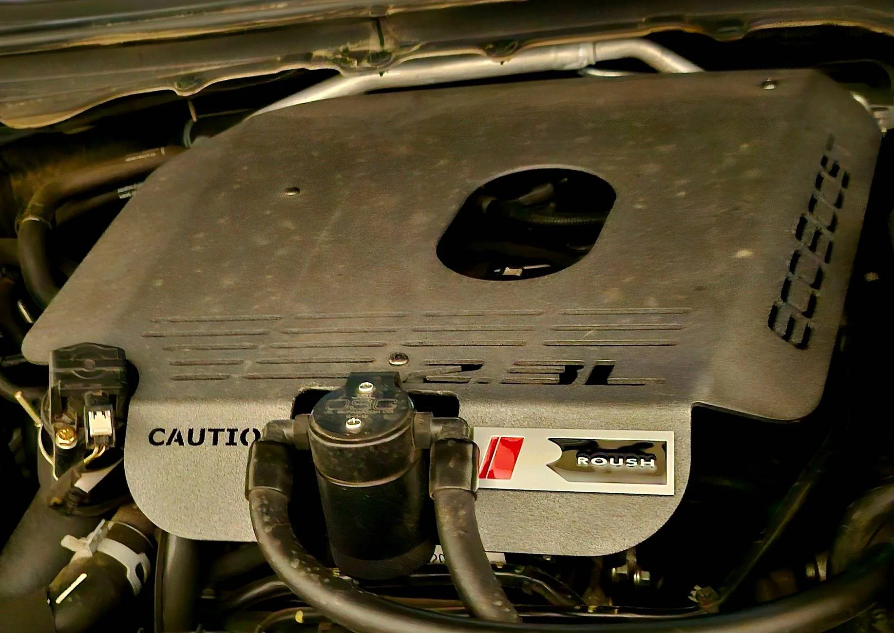

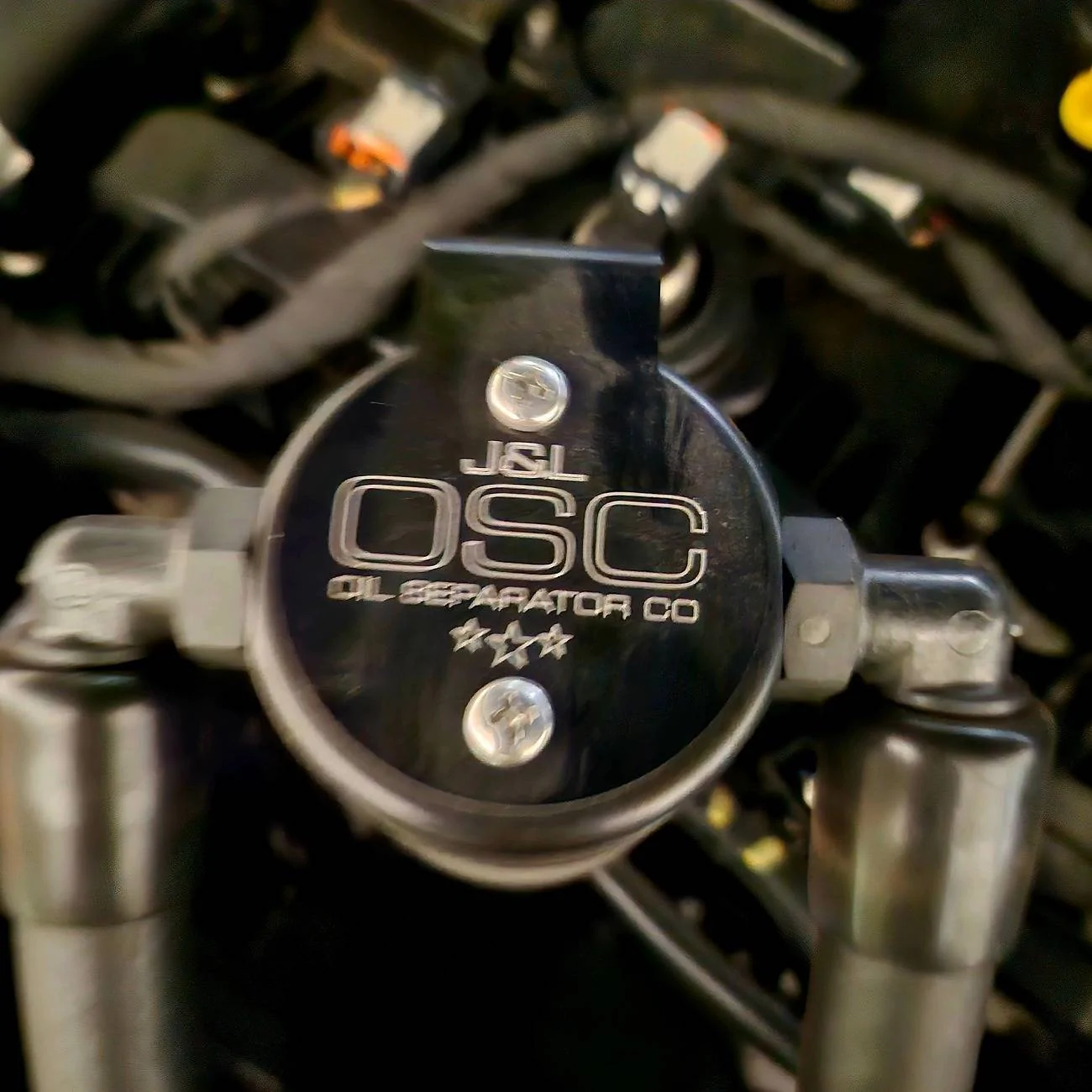

Do you have pics ?
What was the primary install issue ?
I slapped my Separator on in 10 minutes.
It took me longer to modify my engine cover.

Do you have pics ?
Yours is a 2022. The late 2021-2023 have the connection up on top of the intake making it simple to install. The others are a bear to get at.
