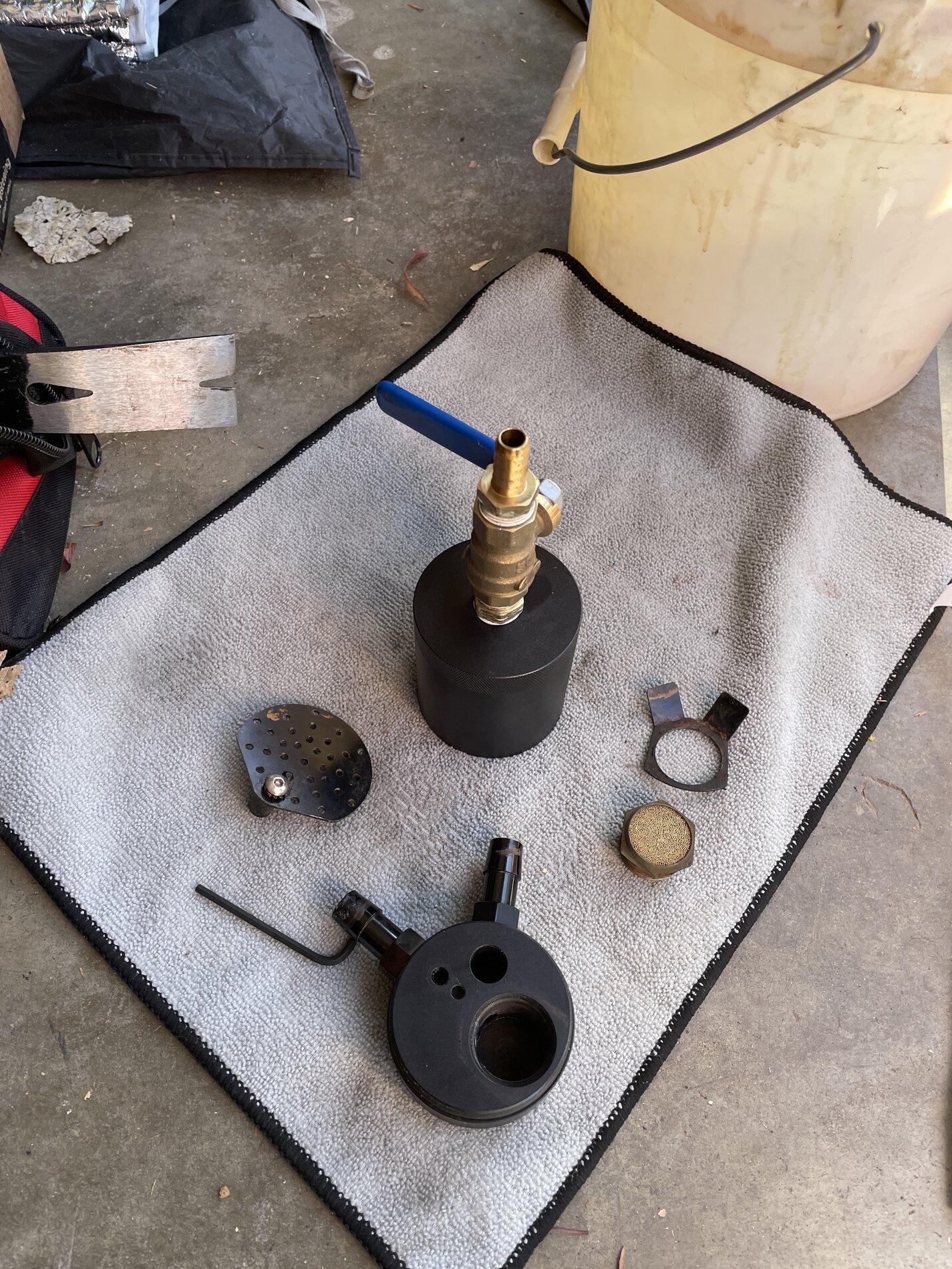

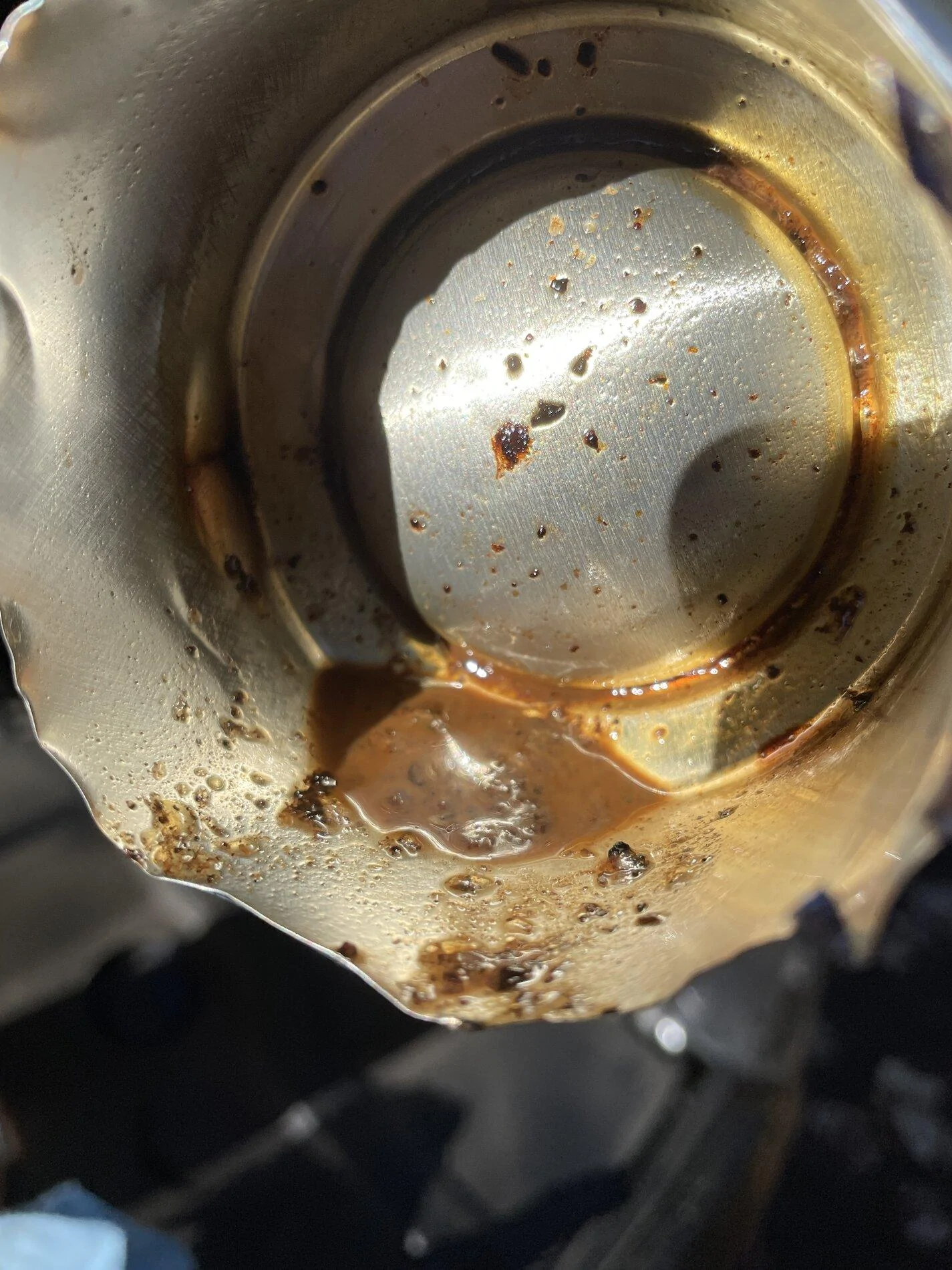

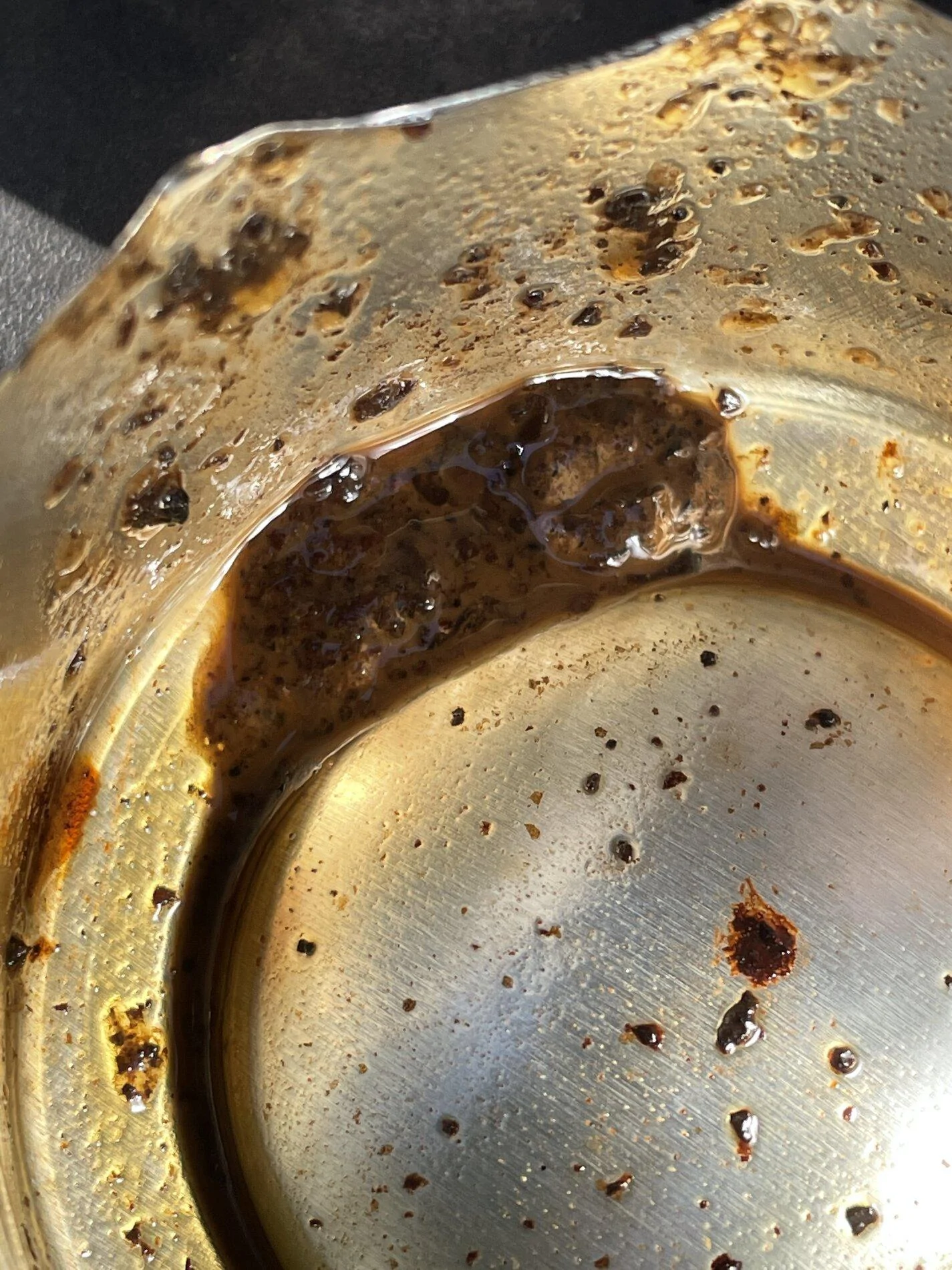

Well I hit one year with my ranger and 27,500 miles. I left the catch can alone for roughly 2,000 miles and what I found today in the catch can makes it all the worth it.
I added a nozzle to the end of mine for easier clean out. The nozzle of course creates a low point so I caught most of the carbon in there. That carbon came out as a massive chunk.
$280 worth every penny

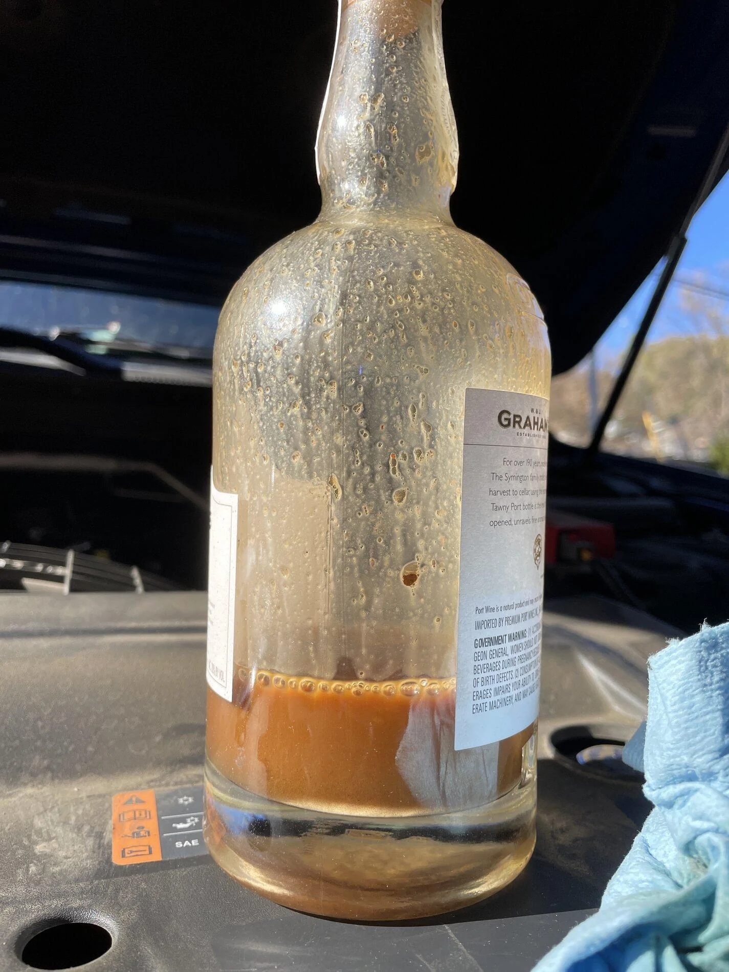

This is the amount that I’ve pulled out of the can over the course of one year

I would highly recommend taking the can apart after this many miles and give it a good cleaning. Quite a lot of gunk was stuck to the baffling plate
