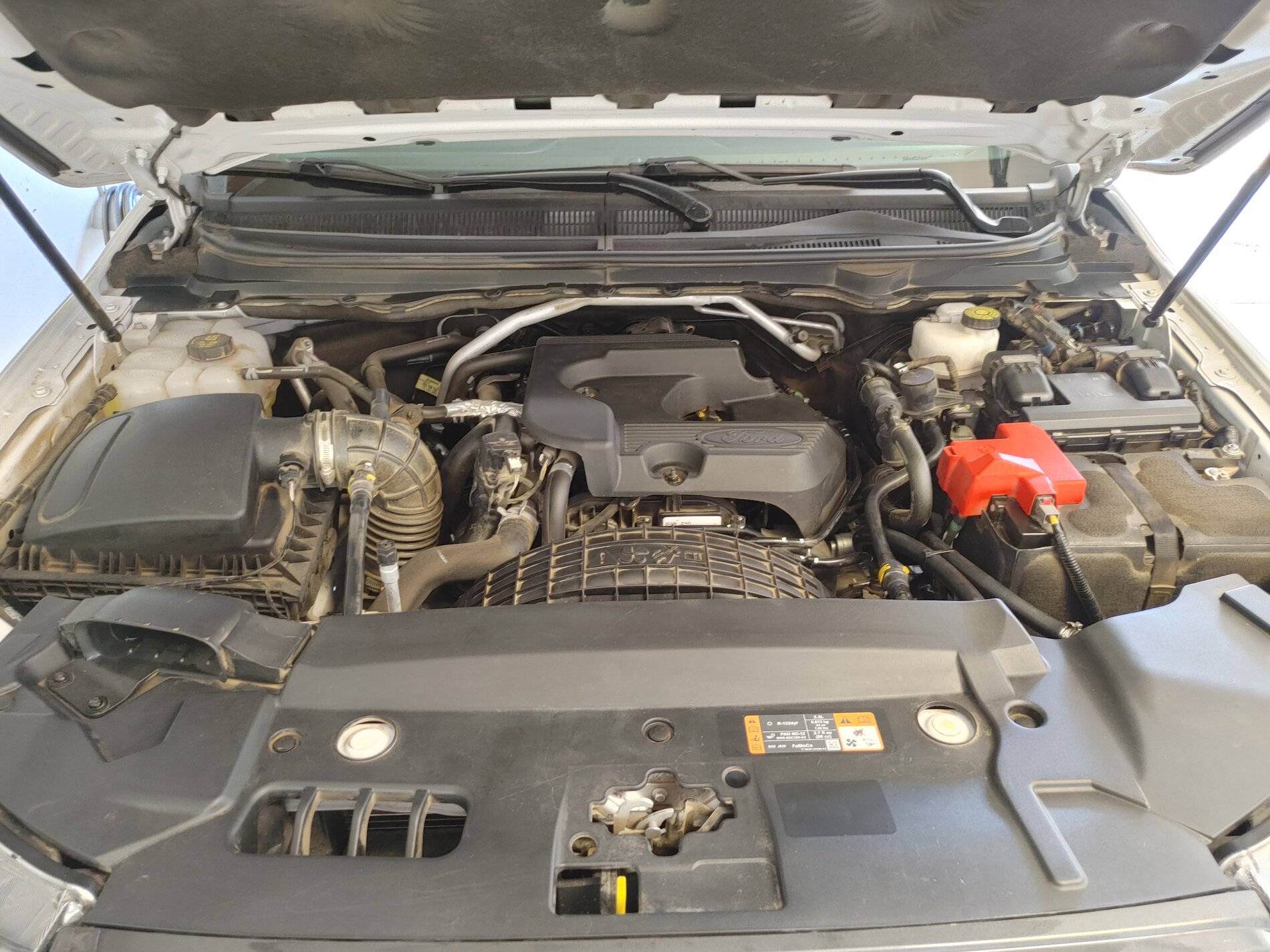

Looking for any recommendations on oil catch cans that are compatible with the Lariat engine shroud.

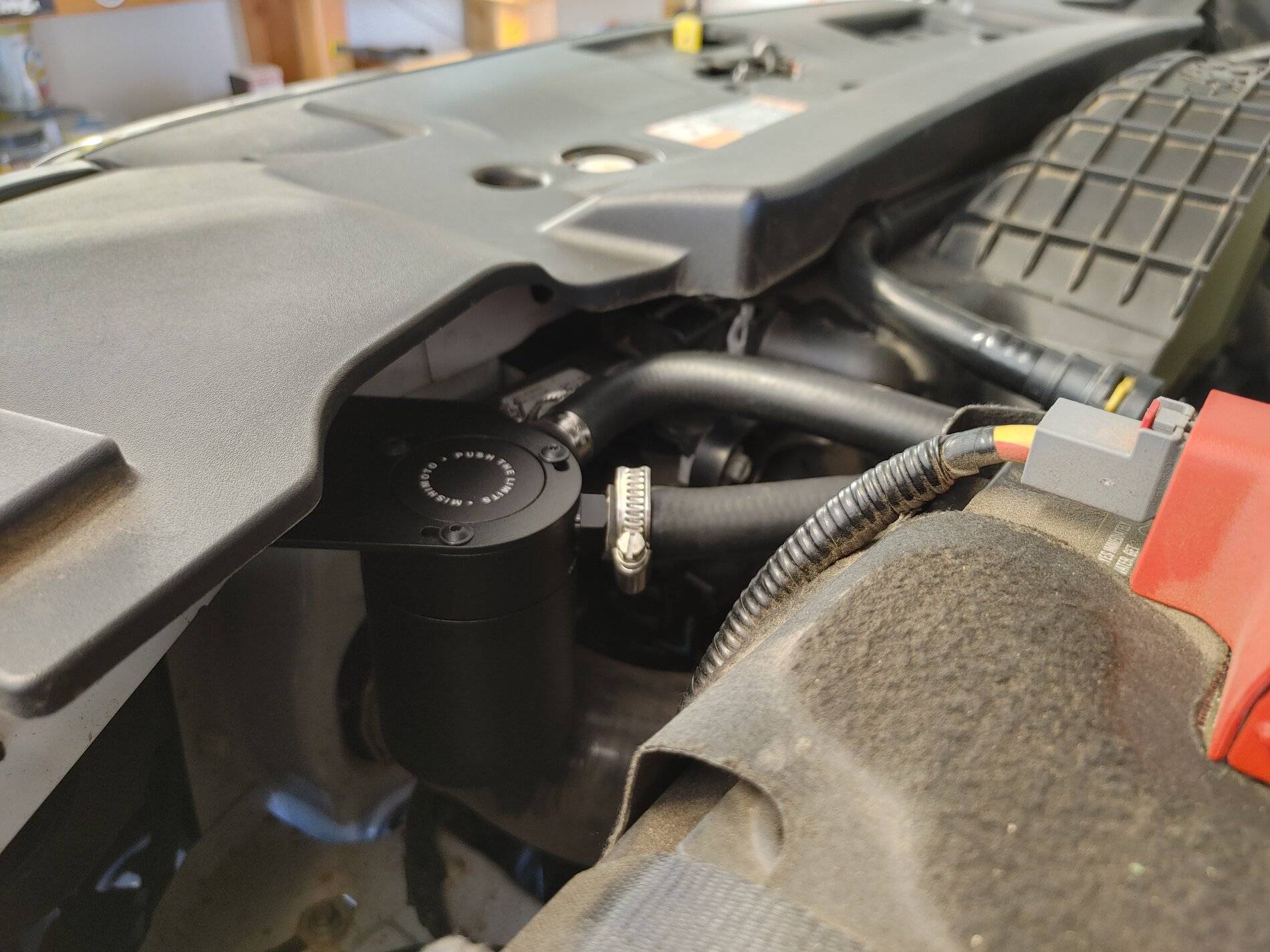

I have the mishimoto on my lariat. Tucks away super clean but may be an issue if you have the tremor package cause of how the wiring is set up.
