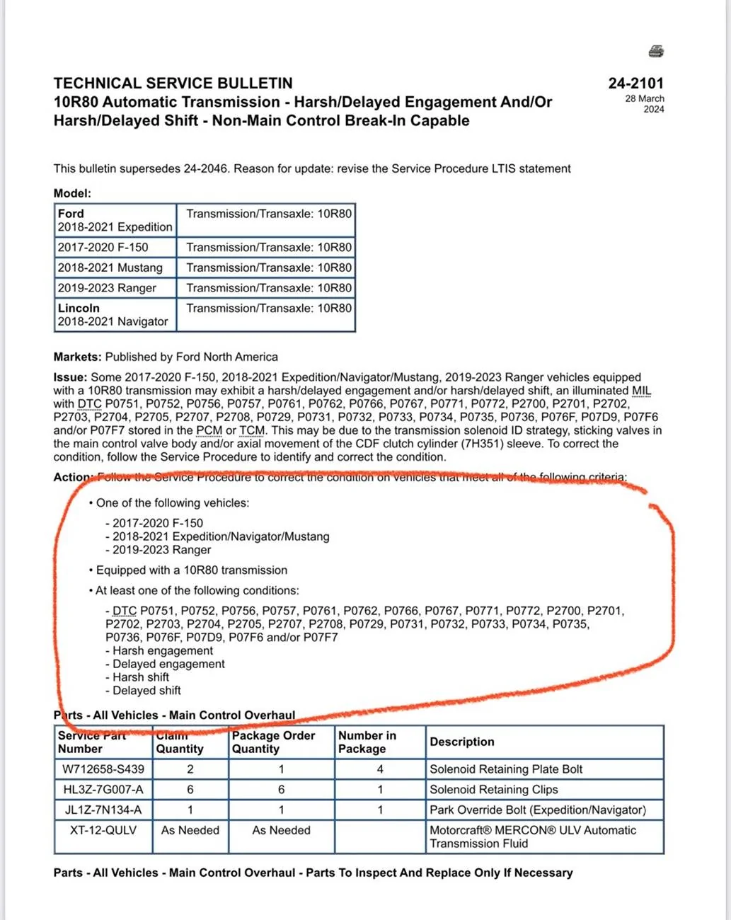

The no DTC is pure BS. See the attached first page of the latest TSB. Note the circled section. It says must have at least one of the conditions. Nothing states it has to have codes in addition to other conditions. My transmission was replaced after the first two steps of the TSB and it never had any codes. All TSB steps and the replacement of the transmission were based on shifting issues and not codes. I’d rub that in the service manager’s face if it were me. And the general manager too.
Oh did I ever. I've read through the TSB more times than I can remember.
I agree. Unfortunately all the service writer had to say was that they weren't feeling the hard shifts/couldn't replicate my symptoms, and "couldn't find any codes".
