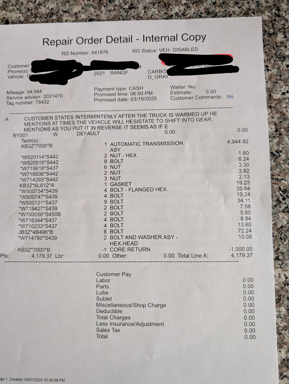

Vr22s
Ryan
Jan 9, 2021
178
872
Draper, UT
2021 Tremor
Biotech Production/Operations Manager
Finally got her back, glad I didnt have to pay that bill.
Feels like it rides smoother, new trans is still learning itself though.
On a side note, my one automatic window doesnt work anymore... Ill have to address that later.

Interesting. The MSRP for the transmission with the core is $3953.33. They’re proud of their price. Fortunately you didn’t have to pay!
