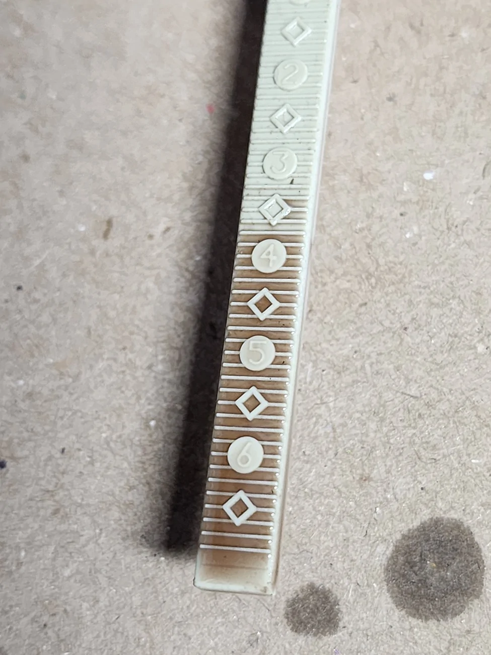

Ford authorized CDF drum replacement and service advisor said she will add additional repairs based on what they see.
They sent this picture
That's big time burnt.
When clean, the ULV fluid is difficult to even see on the dipstick.

If you never drained/filled/flushed the fluid, then that's actually probably about normal. This fluid gets pretty dark even though it's not "burned". When I did my first drain/fill (I don't recall the mileage... maybe around 30k?) the fluid was very dark.

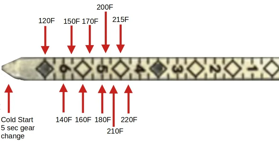

I need to clarify... I have a PPE Deep pan installed. It holds 1.75 qts more than the plastic Ford pan. Whatever you pull out needs to be put back in + any additional capacity that your new pan has.
I used two 1 gallon jugs to capture the old fluid, but I marked the jugs with a sharpie at 1 quart increments. ( added a quart of water marked, repeat 4 times per jug. I also added a brass fitting to the hose output end to insure the hose stayed in the jug. It is going to want to curl and climb out if your not careful.
The insure the fluid level is correct when your done, use my cold measurement procedure. It is simple and accurate. The Fitzstick makes this check very simple, accurate, and quick.
Start the truck on level ground after it has sat unused over night. immediately shift through the transmission from park to drive and back to park at 5 second intervals, then immediately check your dipstick. The fluid should just touch the tip of the dipstick... 1/8". Don't wait 5 minutes to check it, the fluid rapidly expands and your results will be artificially high.
I used a ScanGauge III to calibrate the levels on the dipstick image below. They represent the same fluid levels at different fluid temperatures.
To be safe, I wanted the fluid to be dead center on the diamond between 4 and 5 at 215F. This is Fords upper temp level right in the center of the acceptable range window of 4-5.
Conservative, but safe.
It is very easy to overfill the 10R80 and not know it until fluid temps move higher, and you will not hit those temps by simply driving the truck in normal situations. It took 38+ minutes idling for my truck to reach 180F. And I had to power brake the truck to reach 215F.
