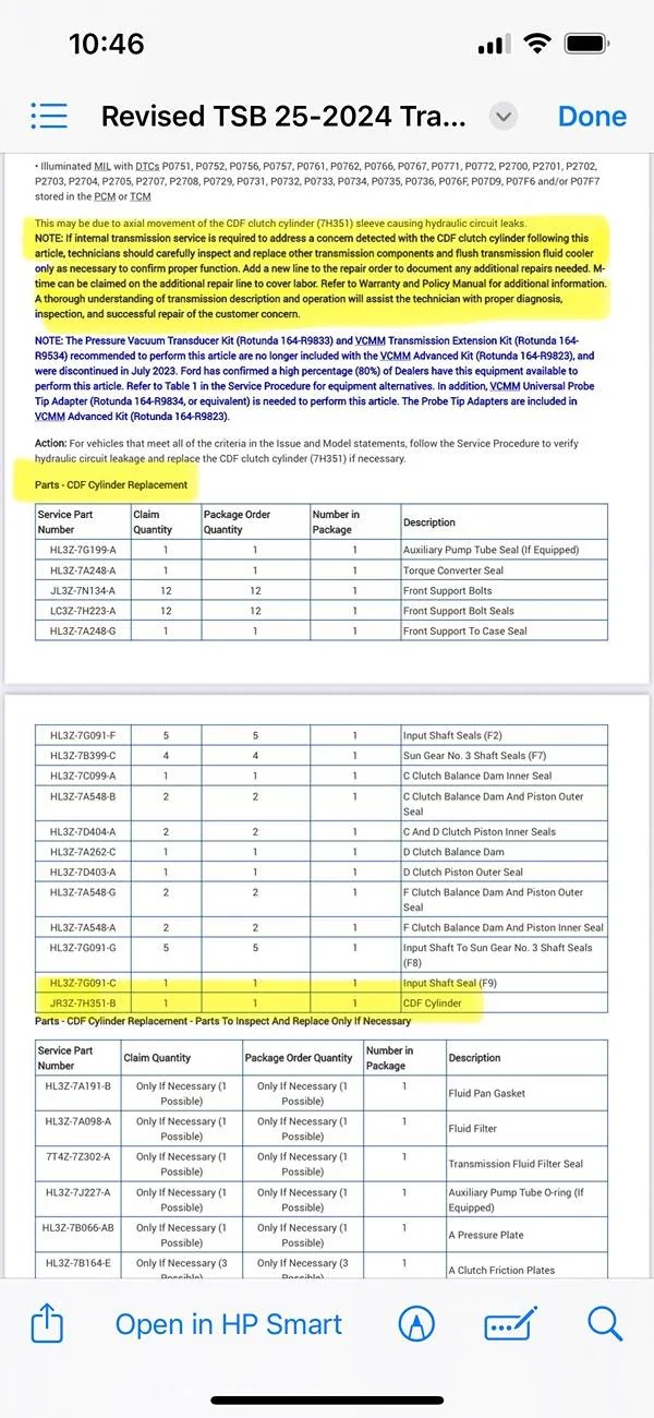

So it looks like they now do a ton of pressure tests to check for internal seal leaks, but they only replace the seals, not the "defective" CDF drum. I also didn't see that there's no escalation procedure, i.e. rebuild or replace the transmission. Did I miss this in all of the test instructions?
Yes - You Missed it
37. Disassemble the C, D and F clutch assemblies from the CDF cylinder. Discard the CDF cylinder. Refer to WSM, Section 307 01. 38. Assemble the C, D and F clutch assemblies into the new CDF clutch cylinder. Refer to WSM, Section 307-01
They replace the drum if test indicates. Also spell out the steps if tech finds other damage.

So this seams a lot less involved than rebuild or replace, it that correct?
Target specific repair. But it does state at the beginning of the TSB steps that if the tech notes other issues to repair as necessary and how to code them on the claim.
“NOTE: If internal transmission service is required to address a concern detected with the CDF clutch cylinder following this
article, technicians should carefully inspect and replace other transmission components and flush transmission fluid cooler only as necessary to confirm proper function. Add a new line to the repair order to document any additional repairs needed. M-time can be claimed on the additional repair line to cover labor. Refer to Warranty and Policy Manual for additional information.
A thorough understanding of transmission description and operation will assist the technician with proper diagnosis, inspection, and successful repair of the customer concern.”
