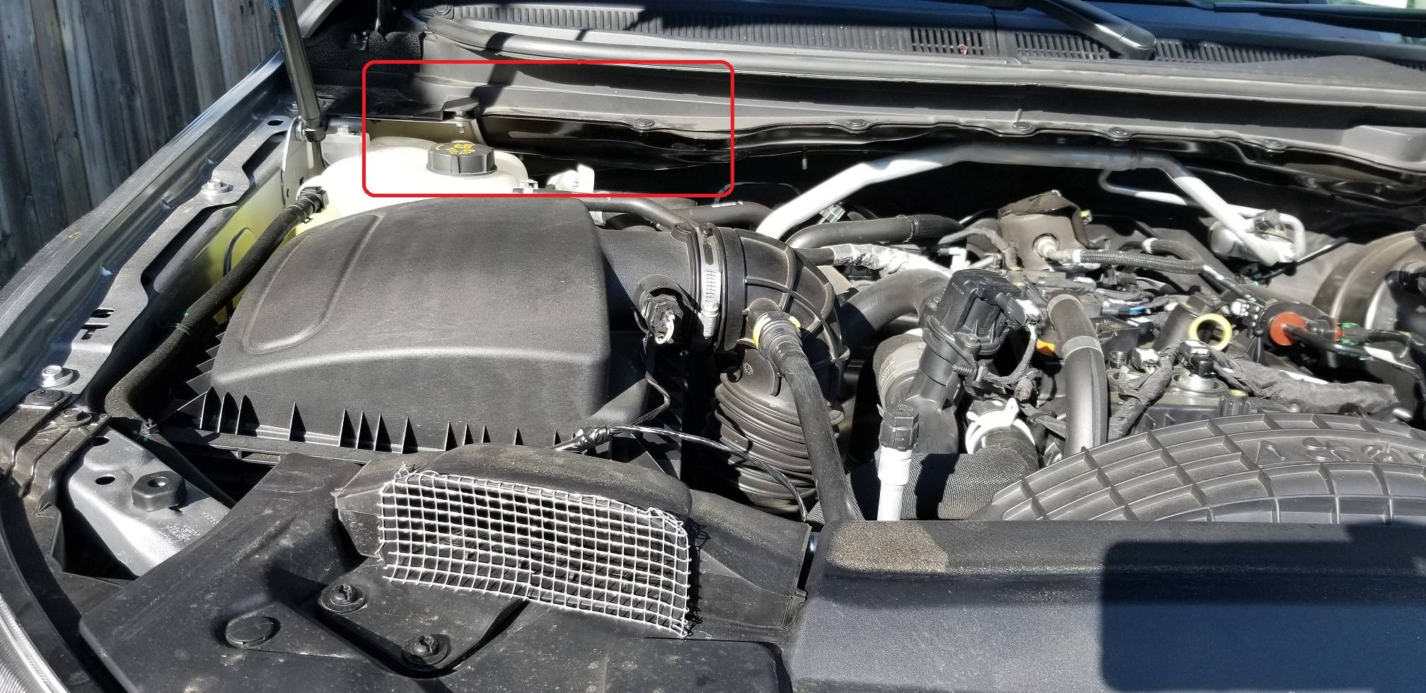

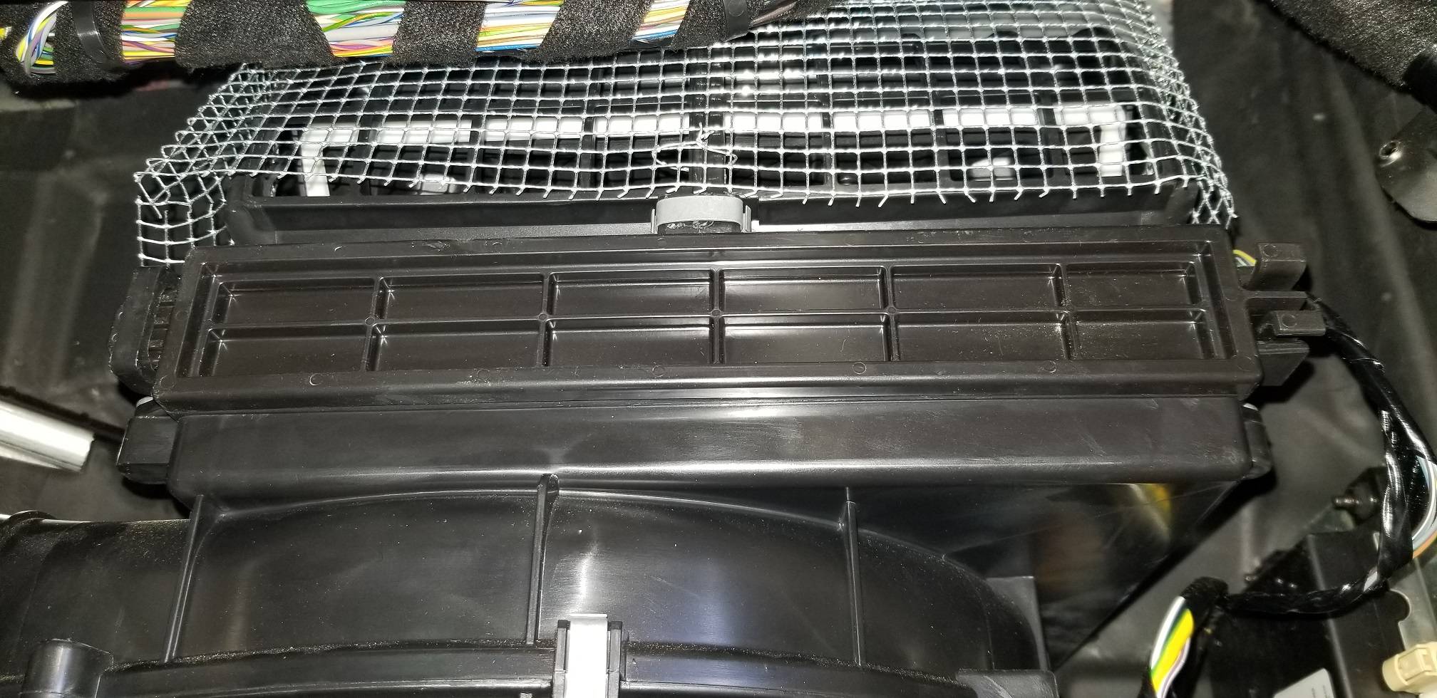

I added some metal mesh to my engine air intake, cabin air intake at the firewall and cabin filter. No mice this weekend

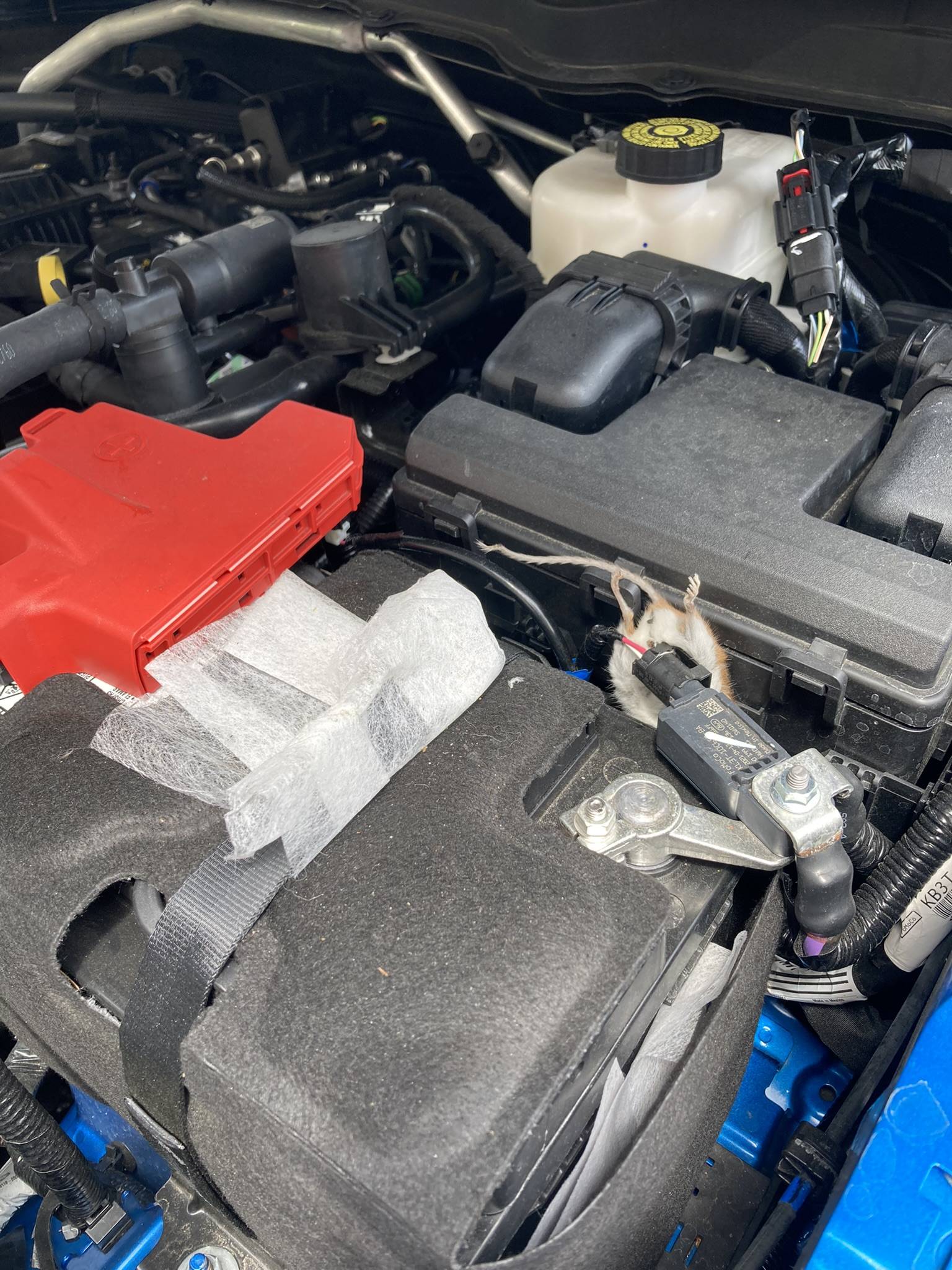

Cleaned out a nest on my cabin filter a few weeks ago, and laid down some poison bait. Found this guy yesterday. May need to add some wire mesh like you guys have done.

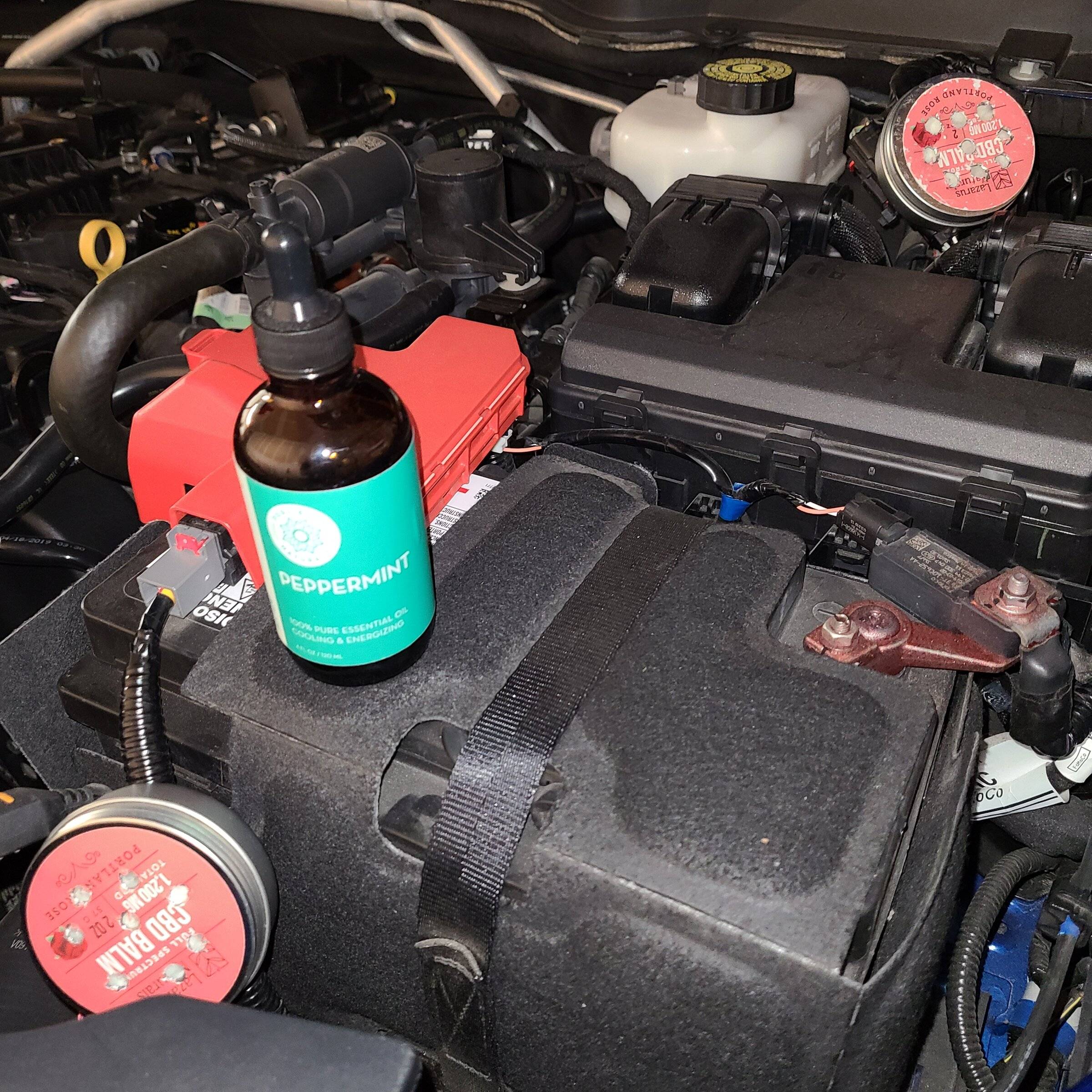

I was just refreshing my little canisters under my hood yesterday when I saw this thread.
I use old CBD balm canisters from Lazarus Naturals. Maybe a Skoal can would work too.
I drill 2 holes on the bottom and about 9 holes on the top. Run a zip tie through the bottom 2 holes. Stuff with cotton and saturate with Peppermint Oil from Amazon.
Screw the lid on and zip tie them next to your battery, fuse box and the other side of the engine bay.
Knock on wood, no problems yet though I see mice traps in the neighborhood.
Do you need the screening under the dash if you already have the screen on the firewall under the windshield wipers?
