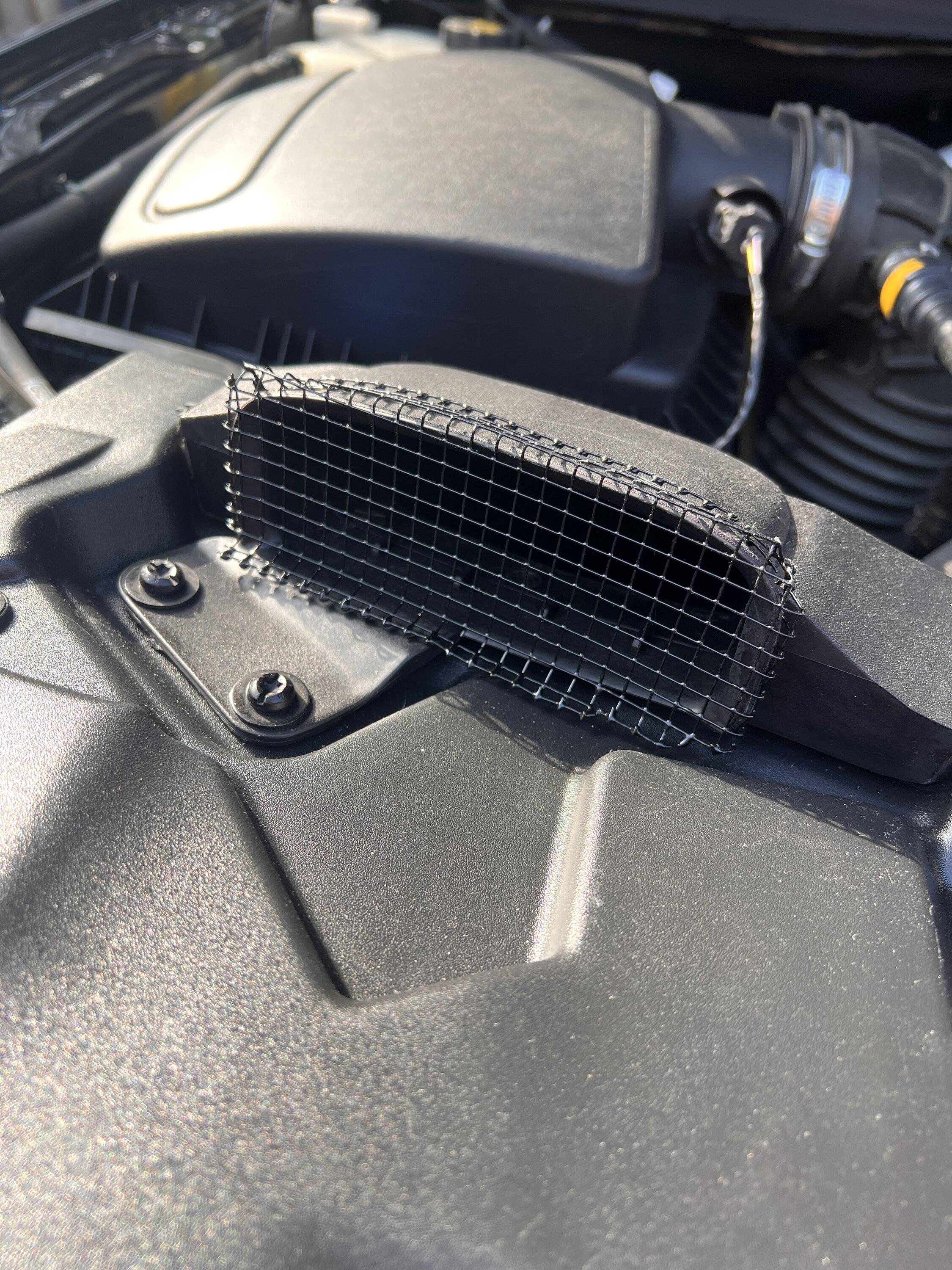

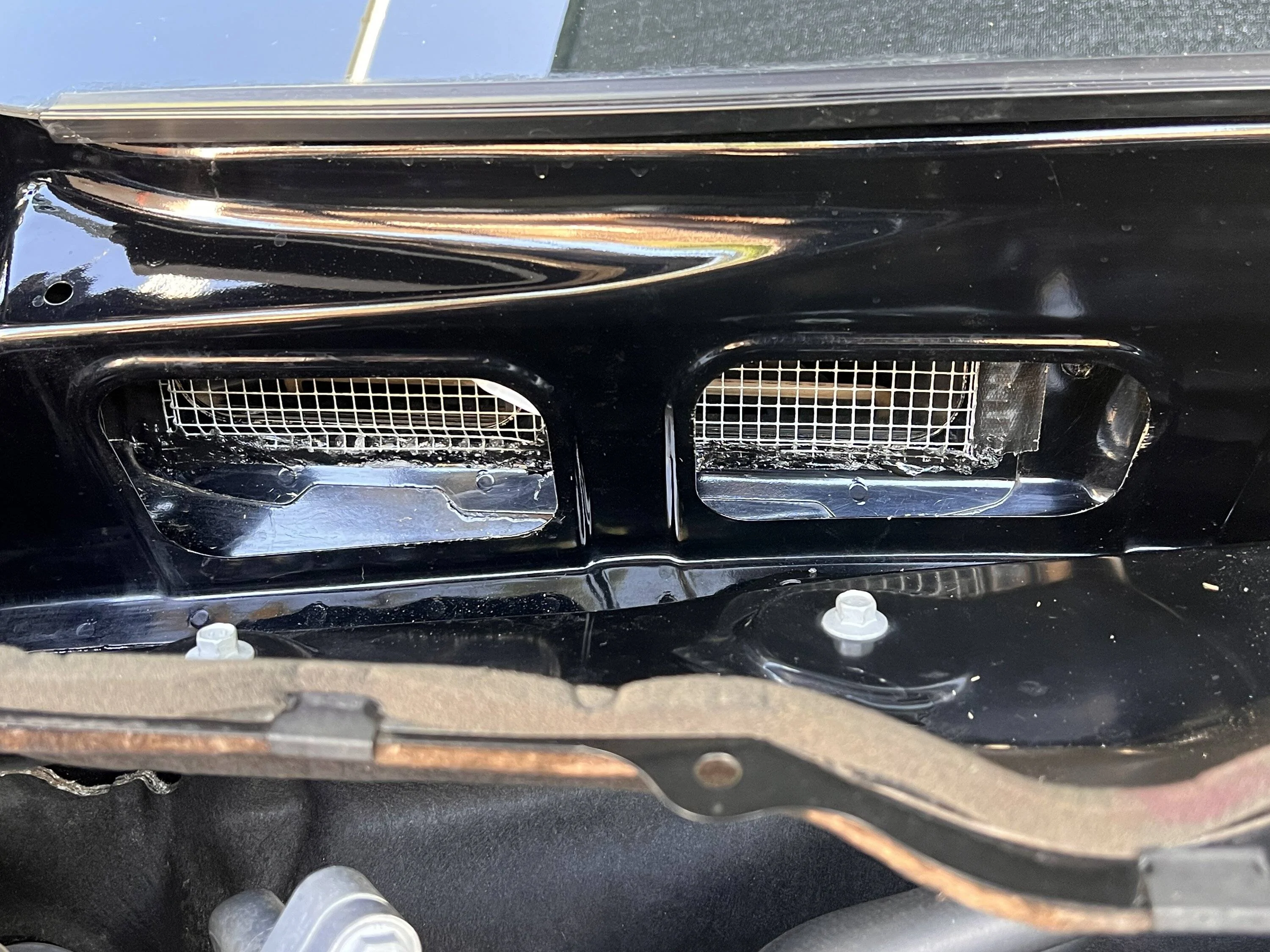

Here is how I blocked off my fresh air inlet. I cut some wire mesh down to about 3x5 and secured it with butyl tape after cleaning the paint inside that area to help it stick. I used shoe goo on top of that and it is holding on solid!
ALso.... Check your air cleaner for mice/rats too. I used the same wire mesh to seal off the intake.
I did the same to the engine air intake as I have run into the issue in cars before. Had an airbox filled with chocolates one time. No idea where they got those from... but it melted into the filter and required replacement that time. Seen acorns before too... Not a lot to grab onto there with the wire mesh, but seems to be OK.
