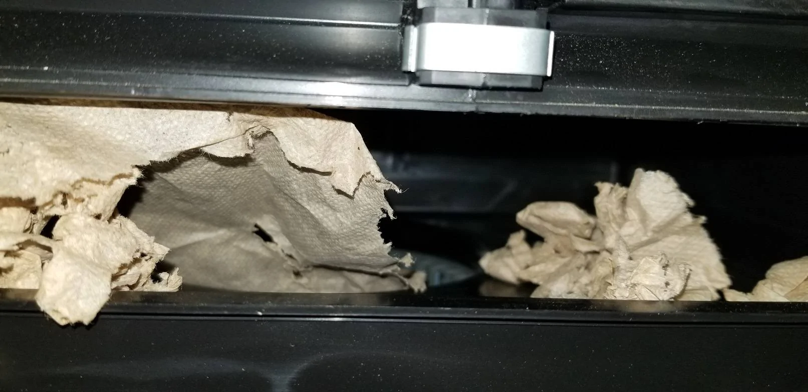

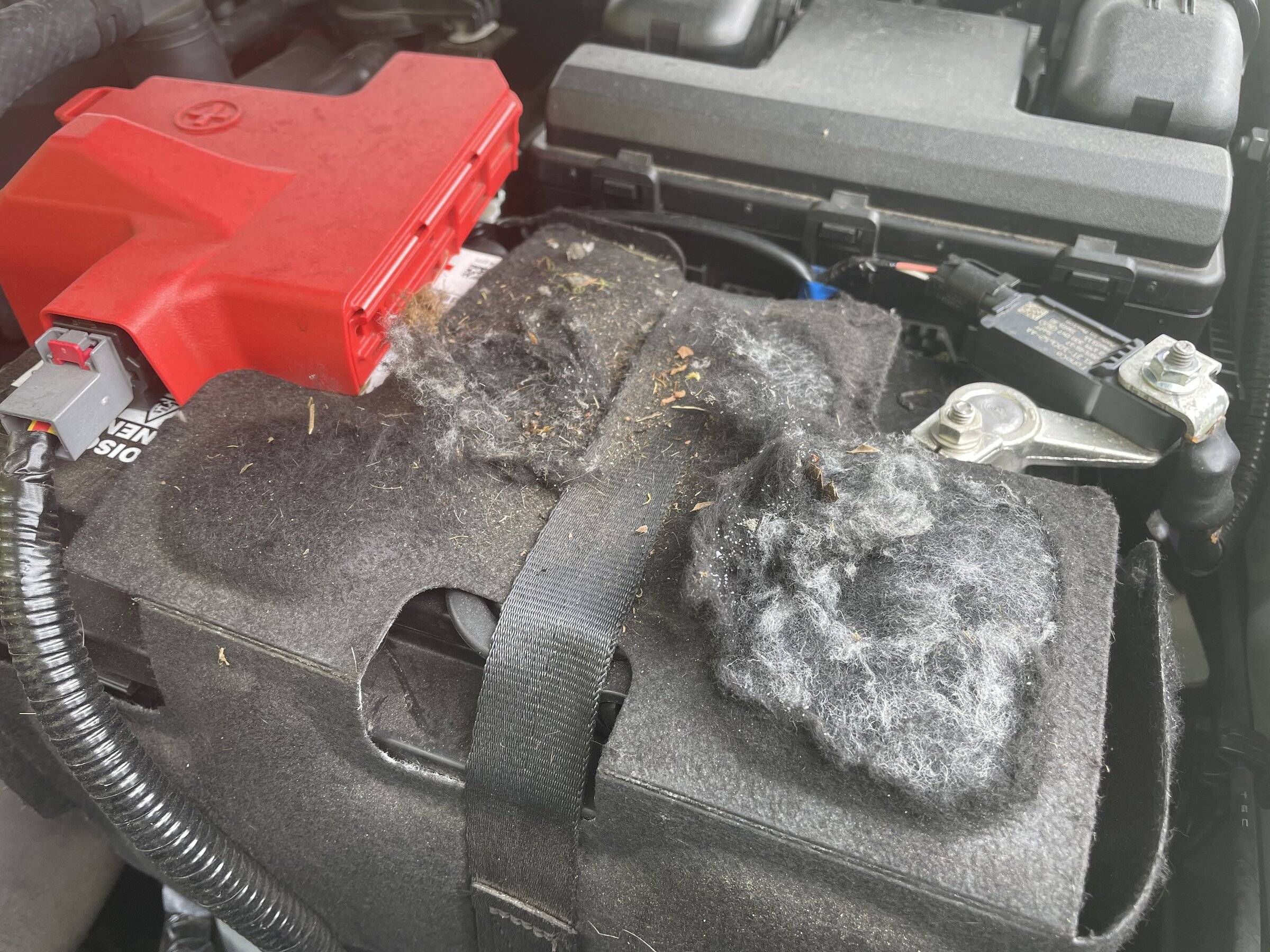

I have the same exact problem whenever I park in the field at my property. They get into the cab and eat napkins, then build a nest under the battery. I've caught 2 with traps in the cab so far.

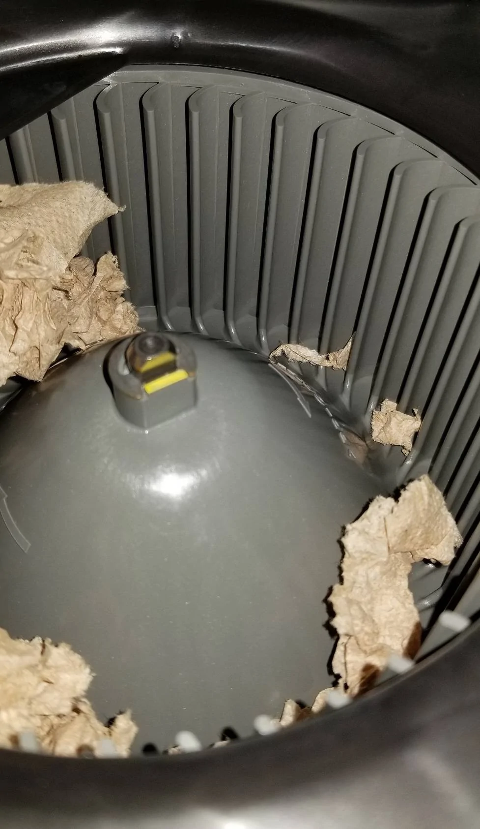

So after reading more of the replies I decided to open up the air filter behind the glove box. And yep, they got in there too. They ate a hole through the filter and pulled in all the napkins I was missing. Just spent about an hour cleaning everything out.
