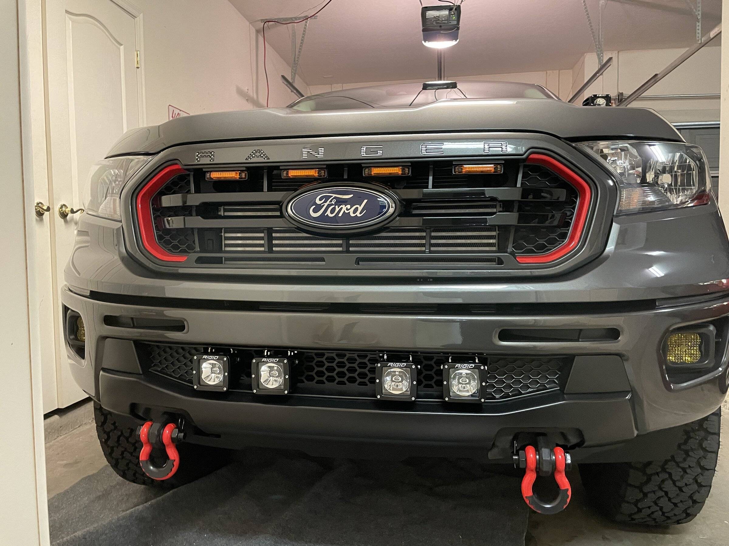

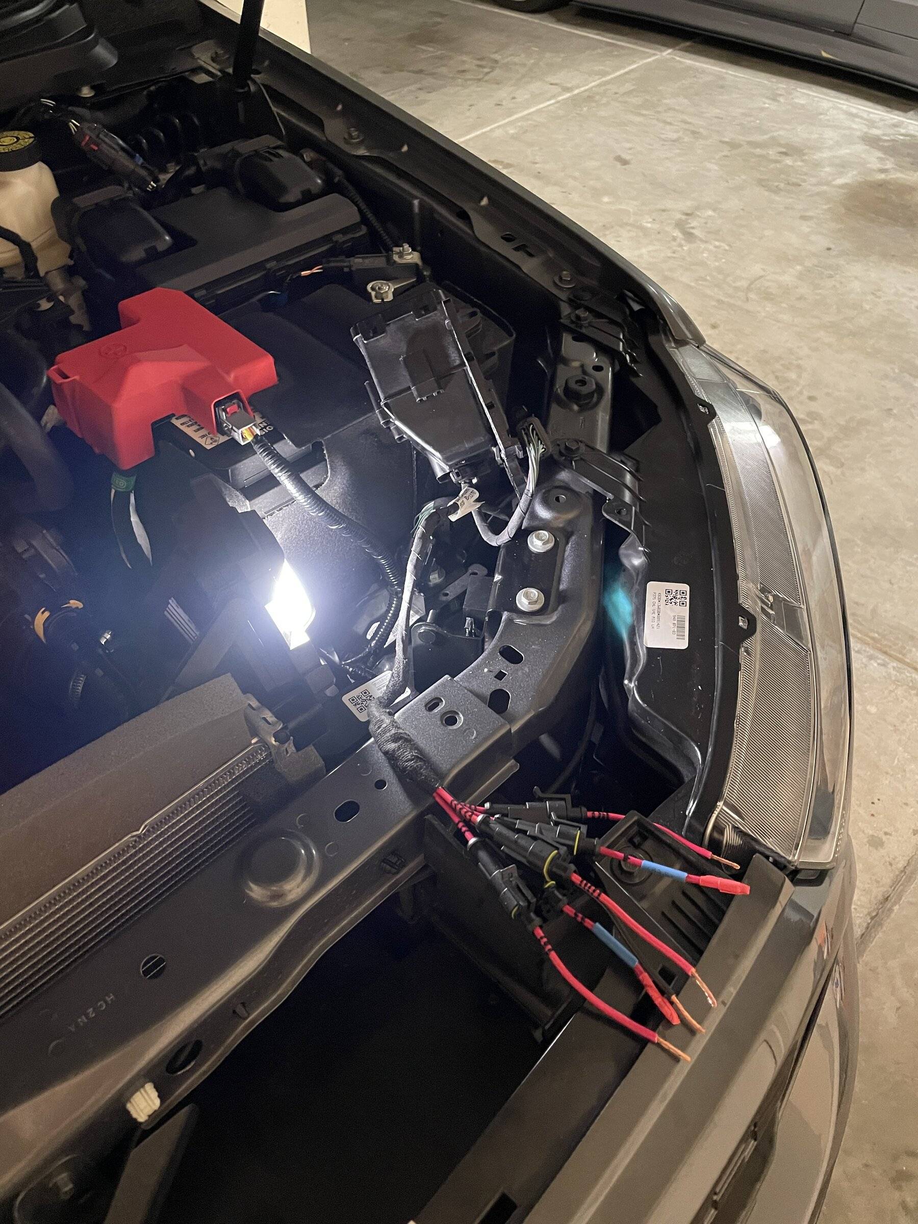

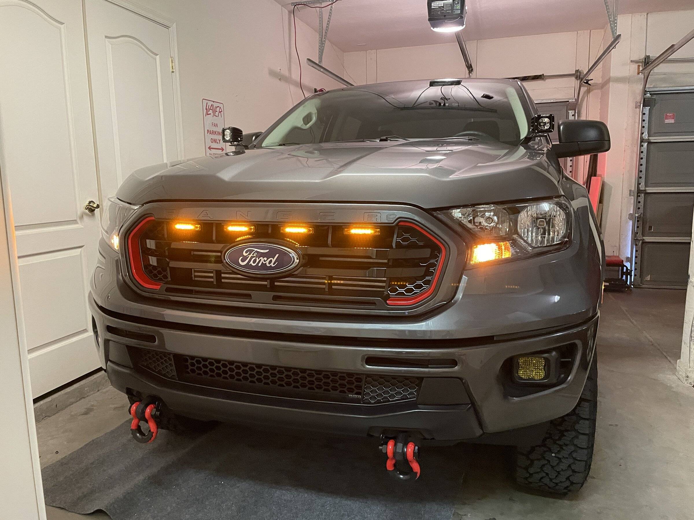

Installed the grill lights this morning. Which I'm officially calling Traptor Grill Lights. I used (4) of these. Made a custom wiring harness to tap into the passenger lower marker light. Printed custom mounts from polycarbonate to get the right offset inside the grill and mounted center in each of the (4) slots with 3M VHB tape.
Front end should look nice once the (4) Rigid Radiance Pod Lights are installed with amber backlighting. Can't wait to get my grill lettering next week. I chose the BW American Flag from TufSkinz.

Pretty happy with how these are turning out. Planning on tapping into the front side markers. Need to take out the wheel wells to run wiring and use push pin zip tie mounts. Will probably get to this later this week when other parts arrive so I only need to disassemble things once.
amber is a bit washed out with my white overhead LED lamps, but you get the picture.
Would you ever think about making another one of these to sell??

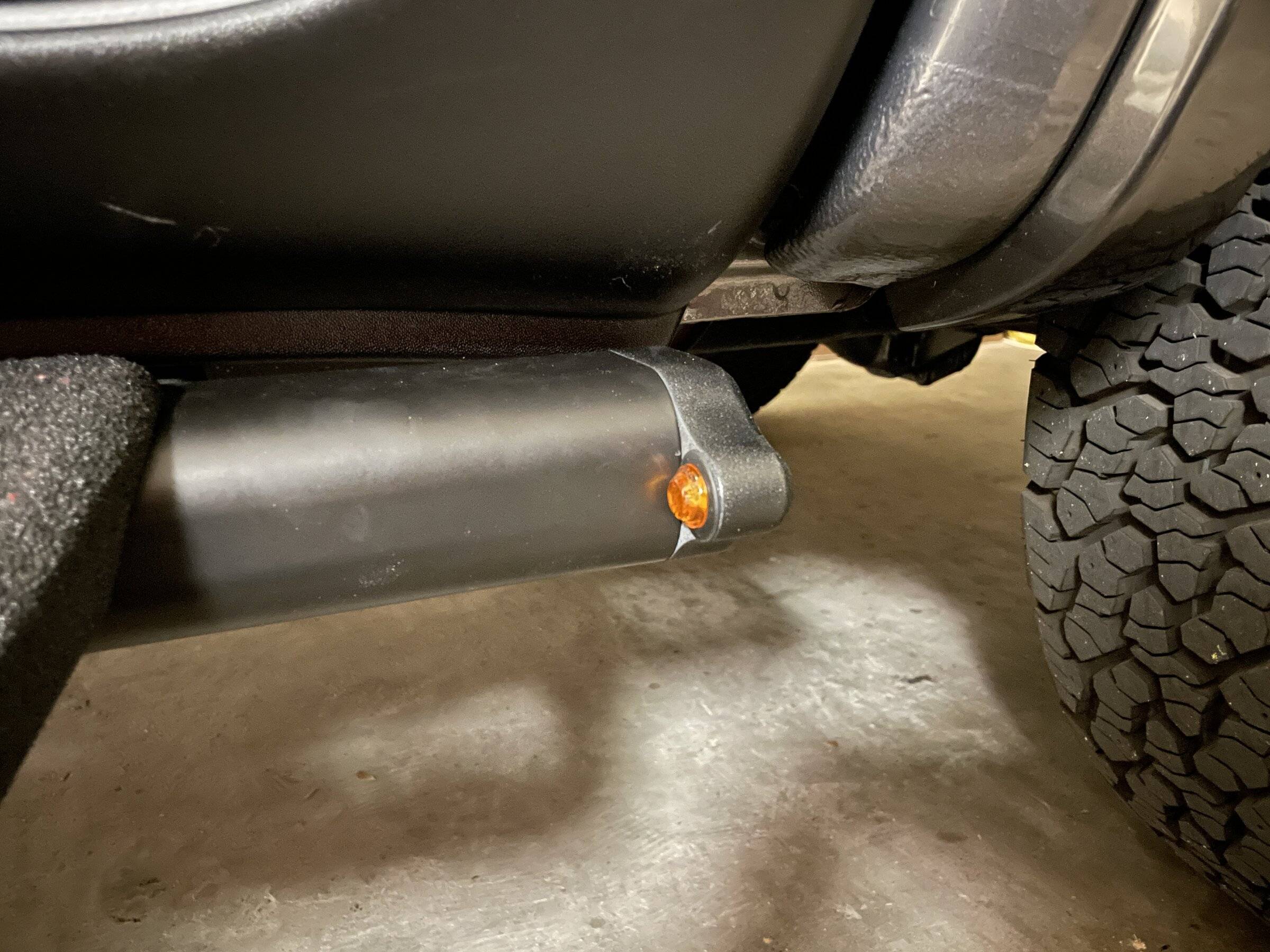

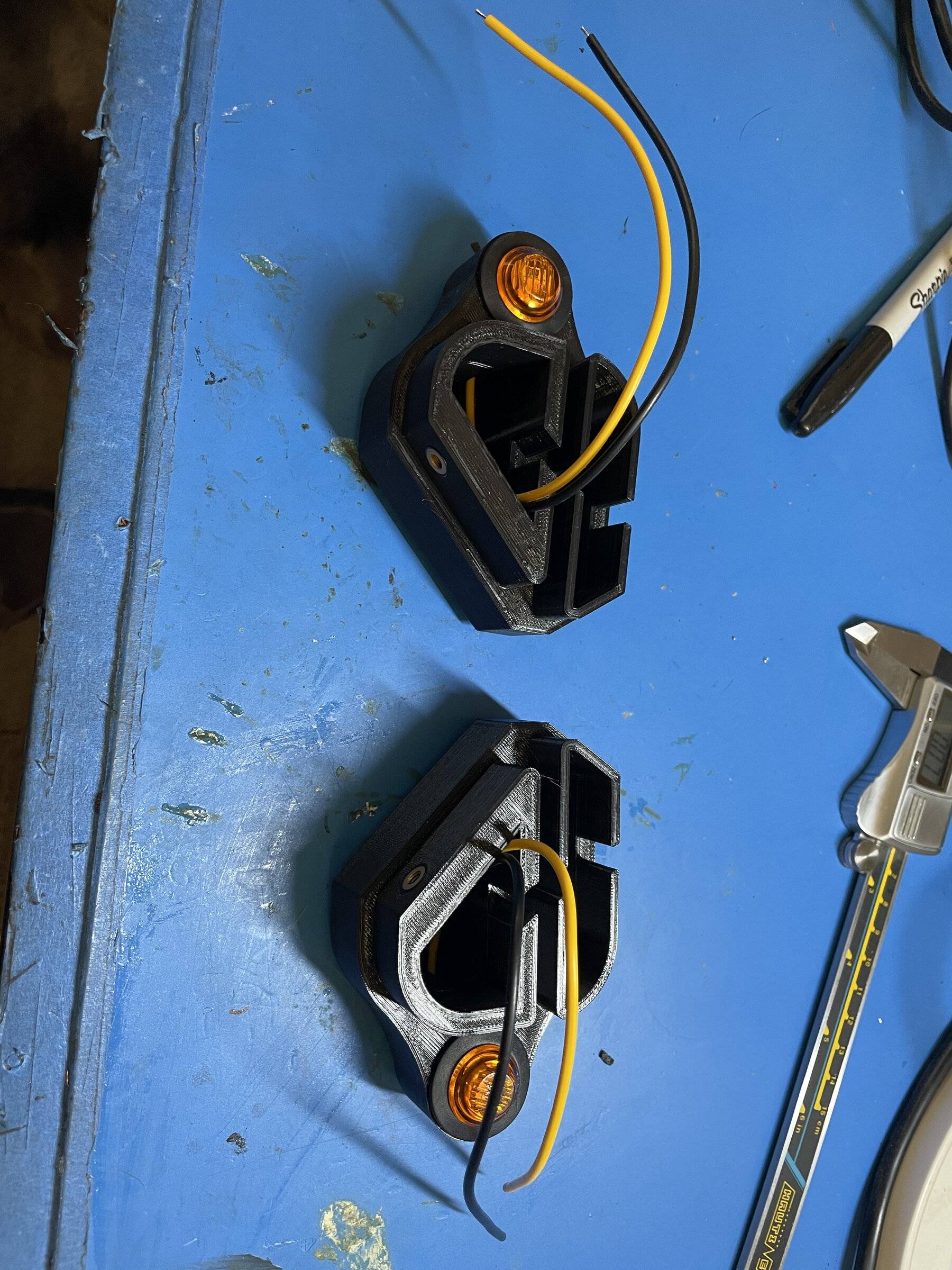

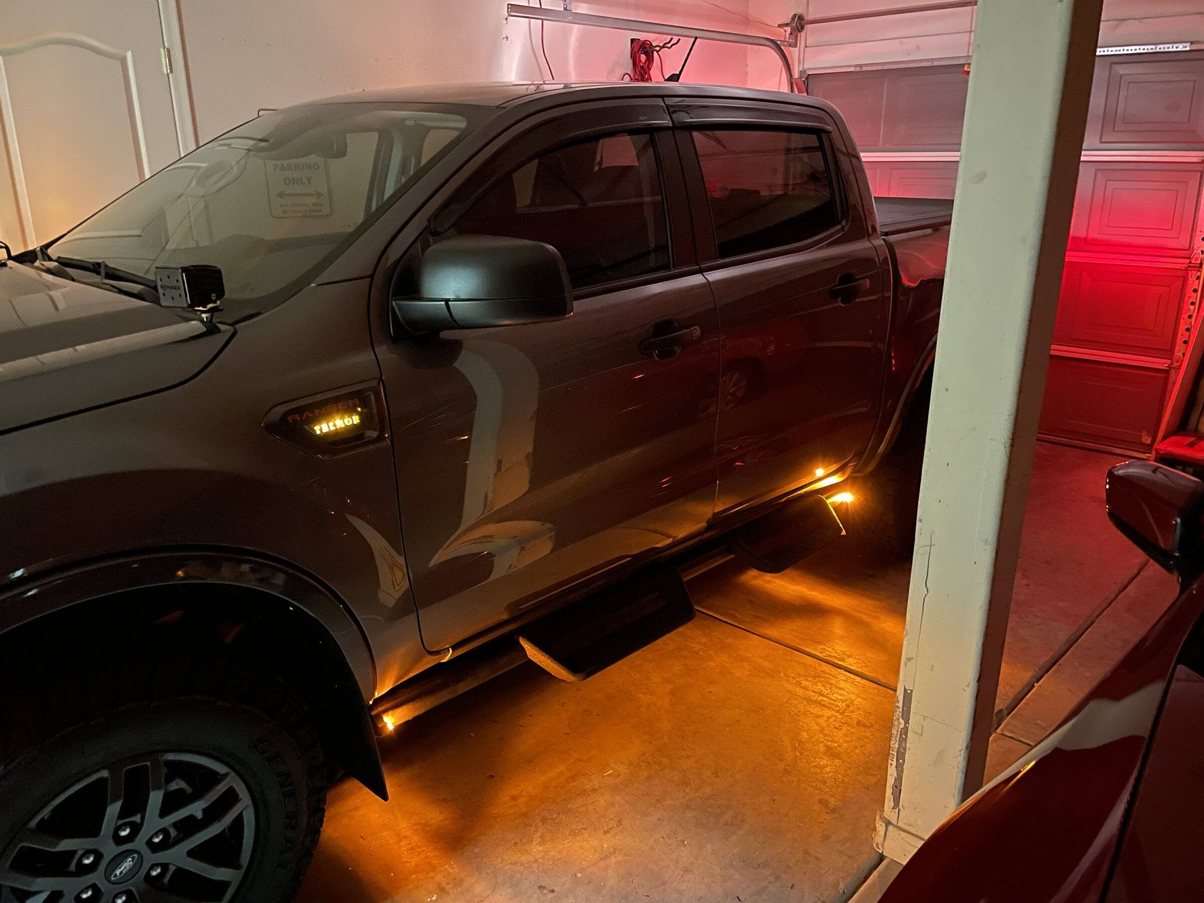

Designed up a pair of new end caps for the running boards to house some lighting. This way I can test if I want running board lights without drilling anything. These slide into the existing extruded aluminum and mount using the existing screw hole in the rear. I used heat pressed threaded inserts for the mechanical fasteners. If I end up liking them I can sand the print lines out and finish them off. The lights will end up facing each other on each end.

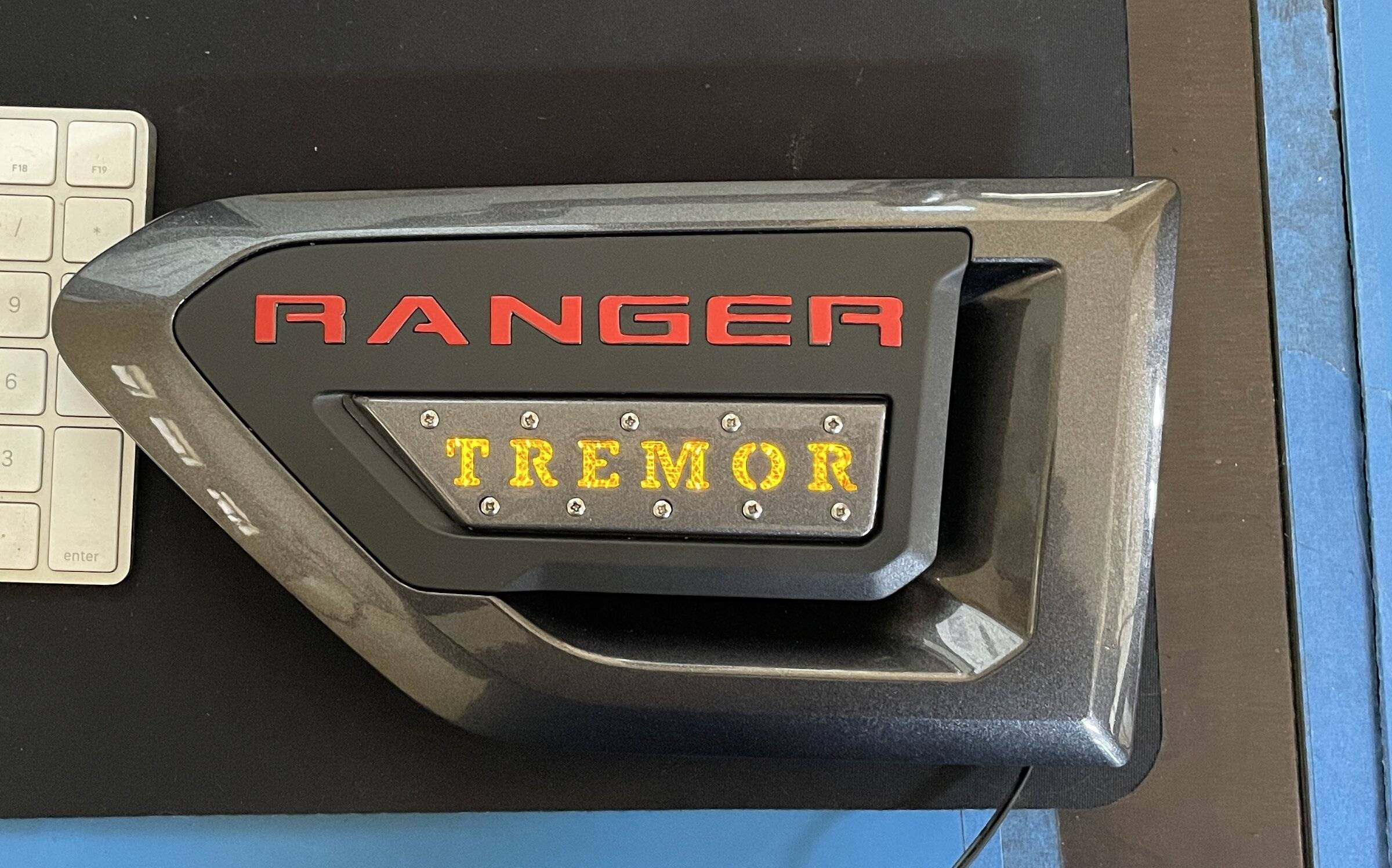

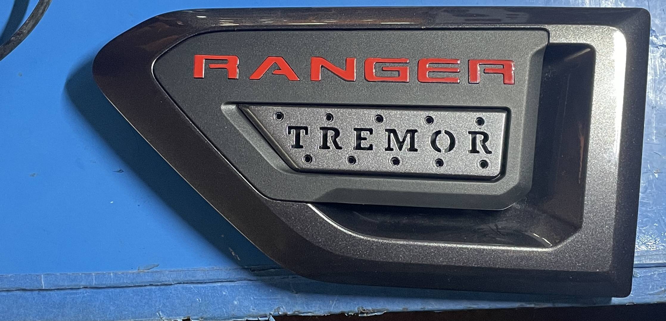

Housing is printing, got the plates painted. I may have to tint the clear a tad to match perfectly. Depending on the light and angle it’s close. Fun part will be cutting out for the lighting.
I thought about a knock off version and replace the M with a V. ?
Or replace Tremor with Damped. ?
I would think there would be a market on this forum for just the tremor insert. No back lighting or the 10 mounting holes. just pop the old one off and glue the new one on!

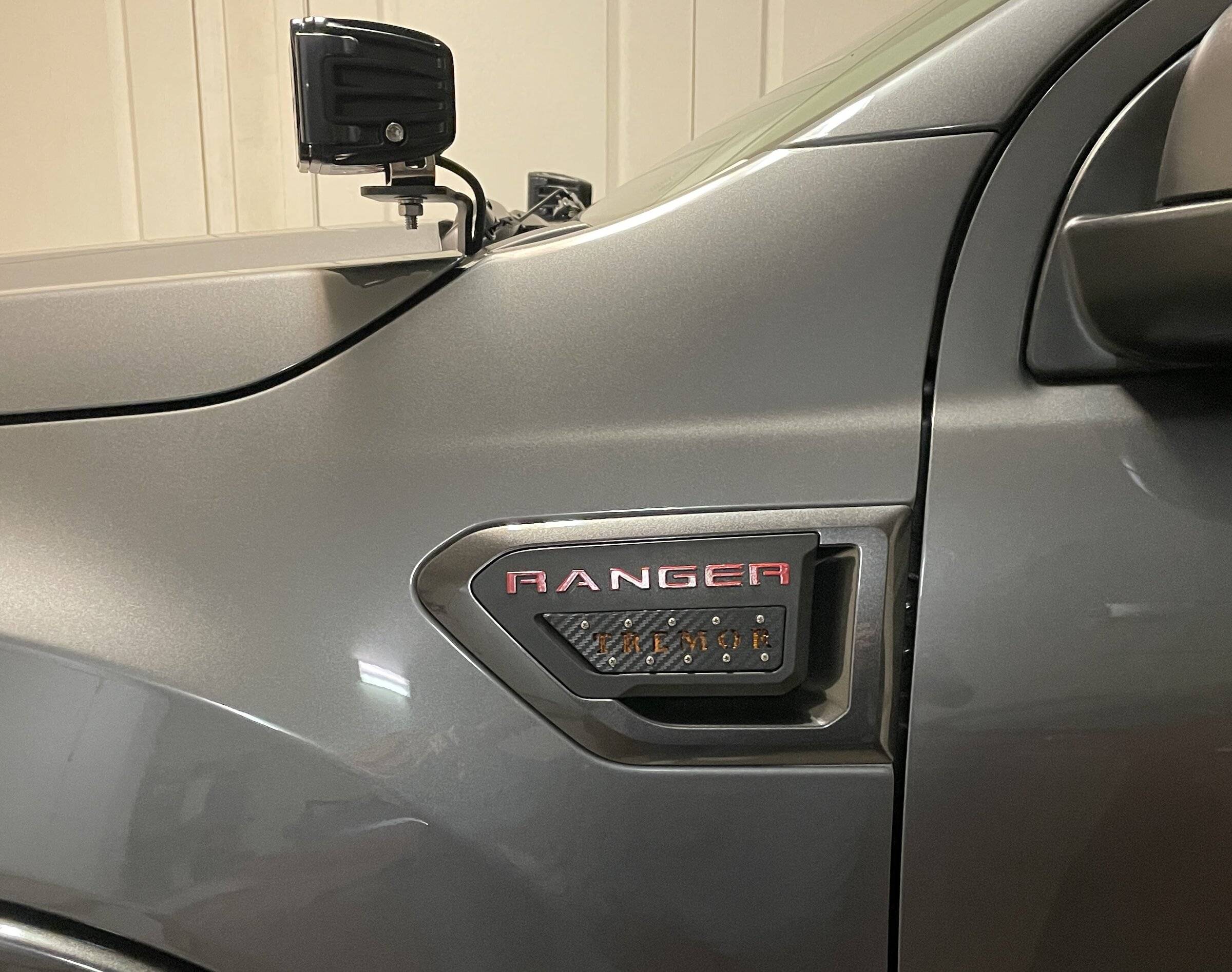

I just finished printing a revision that is more dimensionally accurate. Deciding if I’m gonna paint again or carbon wrap. I may wrap first so if I don’t like it I can just remove and repaint and clear.
