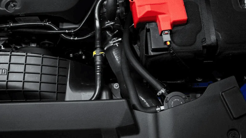

Please include me in that. I followed your, “by that, I mean mishimoto’s” posts in the mustang6g.com forum when you were designing and working on the Mustang catch can. I had already purchased and installed Bob’s Catch Can. What I liked about Bob’s were the options they provided on the new connection hoses. Has Mishimoto considered these as options?
Hi Rich, the hoses and fittings supplied with this kit will be a regular nitrile hose with the OEM quick-disconnects on the engine side and our push-on hose barbs on the catch can side. We do offer an adapter to run AN lines with our catch cans (which can be found here), so you could purchase two of those and re-use the OEM QD's that come with the catch can to make your own AN hoses.
Please include me on that as well!
Just subscribe to this thread or subscribe to our blog for the announcement!
I'm interested to see what the final product will look like, and if it allows me to retain the engine cover, I'd definitely be interested in joining the pre-sale.
Our catch can will work with the stock engine cover :)
Thanks!
-Steve

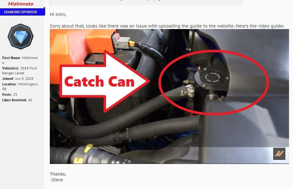

how accessible is the CC? in "my life" out of sight out of mind & if i cannot see the CC i may not remember to check it.
HenryMac
Sep 14, 2019
2,783
5,360
Mech. Engineer - Retired
Go to 6:23 in the video above. The can is in front of the radiator. Here's a screen grab:
It's very accessible once installed, it sits just in front of the upper rad support
