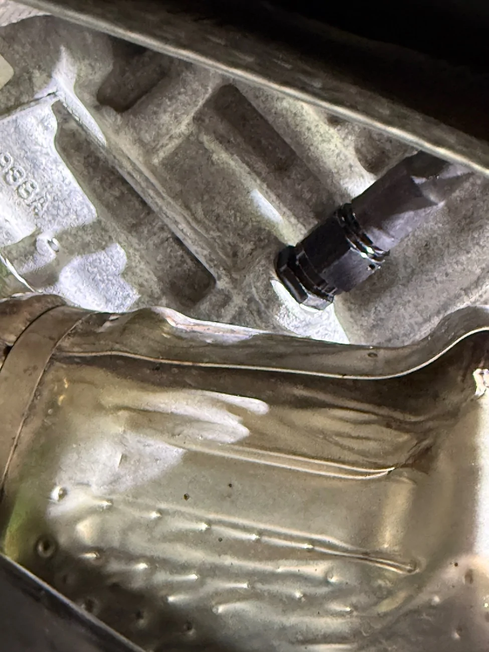

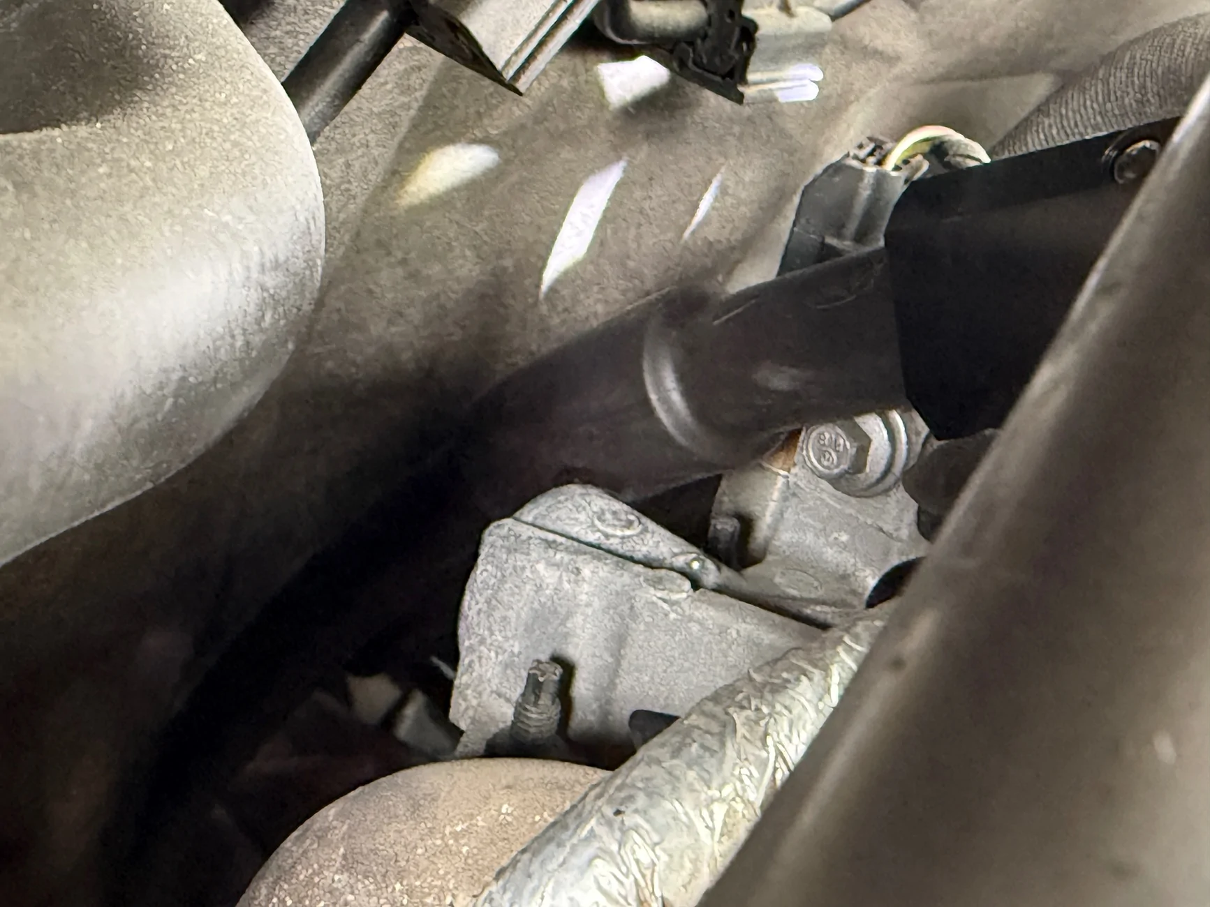

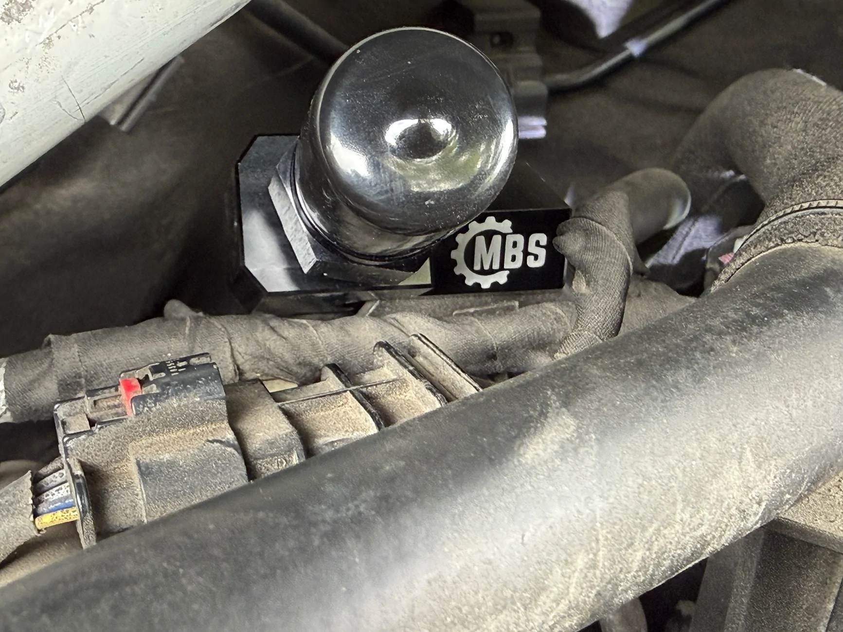

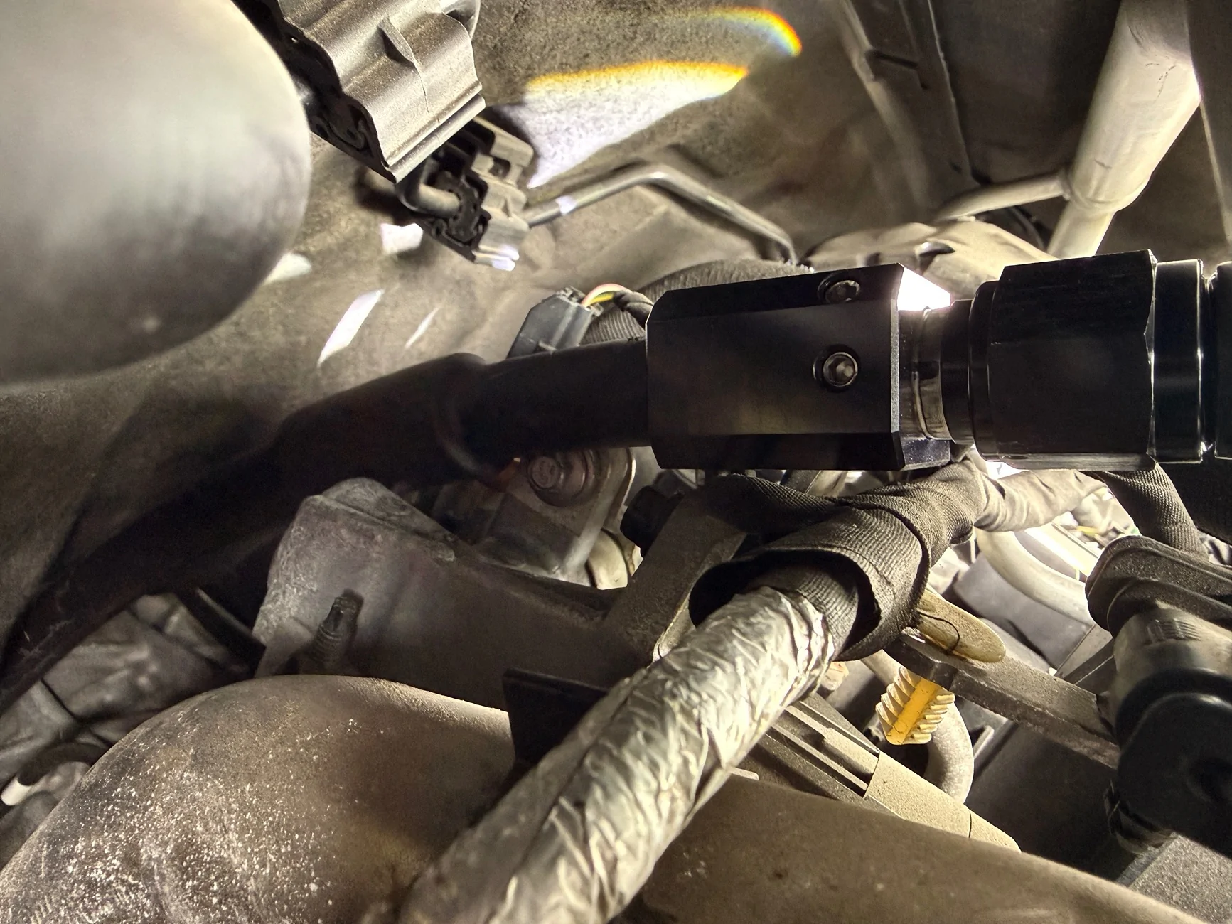

FINALLY DONE. Ordered the MBS stick like 9+ months ago and it’s sat in my garage. Today I had the time and temps were high 50s and cloudy so I went for it.
Followed the instructions for the most part, but I did two things different.
1. I have ford’s maintenance plan so on the last visit I had them loosen the transmission fill bolt and retighten. This made removal EASY for me.
2. I slid the stick down into place to test fit before taking the transmission fill bolt off and left it it place. My engine area is dirty from winter use, so I wanted to minimize risk of dropping debris into the transmission. It was easy to work around and clean necessary parts with brake cleaner and a rag.
As many have stated, install is relatively easy and parts are exceptionally well made. Install video was helpful and I knew where to be careful with stuff. I didn’t have any problems with the a/c line but I REALLY had to bend the L bracket for the wiring loom. All the looms now move freely after installing and are not pinched, but i was surprised how much I had to fiddle here.
Anyway… I know the instructions say it takes a few heat cycles for the stick to settle in for a truly accurate read, but I took the truck for a drive and checked on the most level spot I could get.
The stick was reading right at the 6 mark. So a bit low. There were also some bubbles on the end of the stick, which suggests to me the fluid might be frothing. Not surprising if it’s low?
Guess I might need to accelerate my drain and fill plans to get this truck to a happier place. 92k miles so far. Just a little quirkiness in 4th gear are my only problems.
Anyway… that’s my report on my 2019 Ranger. Highly recommend to others. It’s nice to have the data to know to speed up my maintenance. Here’s some pics of my final install (minus the dipstick itself) that show clearances.
be sure to let me know if I did something exceedingly stupid lol
