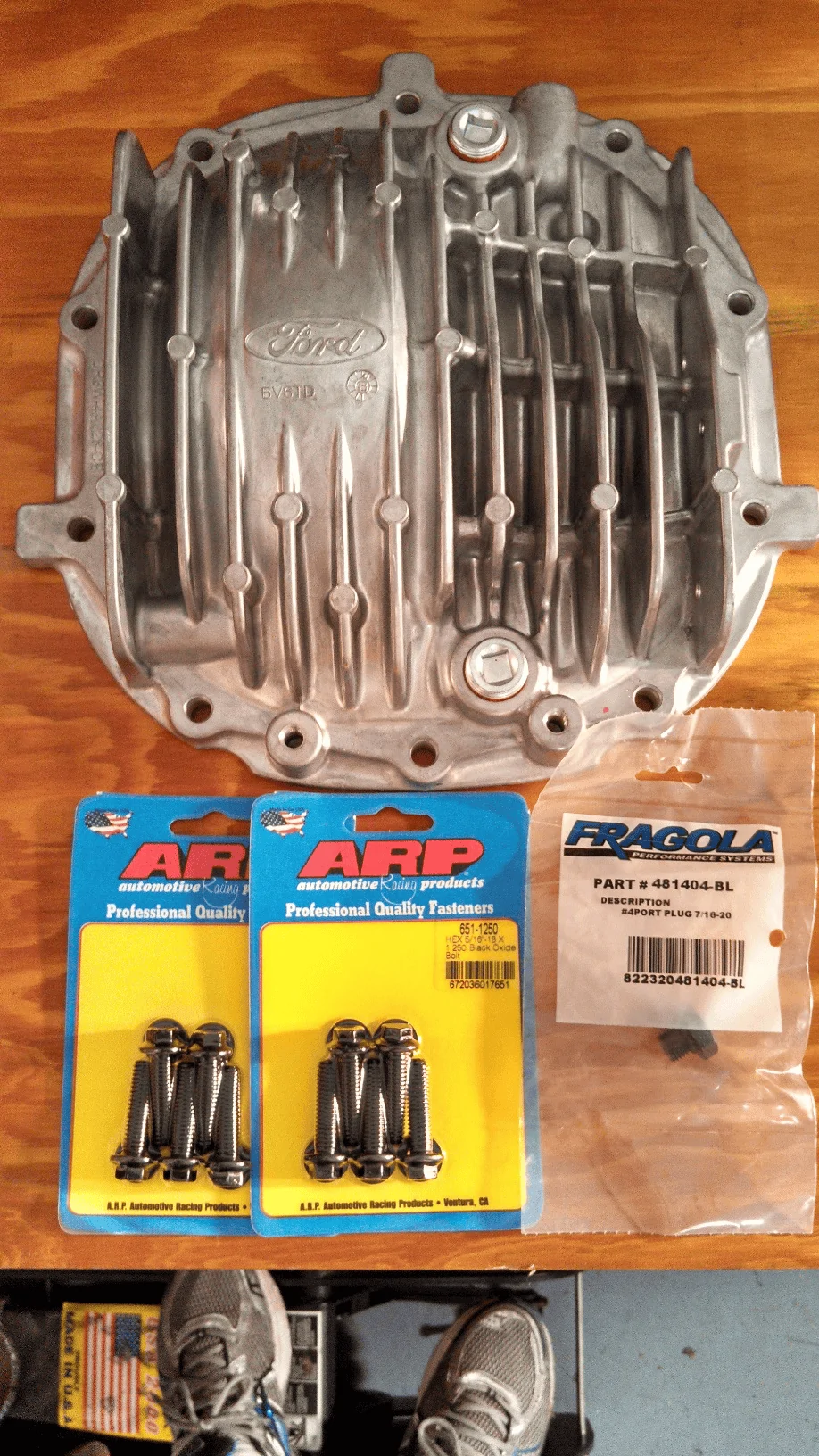

On cooling, i like extra capacity in terms of having a longer time to heat up, and the fins will help with cooling, there is some decent airflow going over it. Pic below is the GT500 factory cover, SVT goes over how they added them to help with cooling.

The fins may help some but its probably more to do with it being aluminum rather than typically factory steel covers. I'd want to see actual temps to prove a product is worth it if I needed one for cooling purposes (heavy towing primarily)
