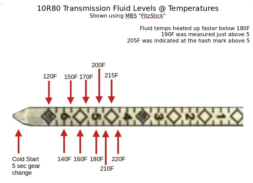

Check it using the cold method, you can easily see it then. Let your truck sit level over night, start it, run from Park to Sport and back at 5 second intervals, then immediately check the dipstick. Don't wait... check it immediately.
It should just show on the tip of the dipstick at 1/8". You're pushing the upper limit at 1/4". Tested to be accurate at 215F with fluid level on the diamond before 4 & 5. I ran the test at 75F ambient Air temp, Fluid was at 77.4F. Based on fluid temp expansion rates, you should be good from 65F - 85F ambient air temps.
This method only works with the MBS Dipstick (the "Fitzstick"). The Ford mini stick is too short.
