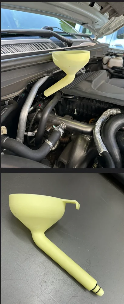

That funnel is really quit nice. It frees up your hands and is secured by the gasket at the top of the firewall. Sits perfectly horizontal and even has a O ring gasket at the towards the end of the tube.
It is very well designed. A lot of thought went into it. Kudos to the designer!
Picture borrowed from MBS Website

So I had the idea, the person who created it was Msfitoy, he did all the design work!
The only thing I have changed was the lip to hook on the cowl, I made it shorter, I had a few people snap off the tip of the funnel trying to hook it on the cowl, I should have included "slide funnel in the dipstick and over the cowl at the same time to avoid stressing the tip of the funnel"

Trying to imaging how the hook gets broken...it should just go over the rubber hood gasket to serve as a support to keep the funnel steady...

No, the tip snaps off when bending it to hook over the cowl when the tip is already in the dipstick.

I see...the proper way to install the dipstick would require the tip goes into dipstick while the guide is simultaneously lowered over the seal...

Operator Error! Install in a single motion, no need to bend anything.
