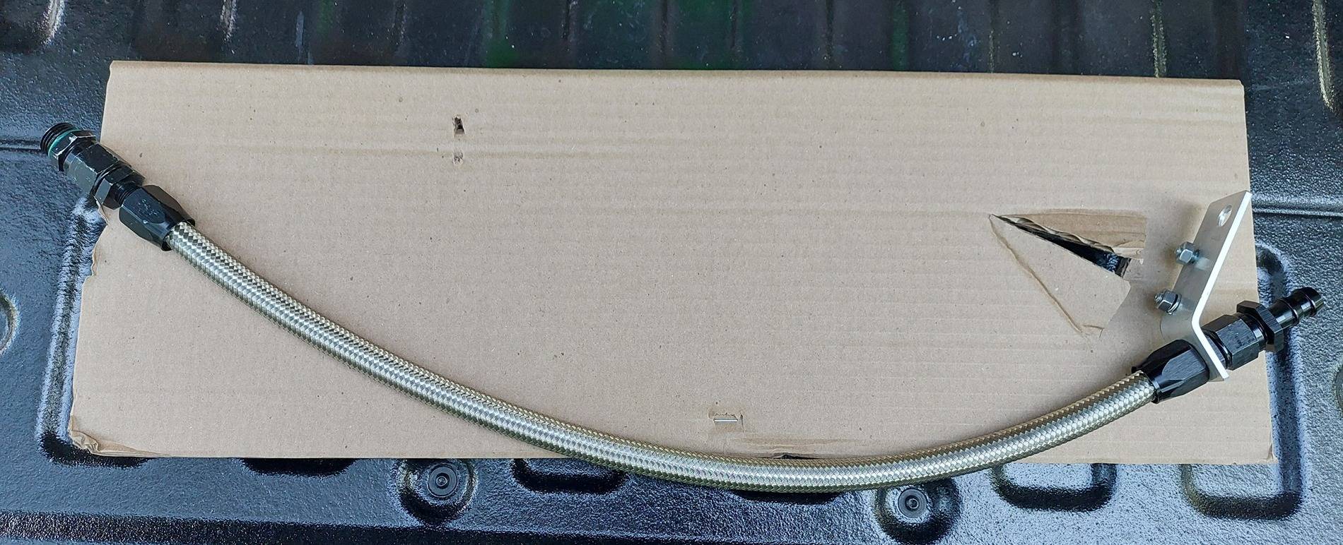

Here's the A3C dipstick tube. Pretty nice. You can see the 3rd hole on the mounting bracket for the wire you need to take off in order to use the A3C mount:

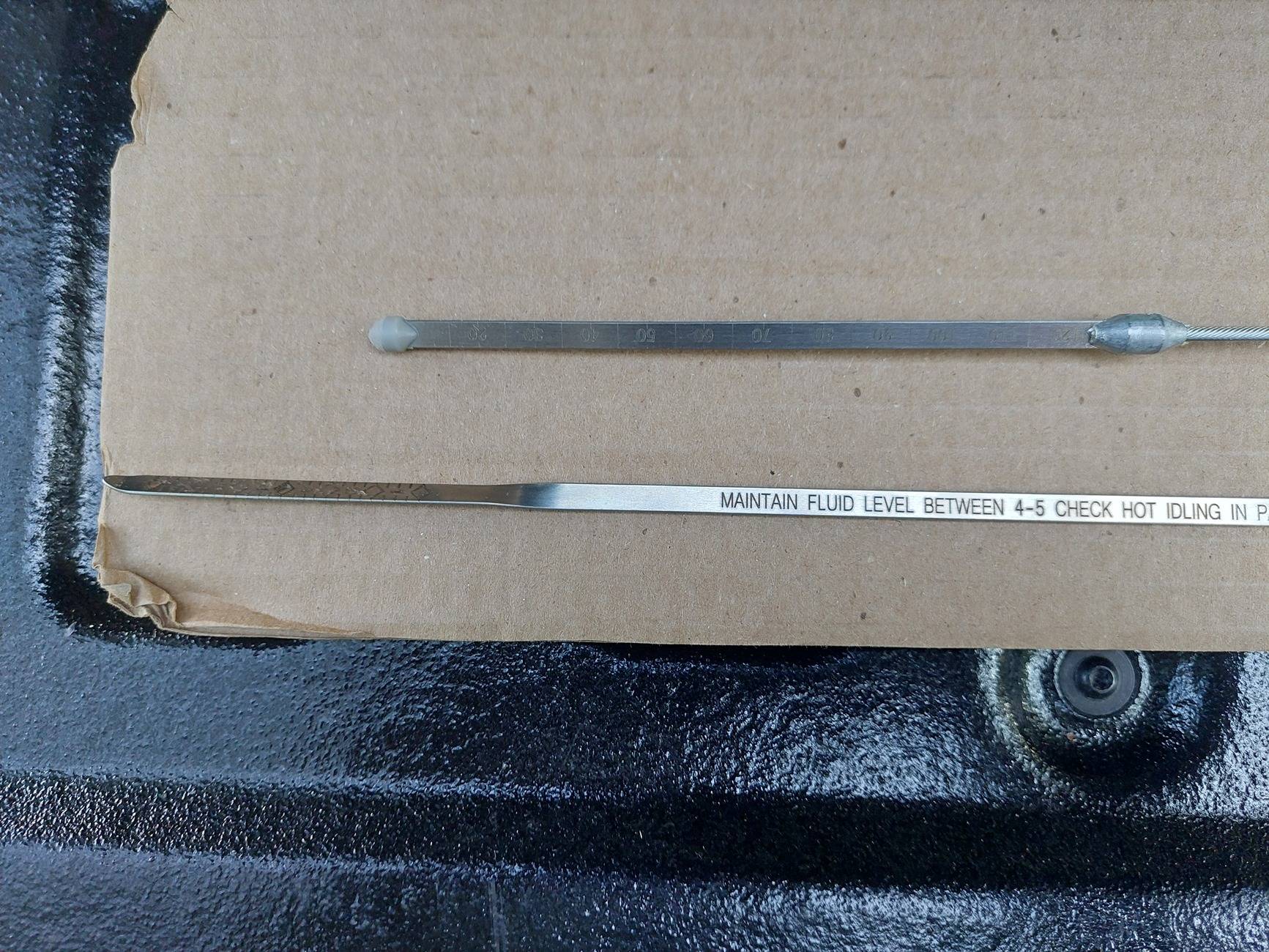

You'll see it up close in another photo, but note how short the A3C dipstick is (they're both positioned relative to where they would be fully seated in their mounts):

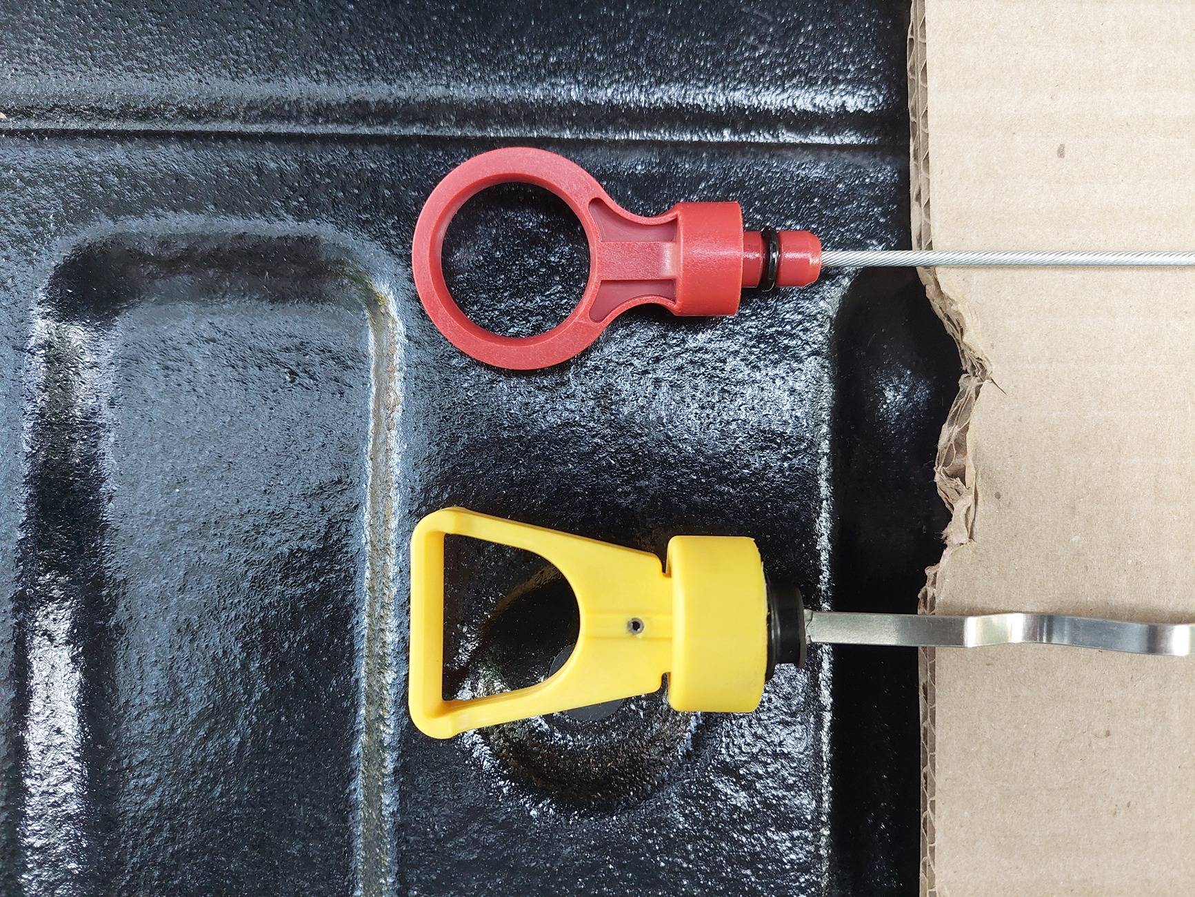

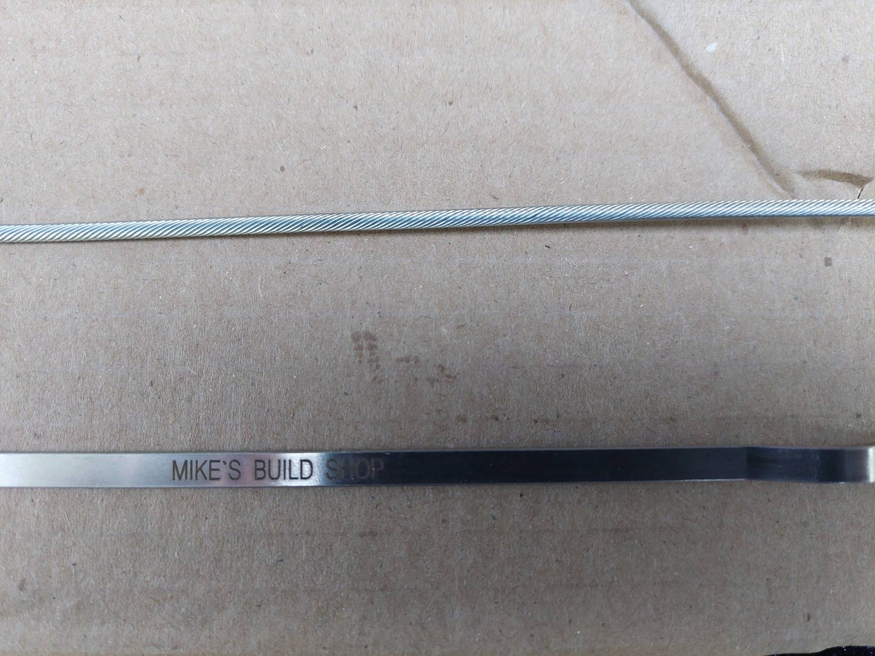

No markings on the A3C dipstick; an "old-school" trans stick marking/identifier on the MBS dipstick (to include a nice reminder to use ULV trans fluid):

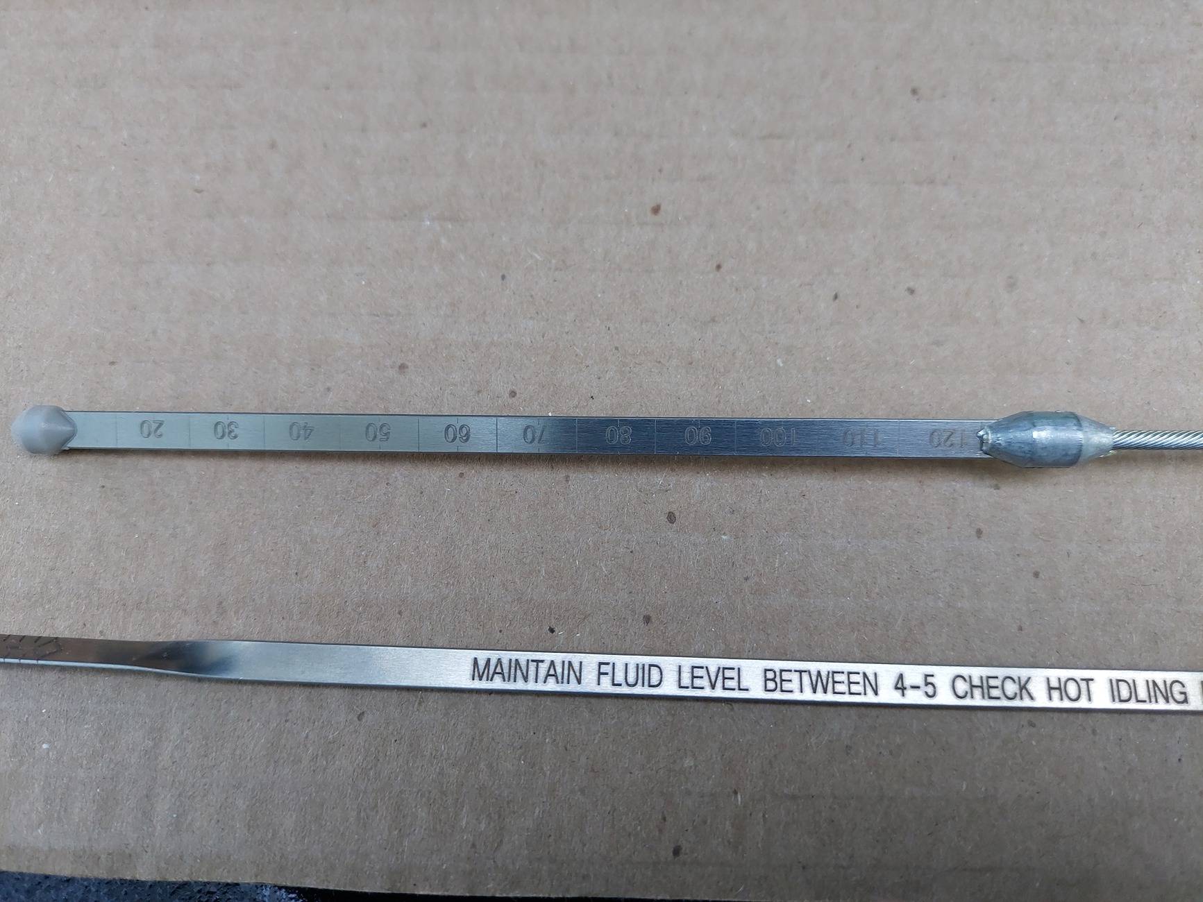

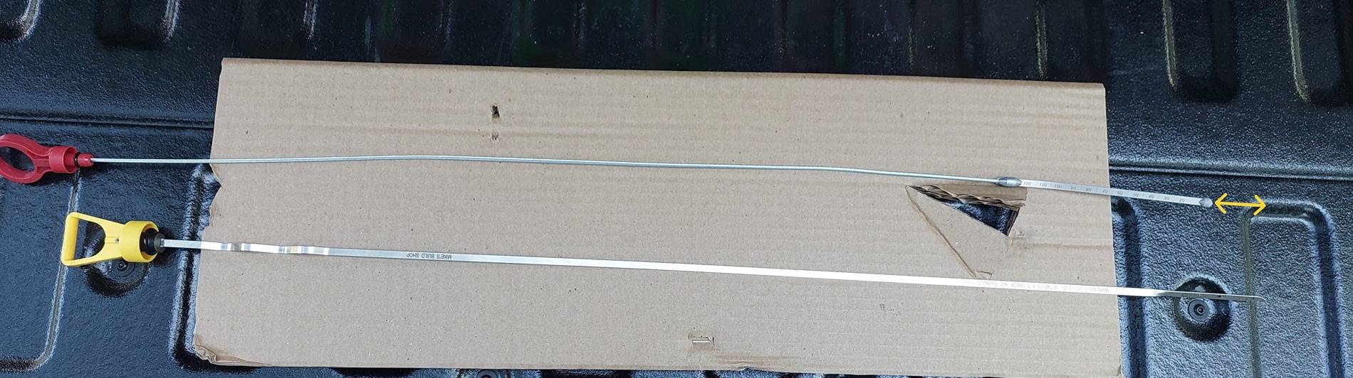

Here you can see the difference in lengths:

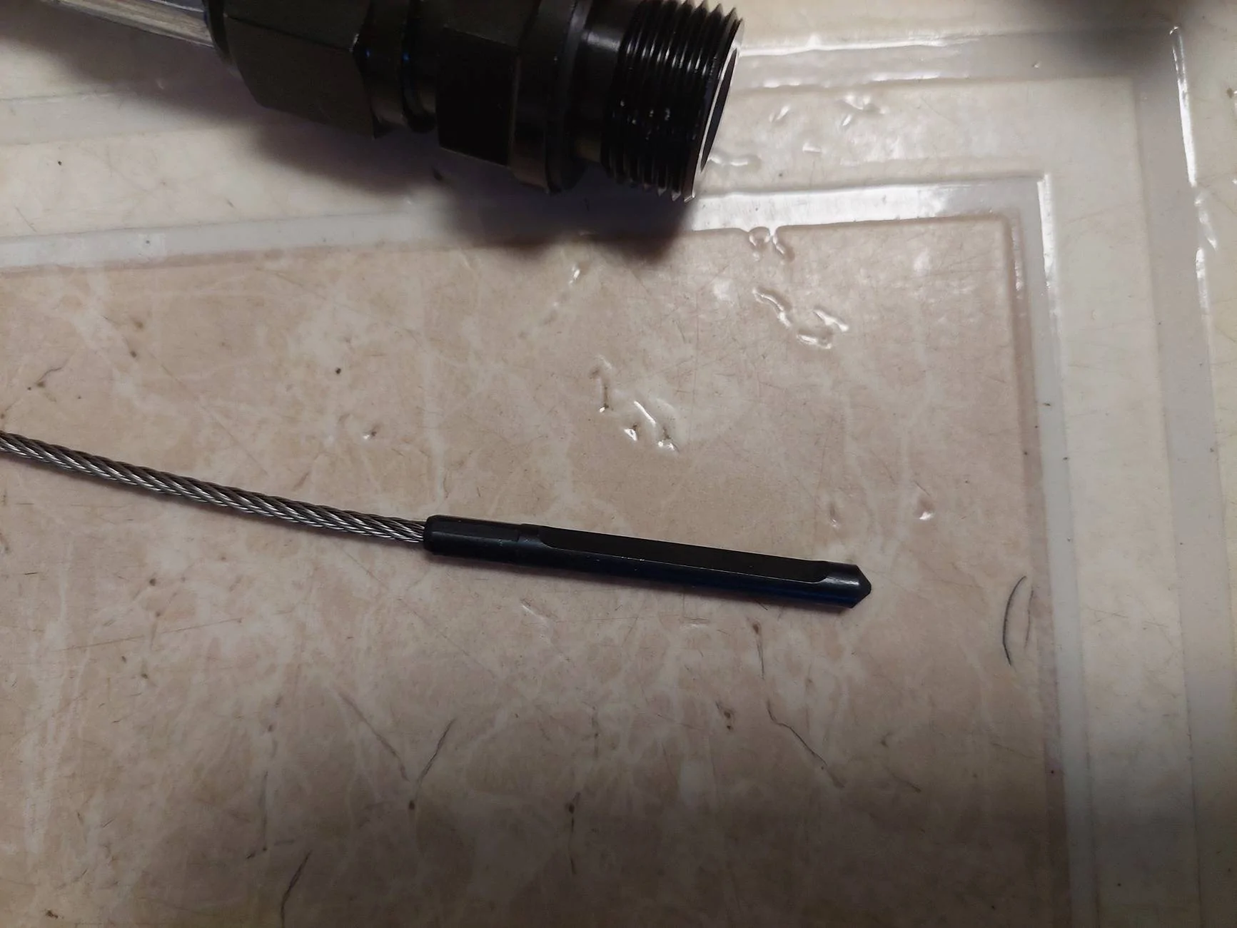

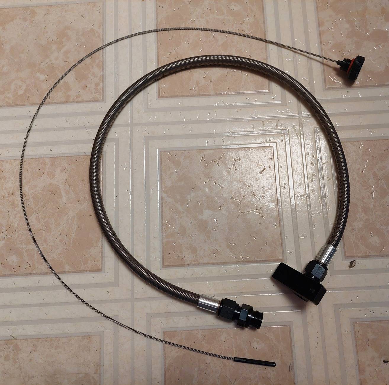

Here you can see that the A3C dipstick is actually a cable:

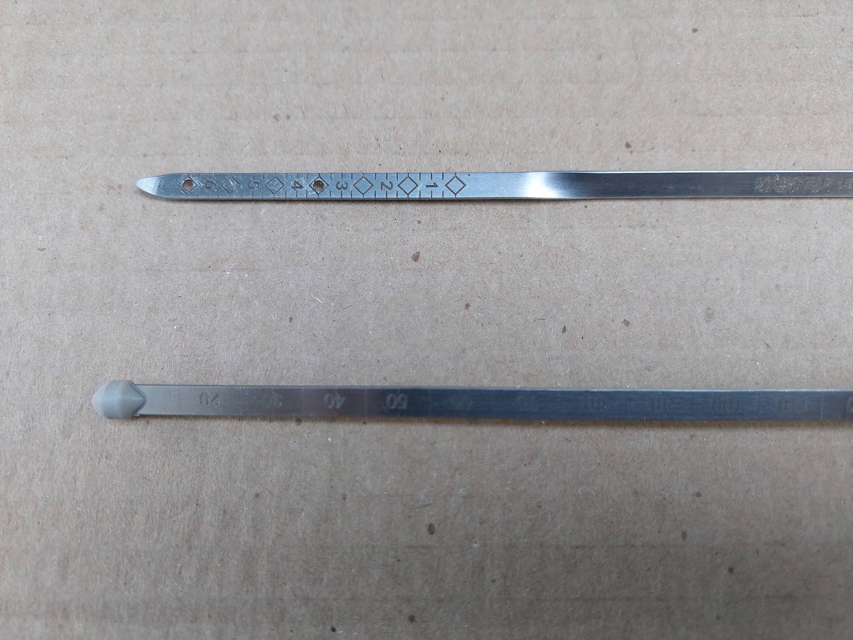

Here you can see the scales. The MBS stick mimics the Ford OEM nubby dipstick. The A3C doesn't and goes way up 2-3 times further up the dipstick than any reading you'd ever get in the 10R80. The A3C dipstick also counts backwards in comparison to the MBS or Ford numbering system; meaning, the bottom number is 20 going all the way up over 120 whereas the MBS starts at 6 and ends at 1:

For me the frustration with the A3C kit is the dipstick itself (which is the whole reason for buying the kit!).
As I mentioned, there is very little usable stick at the low end (meaning a cold measurement might not even show, while the hot measurement would only show at the lower third). Then there is the huge amount of markings that go way above where the trans case cap would be that are useless. So I'm getting measurement ticks where I don't need them and virtually no ticks where I do.
So, as much as I wanted to like the A3C kit it just doesn't do the job. So while I agree with @Fitzmotor's comment about price/affordability my "counter comment" is that any money spent is wasted money if the part doesn't do the job. Better to revert back to OEM and just do it with cap, nubby dipstick, burn protection, sweat, wrenches, and profanity than to be frustrated by the A3C kit.
